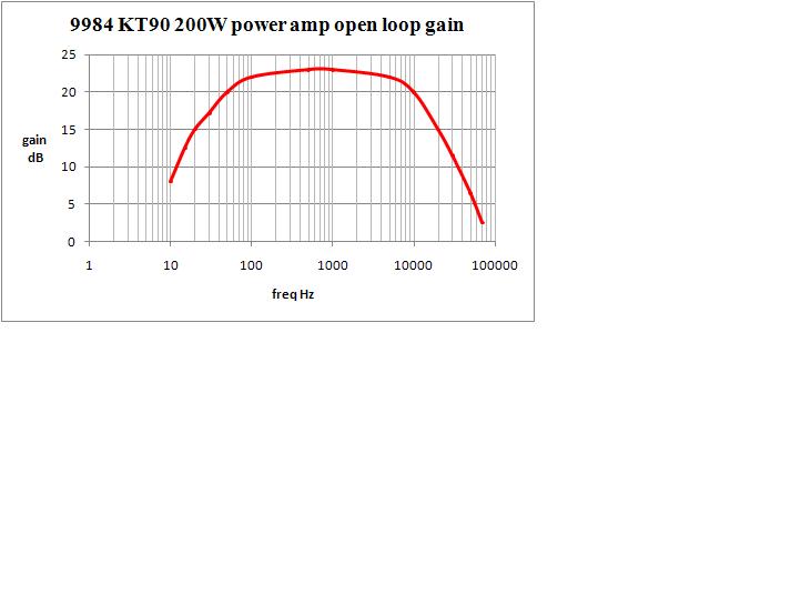

Don't forget the power supply.... 500V upwards for smoothing is awkward. Two large series electroytics takes up more space and placed avoiding the heat. Unless ABB stocks 600V electroytics.
One of the amp design problems I encounted going above 200W was the limitations of the E&I constructed output transformer become serious and the one I specified to the winder has 14 sections, same as my 150W versions but it behaves different. Bigger core, nearly x2 higher coupling capacitances between windings just ruins the top end performance and forcing the issue with higher tube B+ and quiescent current on a power test simply destroys the snubber caps & resistors. No-way will I use a 10W resistor for a nubber.
Disappointed, I returned to the E&I 150W lump, with parallel o/p paired tubes same A-A & UL specs and I get the results I am after.
Back to 200W lump see open loop gain pic. In this case, the driver and phasesplitter circuitry drooped at -3dB at 300Khz, way above audio b/w and 1st stage zobel trimming had to be slewed right down to suit the o/p transformer and bode plot. It didn't look good. Global nfb set around 22dB reduces thd around 0.25% at 1Khz rising to 1% at 10Khz due to the higher interwinding capacitances; one starts to run into o/p transformer response restrictions making hard work at 20Khz. The solution was to use a 150W tranny that can be pushed above 200W resulting in a 45Khz b/w giving 0.35% thd at 10Khz...(big reduction in interwinding capacitance compared to previous)... and into upper bass without overdriving the output tubes. As I do keyboard work with an octave shifter I also built in a HP filter, -3dB at 25Hz to avoid overload. OM decision. The LF end was better, designing the time constants and optimising the transient response gave 15dB global at 20Hz which was reasonable.
Parallel push pull windings are usually more generously rated for current than for single pairs and can be pushed that bit more..
In the end after alot of midnight oil, I found it notoriously hard to optimise the square wave response with a true 200W core only by hard slewing which consumes vital power, ruin sound definition and not worth using top notch tubes.
If you aren't critical about quality then it doesn't matter, but my amps end up in open air where they get heard.
It is quite possible that a Plitron toroidal may offer a better solution, but the improved bandwidth will create an excellent RF oscillator should instability result......More troubles.
Keep to a design that others have mentioned. For real !!

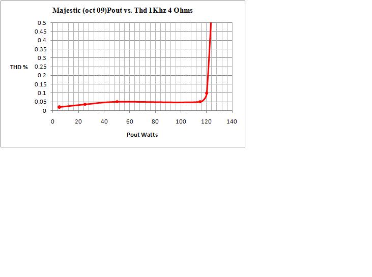

The Hashimoto KT88 THD looks disappointingly high. The F3 drop between 10-20W power level is curious and too high for an AB transition. It makes one suspect "thd vs frequency" isn't quite a smooth bath tub curve. I dread to think what THD is at 10Khz. An FFT spectrum ? I daren't look at it.... and that an ECC82 (poor linearity) used as a cathode coupled phasesplitter in a critical part of the circuit makes me shiver with the amount of thd with drive swing it has to produce. A 6SN7 would be the cherry.. why not ?
In comparison- the low THD from a HiFi Williamson design shines from the sky. An example of the smooth Williamson circuit distortion vs power, in pic. There is no hump; but there is a catch....theoretical skill. Find a well tried and tested Williamson Kit and it will sound good and exacting.
The Hashimoto has 13,5dB global and the Williamson 20dB using KT90's, hence 120W is obtained from KT88 circuits. Bear in mind, overload a Williamson and it can sound awful...but the Hashimoto with the global nfb ripped off would make a good guitar amp but I question the HiFi performance aspects.
The signal to noise ratio isn't given, but with this configuratin probably around -85dB down, i.e hard to notice hiss from a tweeter.
