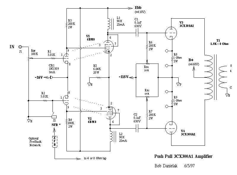

Hello everyone ...
Thanks to everyone who helps me in my search for tube amplifiers.
I'm close to have decided myself, I have looked at the various amplifier,
but always ends up with a schematic with too many lurking feedback loop🙁
so it ends with me looking at kit .... I like the kit from Bob Latino
I look for responds curves (square 1KHz & 10 KHz) but have only found
something from the little brother M120.
Picasa Web Albums - Arnold Matthews - Steps in buil...
Prototype 125 watt monoblock tube amplifier KIT - Page 3
# 35
Prototype 125 watt monoblock tube amplifier KIT - Page 7
#102
Does anyone have a kommentat for this amplifier?
I must emphasize that I am not for either expensive gold or silver cable
but a good general quality throughout. So when I look at the tube
amplifier is the same that apply again.
I would like to build Bob's amp, and fine trim it slightly (if possible),
with a slightly higher voltage to the output tubes and 2 x GZ33. But I
have some questions in this context, it is possible to parallel connecting
2 pcs. GZ33 if yes. should the chokes be replaced. I know the heater needs
5V 3A no problem🙂 and I've seen an amplifier that was drives with two
tubes in parallel, I just cannot remember where🙁
I would like to optimize it into to run with KT120 not so much that the
output transformer cannot keep up.
But what about the drives step? can it provide a voltage swing and which
is big enough? Is it possible to decrease the resistors which voltage
swings over? or it will run in current limit?
Well ... If there is positive mood for the amplifier, then it will be the
one I build.
The idea was to begin with the Original Plan. And hear it play here after
optimize (if possible).
I will start to change the solid state rectifier in to 2 X GZ33 instead.
I am aware that there is a higher voltage drop across the GZ33 tube than
solid state rectifier, again if I increase the B + voltage.
I would like if there is anyone which has knowledge of the M125 or any
ideas, or commentators, and especially on the basic structure of the M125,
then please say so. I have never heard the M125 play.
In advance thank you🙂
