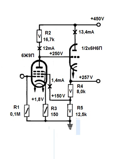

And what is a pentode behaving like?!...Sorry, cascodes are used there.
Different variants.
The cascodes would have a high impedance feedback point (top grid 1) for the R divider to drive, while the pentode screen grid draws non-linear current in most ordinary cases.
With the plate V and screen V related by a fixed ratio however, the screen current should be a fixed fraction of the plate current. So the R divider ratio will be off due to the screen current, but should still maintain a fixed ratio.

As the tubes warm up, the pentode plate resistor should pull the triode grid upwards until the pentode screen voltage (from triode cathode and R divider) comes up and stabilizes at the operating point. Tricky part is figuring how much current the screen grid will draw and hence affect the R divider. Probably will be some variation across different pentode tubes with varying screen alignment.
Most likely the scheme was considered in some research journal way back when (like 50s?) but got discarded for an unreliable operating point. But it does work well for low distortion, low Z out.
The scheme has also been used to DC stabilize a Concertina splitter driven by a pentode stage. A cap gets added to keep the audio signal out of the servo loop then.
Another extension could be to add a 3rd resister in the divider string, and connect the cathode of the pentode to it. That would stabilize the operating point. Could add a big cap across that bottom 3rd resistor to just work for the DC operating point. Getting complex to calculate out the R values. OOPs! I guess not! Wrong phase to servo control. Never mind this extension.

For stability, the grid current should be less by an order of magnitude of the current of the P-divider

A Mosfet makes good sense for the follower or top cascode for sure. No problem with that. But there are some who will scream when they see the schematic. Someone needs to come up with a schematic symbol for a Mosfet that looks like a tube.

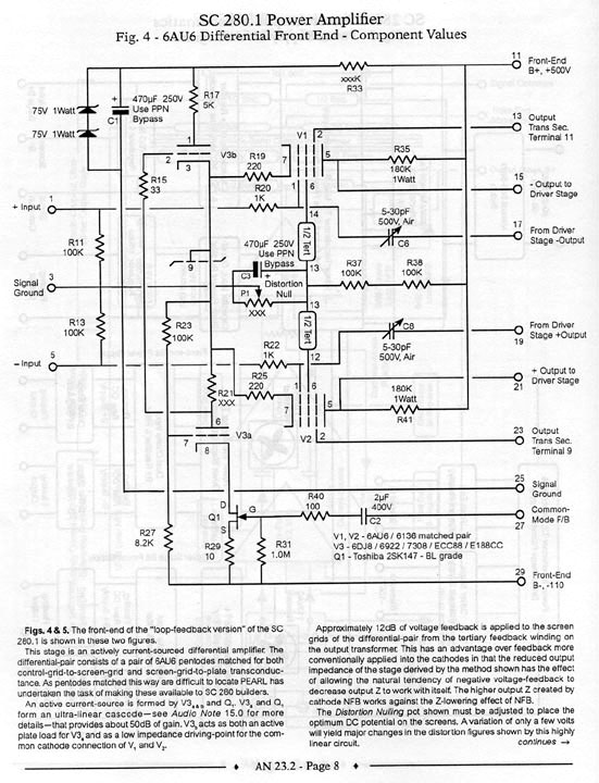

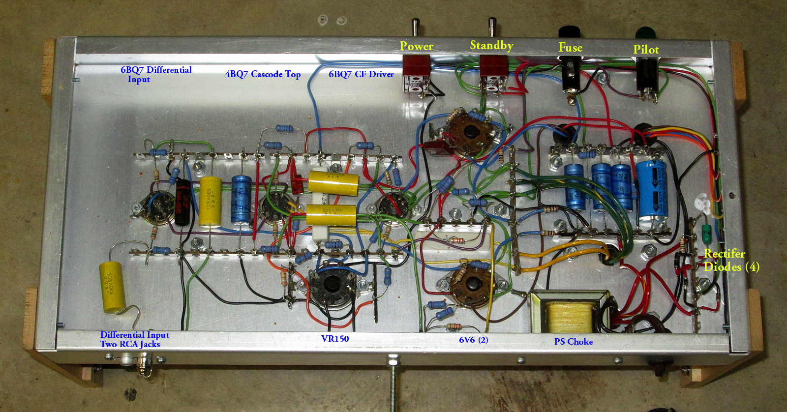

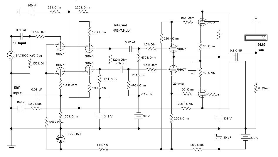

Here is my version of that kind of NFB. But instead of back to screens of a pentode pair I went all the way to a differential cascode pair. The NFB is to the upper grids of the cascode.
I got the idea from a visit to Bill Perkins of PEARL (Perkins Electro Acoustic Research Lab) in Calgary around 1992 during a sales trip there. Bill was using that kind of NFB to pentode screens in a few of his somewhat exotic amps.

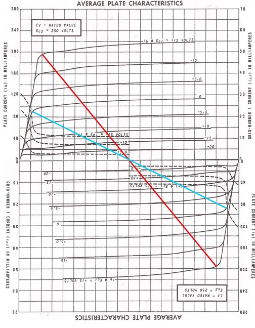

The cct stuck in the back of my mind until retirement. This project had three objectives in mind, PP 6V6s in Class AB2 with a corrected loadline, NFB to a Cascode Pair & how is the transient response effected by a limited PS.

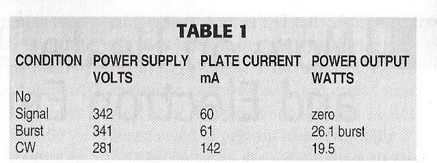

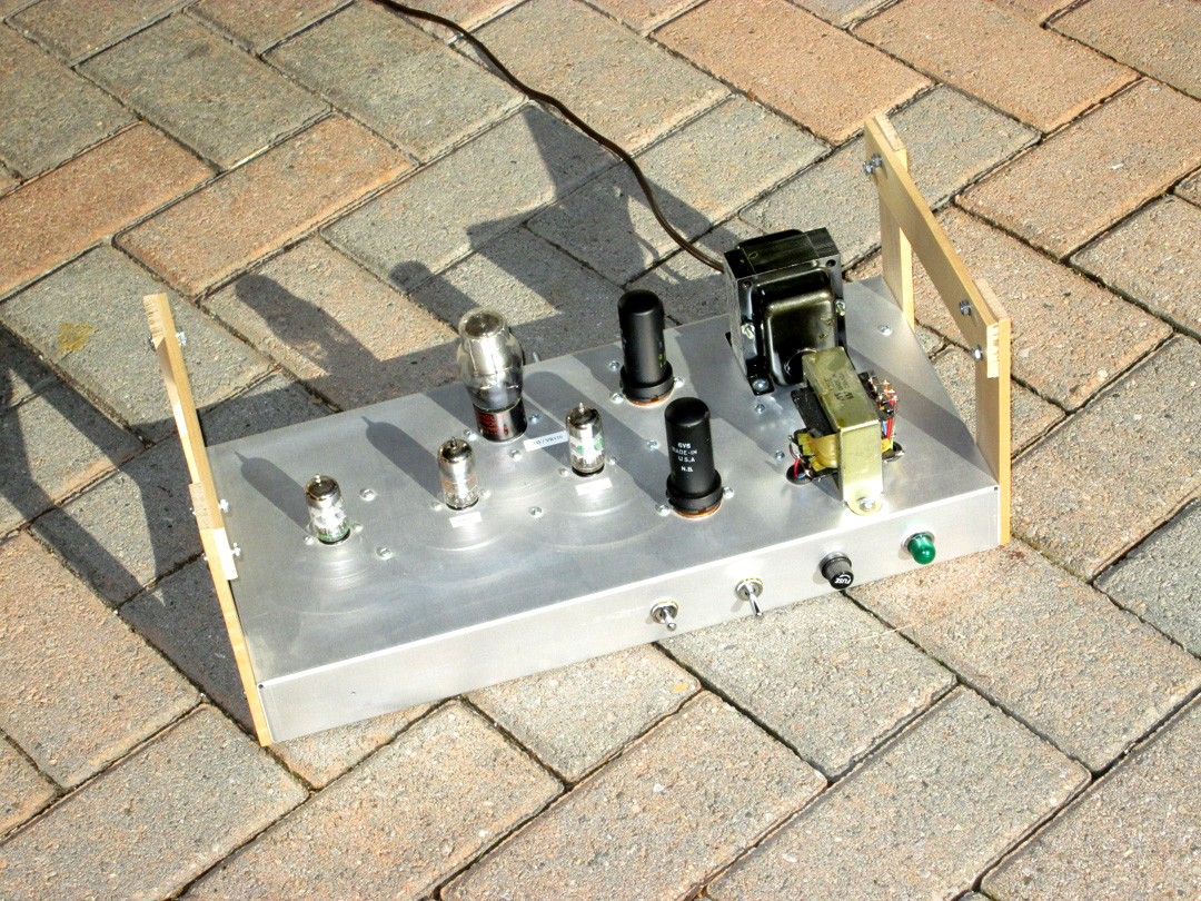

I got going in early 2013. So without digging out the complete test results this thing manages 27 real watts running from a regulated PS, quite a bit less on its own. And looks like the resulting NFB in this case is 7.8 db.🙂
That 2013 date was when I formalized the info on the cascode front end PP Class AB2 amp. It was built & running in 2001 but never got to the point of an article for publication.

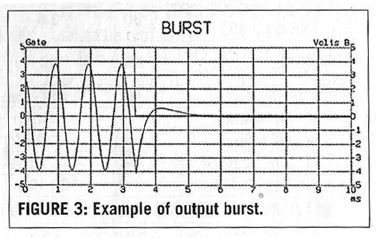

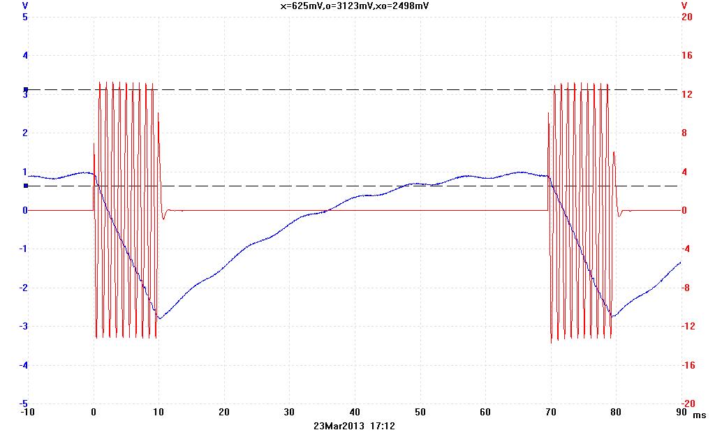

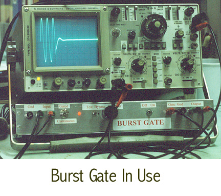

Not long after in 2002 I did a piece on an analogue burst gate.
I couldn't afford a General Radio 1396A. The PP 6V6 amp was used as the test object to get results for the article.
Here is some of the original information used in that piece, finally published in AudioXpress, Nov 2003.
