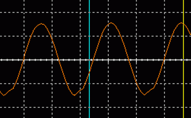

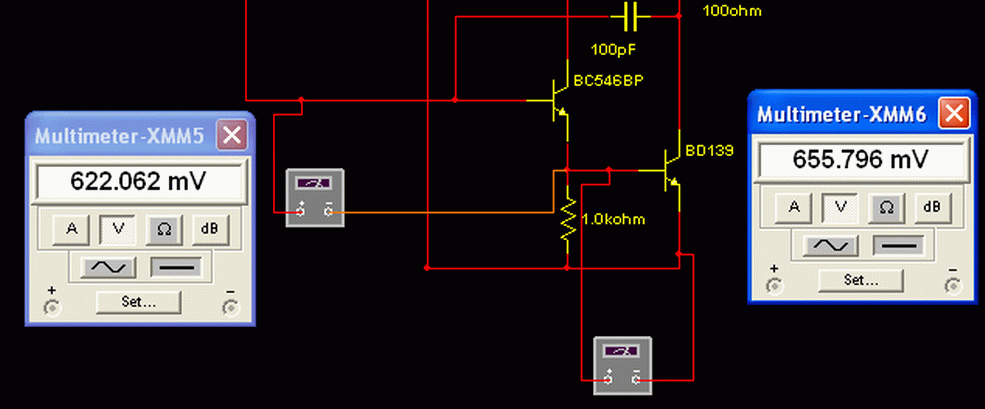

I am watching the blameless VAS into the simulator, i found something strange.
The first cicle distortion..when simulations start it distorts during some cicles and the distortion disappears.
I made it work with global feedback and without it..using my Dx amplifier as a model
The differential emitter resistances were replaced to work together an emitter follower i found in ULD or in some schematic from Dr. Self book.
I had to change the original 2K resistance to allow better Vbe "distribution"..let's say this way...one VBE was small and the second was too much big...now more ballanced, they are not the same but the difference was reduced...the first one was near to be cutted and the second was more to the saturation side.
I found that distortion using the standard resistance, also using the modified one..using BC546 and BC546.... using BC546 as the first one and BD139 as the second one and using both beeing BD139...... the voltage was adjusted, from the differential colector, to match the 1.3 volts need...also i have tried a CCS there, the current sink..... i could not avoid the distortion.... inserting global feedback and removing it in the style used into the ULD.
I am interested into this stage..... maybe the one has some responsability into the strange sonics i have perceived.
I am still into the simulators...but i will do all those testing into my prototype to listen the results in the real world.
I am extremelly curious about that..... i just cannot believe what my ears told me monthes ago when i have listened that blameless.... and there are something into ULD that remembers me deeply the blameless..... something must be the one to blame to make the blameless...less elected, at least by me, to receive some blame.
I will try each blameless circuit separated....one each time...will apply it into the dx amplifier as "a very basic thing to start".... and i will listen into sonics, to see if some stage is responsible related the "effect"..observe that i am avoiding the name defect , that i could listen.
Yes.....maybe all them together produces that...well.... this i will conclude easy after my tries.
If i concluded some stage, i will open my big mouth to inform to finish with this chapter in my life...but if they together, all them together, all the blameless stages produces....well...i will be silent not to continue to bother the Blameless lovers...also not to bother Self, as he is also an inspiration to me.

I am using the Dx amplifier as i know how it sounds
So... increasings of sonics or even decreasings, because of this stage, will be fast perceived.
I have another "very secret" modification a friend have sent me...and another 2 ideas, one from ULD and other from Doctor Self....i want to try all them...first into the simulator, and than i will put them to sound.
If doubts...i will call friends to make a session of A to B blind using friends to judge, also my daugther and some other small children that lives in this same building i am..... hard to fool children.
The Vas circuit is shown in one of the pictures attached... the emitter follower.

Your simuations you have been referring have been with the Dx circuit?
And also trying to implement some D.S. ideas into the Dx amp?
I'am just trying to understand the distortion problem...

I am trying to find the "strange" sonics reasons...maybe i am lost related the track
This distortion may not produce that sound i have heard.
This distortion may produce stronger and clear result into sound reproduction, more easy to perceive.
I am searching, i continue searching into the computer, now i have Graham cooperation.. he will be over my shoulders into this research.
He has things to be confirmed, i have things to be tested...and i hope, we can succeed.
DS standard VAS do not produce distortions, at least not this one i have shown...but also, it sounds nice and good...but not that incredible high end so... the original and old circuit.
I do not think i am hardly off topic...as there are similarities between the focused amplifier in this thread and blameless.... and VAS is beeing inspectioned.
The one that opened this thread, please, feeling bothered, just tell me and i will open another one about VAS only.
regards Allan

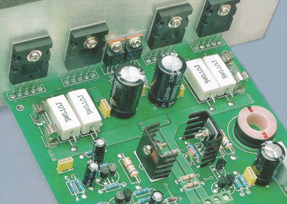

yes there are similarities between the ULD and the Blameless IMHO
but there are differences to
ULD is CFP output, different VAS, different current regulator.
actually it has properties from the D.S. trimodal amp too.
and if i go thoughter through D.S's books i'll probably find a few more.
But SC have implemented D.S's ideas well IMHO
and the amp works well.
SC circuit board layout is well thoughout too.
Isn't D.Self trying to give his ideas on how to make an amp and what he has found in the presuite of low distortion.
allan

http://www.siliconchip.com.au/cms/A_110797/article.html
They have posted the cct in the public domain so looking at it shouldn't be any Copyright issue ???
SC ULD2
Silicon Chip also made some revisions to the circuit to avoid blowing the 5A fuses, and also another change to increase bias,
so probably not a good idea to work off this schematic for construction purposes.
SandyK
SandyK
It's an updated D.Self design using integrated diode temperature compensation (but badly due to insufficient understanding of the temp comp/coef required).andrew01 said:I see SC have published a updated version of UltraLD now rated a bit higher in terms of power and using the newer thermaltrak transistors with inbuilt diodes............
Except, they have disregarded the ClassAB bias distortion recommendation and gone to needless high bias ClassAB.
edit;
something does not add up.
The schematic shows 70mV to 100mV across each output emitter resistor.
The biasing of the output stage shows 2.2V across the drivers+outputs+emitter resistors.
That implies 550mV across each diode (believable)
and 500mV to 515mVbe across all the output transistor base/emitter. (that seems unbelievable).
What's are they not telling us?

Carlos,
I just knocked it up in Ltspice and same results. Biggest
problem seems to stem from the cfp OP stage. Also the driver has
too low bias current.
Into 20kHz / 4ohms the performance is not so good.
I substituted a triple darlington OP stage, used some HQ jap bjts in
the voltage stage, dropped the miller C to 33p, dropped the IP pair
degen to 20 ohms per leg.
Much better.
More later.
cheers
Terry
