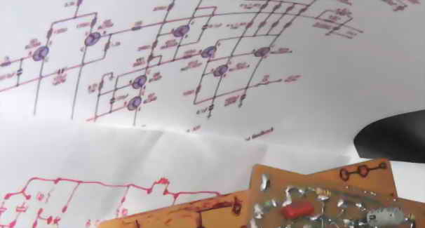

Ultra LD 100W
Andrew (and Carlos)
The auditioned amplifier was based loosely on the SC ULD. It had a CFP VAS as well as 30,000uF capacitance per rail, PLUS
several other tweaks, including well matched 2SA970 differential pair (HFE and VBE) and well matched current mirror devices with HFE >800.The original SC ULD also used a separate front end regulated supply. It is not a DS clone, although the new SC 20W Class A admits to implementing some of his findings. My friend hopes to fit his own regulated supply for the frontend this weekend, so performance should be further enhanced.
I hope this is enough for now ?
SandyK
I have lost the interest, as i finally perceive that is another blameless design
Well...i have already made this one twice.... and into testings and comparisons did not made me happy...the opposite.
As i want to be happy and not to modify Blameless designs or something alike....or that even remembers me that design.... i gave up related this one.
My boards, and dat,a gone to the deposit of things that do not makes me motivated.
Sounded fine in some aspects..but sligtly modified...the next board would be hardly modified...not needed, by me, to construct BlameleX
This problem belongs do Doctor Self....his problem..not mine.
I will listen the SAE..for curiosity, to check once more, that complicated designs normally do not sound so good as we imagine.
My material is in the "less motivating things deposit"
Will not test this one anymore...be happy with it folks
regards,
Carlos

Carlos et all,
As the owner of the forementioned and highly modified 100W ULD AB amplifier, I have decided that it's now appropriate for me to provide some input. Firstly, I agree with the assessment that the ULD along with my own interpretation are clearly derivatives of the Doug Self blameless amp design. The design of this power amplifier was only undertaken following the successfull development of a ULD class A preamplifier which shares a very similar design. I originally built the preamp as a scaled down version of the SC 15W class A power amplifier published by Silicon Chip. I deemed this to be a very clean and detailed sounding amplifier but also very cool and clinical. I believe that this is the general impression of this design. My modifications of this basic design were done purely to achieve a sweeter treble that was free of grain and the slightly metalic edge that defined the original. During the course of the development, my reference preamps have been a Krell KSP-7B and a musical fidelity A3cr, which are both highly acklaimed preamps. Without going through the very long winded storey of development, the modded preamp relies very heavily on component selections, and this relates particularly to the input and VAS stages. The completed product easily outperforms (sonically) both reference preamps in all areas. I did not attempt to measure the THD until some time after the project was 'closed' but was not surprised to find that IMD and THD were both below normal measurable limits. Measued at 7.1KHz into 600 ohms at full output the preamp returned a THD of <0.0002%. It may then come as a surprise to some that very low THD and excellent subjective performance can and do co-exist with this design. I should also point out that every person I have demo'd this to has arrived at the same conclusion
The similarly designed power amplifier is still in the development phase but already the results are very very encouraging. I will presemt a schematic of these full mods but only when I deem the project to be finalised.
I also welcome any ctitical appraisals and comments no matter how negative. If you call me a Pajero I'm not offended.

It depends on what type of sound you are looking for with an amp or any piece of audio equipment.
Usually when i build an amp i put a scope on the output and test the signal across 4ohm and/or 8ohm dummy loads.
If there is any distorted signal i would investigate further.
Especially before i connect speakers to it.
(speakers don't like nasty signals it does horrorable things to them:xeye: ).
the SC 15watt amp and now resusected ULD-100w amps didn't show any distorted signals 1Khz to over 10Khz that i could see.
The 15watt has been upgraded years ago (mainly power supply) and it still hasn't blown up yet.
The ULD-100w has just been reserrected hopfully for future mods.
The reason i put the ULD-100 away was the sound.
It was very accurate and detailed but was felt dry,,,, ie "VHF man"
"I deemed this to be a very clean and detailed sounding amplifier but also very cool and clinical."
Good description VHF man
This is not and amp with distortion, if anything it may do with some 2nd and 3rd harmonics to warm the sound.
Being very accurate it does show the good and bad in recorded music material and my system equipment.
sometimes for better or worse.
If you are looking for an amp thats lively and colourful this may not be the amp for you.
If your looking for an amp that just amplifies what it's given then that is what this amp does.

I suspect that we should be doing a lot more research into improving the power supplies that feed these "Blameless" Amplifiers (and others) My modded SC 15W Class A already had a great soundstage, detail and dynamics. Supplying the front end via a JLH very low Z, and very low noise PSU addon, instead of dual regulated supplies for the whole amplifier, improved virtually everything. INCLUDING a warmer , more natural sound.
I believe that the practice of inserting a series 10R/1,000uF in the -VE supply rail to the front end, fixes one problem, but then the varying impedance (and phase ?) over the spectrum alters tonal balance by a very small, but audible amount. IMHO, front ends are best supplied by very low impedance to >100KHZ, low noise supplies. Ordinary 3 terminal VREGs are not really up to this task.
