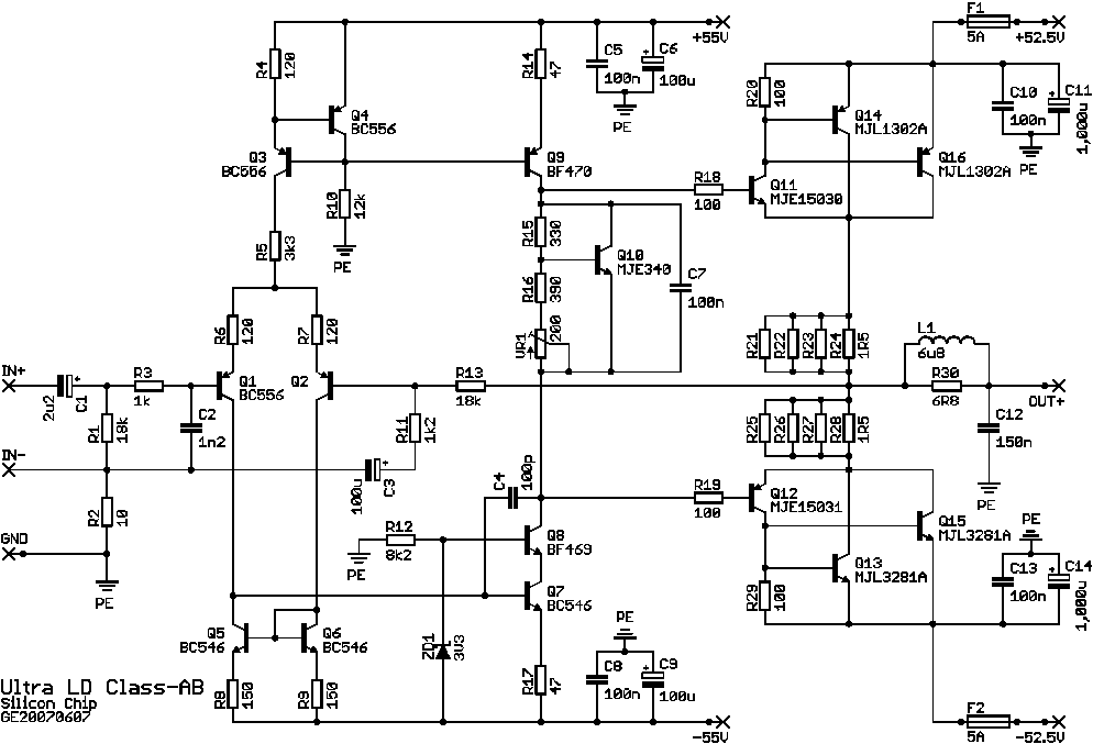

This looks like a Doug Self schematic with the option to replace the follower with a cascode to help the VAS that he shows in his published designs.
The frequency extremes could both do with about one octave wider bandwidth.
I don't like Self's use of LTP mirror and Miller comp cap (Cdom) that dominate all his designs.

Here is the schematic of the Silicon Chip Ultra Low Distortion class AB amp. (SCULD class AB). I hope this makes the thread a little more meaningful. 😀
Only last Saturday I had an audition of a highly modified version of this amp and was impressed to say the least. So, I not sure what the standard ones sounds like, but I can say if you know what you are doing you can get one of these to really sing.

I am studying and producing my own modifications into the simulator
Depending on the simulator results....awfull the original into my simulator..this one modified is a little better...but not good.
I will continue to study this one.
Maybe it will turn the next Dx amplifier... maybe i said...i have to study for weeks into the simulator and ask a lot of friends about.
Also i will ask Graham to evaluate and to simulate it.
I will ask Michael Bittner and Hugh Dean too.
And then...maybe...not sure...if positive results of conversations, maybe a prototype....... if the prototype sound fine after tweakings it is possible that i will open a thread about.
For a while.... only to give a shot on it!
The original was already smashed, destroyed and it is in the garbage can (the box may be offended!)... the original Miller modified capacitor of 100 picofarads are triangulating the wave form after 60 kilohertz!!!!!....the enormous output filter were eating the high frequencies.... the zobel loading the amplifier...and low frequency drop was enormous...people may be kidding to publish those things!...not you Qev!....the magazine!
This complicated thing is simulating worst...many times worst than the simple and cheap Dx amplifier.

The amplifier that Greg heard only has a passing resemblance to the original published design . The original design's HF response was deliberately rolled off to ensure repeatibility, without susceptibility to EMI. I raised this issue with the magazine. The original was NOT a bad sounding amplifier. I don't feel that it is helpful to rubbish the original design, or publicly attack the design's perceived shortcomings. Have you seen the full specifications of the original design , and the rest of the published article ?
I have heard Destroyer X AND the modified design that Greg refers to, but in fairness to everyone concerned, I decided not to post my findings in a forum with public access. Also , I did not want to place Greg in an untenable position.

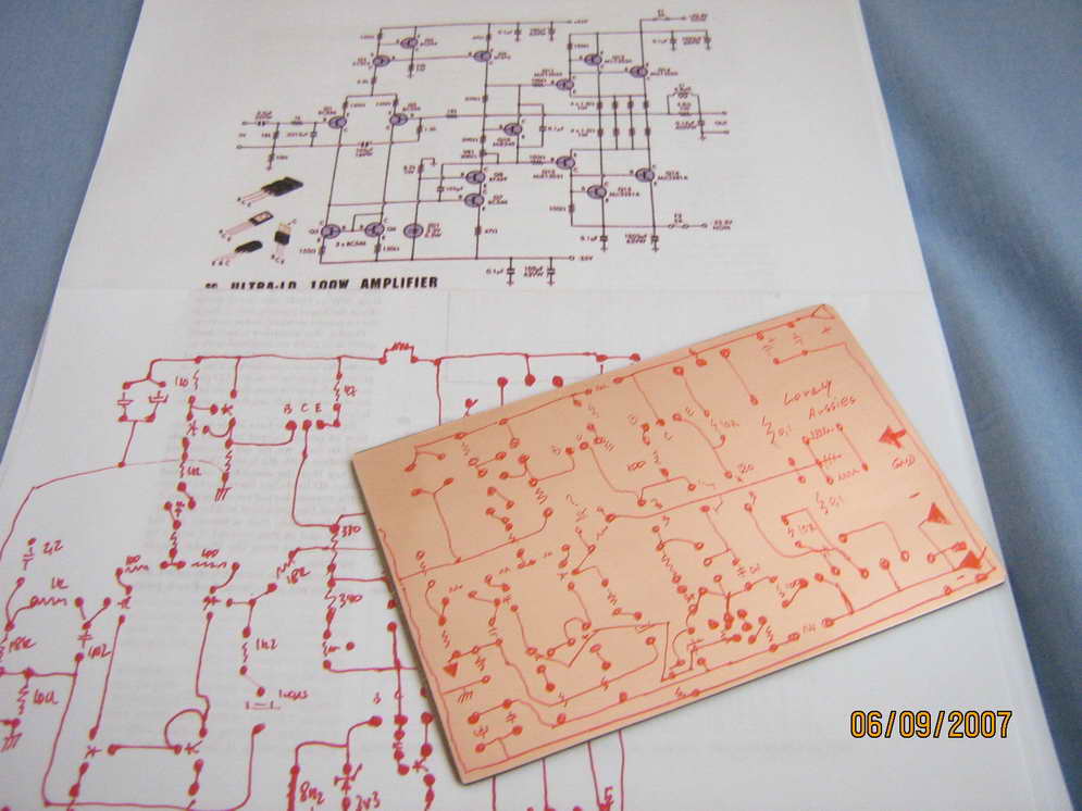

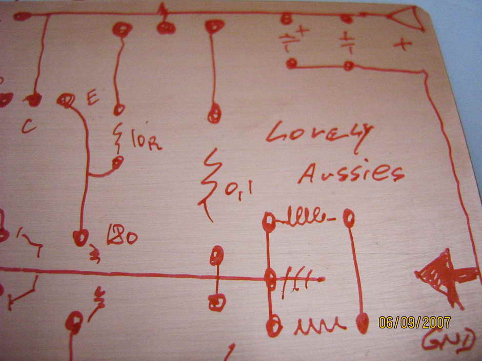

I have made an spide assembly...will not show that awfull thing
The amplifier sounded excelent....beated my Dx amplifier.
And i will start to tweak it.
Was designed to be stable, not to produce problem to constructors.
They had that care.
It promisses to be excelent...i will see that soon.
When more pretty construction was finished..i will show you..relax!

I will delay a little to finally listen my modified version.
Modified to accept lower loads impedance only..the output is different.
I am also doing the SAE.....so...i am a little busy finishing other 3 Dx boards.
Maybe i will delay....the original schematic is ready and sounding onto spider construction.... sounds fine..... i will see my modified version if can sound fine or not.
Maybe i will delay a couple of days because i will have to go to Movies and Shopping with my girls...maybe Sunday nigth or monday i will be able to show you some better image.
Will not say any bad points....only the qualities...this way is better...as bad points can be design decisions thinking in reliability, stability...those things needed when a lot of dummies, alike me, will construct their schematics.
