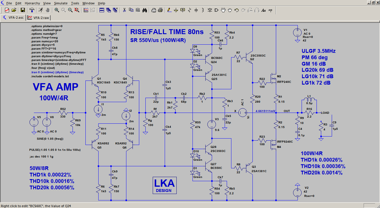

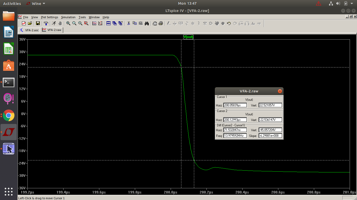

1.5pF? I don't see this as Cherry compensation.
they go from output to the VAS input.
how would you call them ?

no, just simulation

And here you agreed, Ck3 is a Cherry cap.

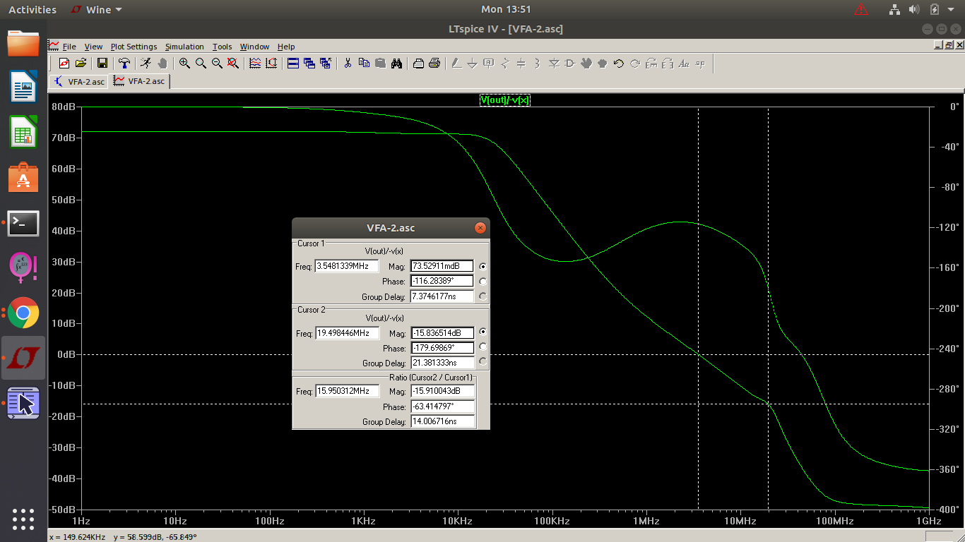

I did not notice that it has so small value, does it really play any important compensation role, you can have stray capacitance of similar value?
Ck3 and Ck4 improve phase margin. If they have higher capacity and IPS cannot supply more current (2mA divided among 1p5 and VAS input) SR is degraded.
One solution is to double IPS CCS current or/and use floating JFET IPS which can go beyond tail current.
OK that's VFA, but why you used same value Cherry caps in CFA?

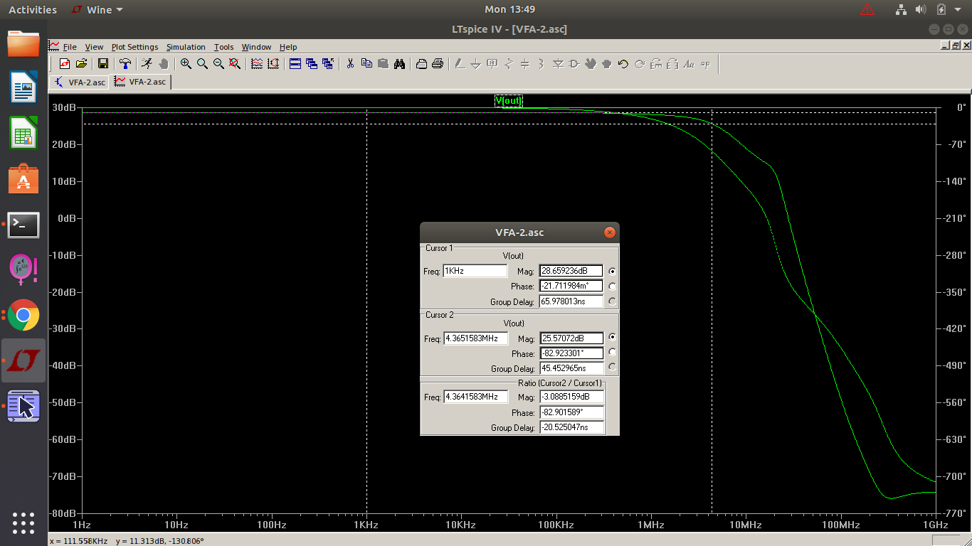

Because is optimal when considering ULGF,GM,PM. (at given TMIC+SHUNT compensation)

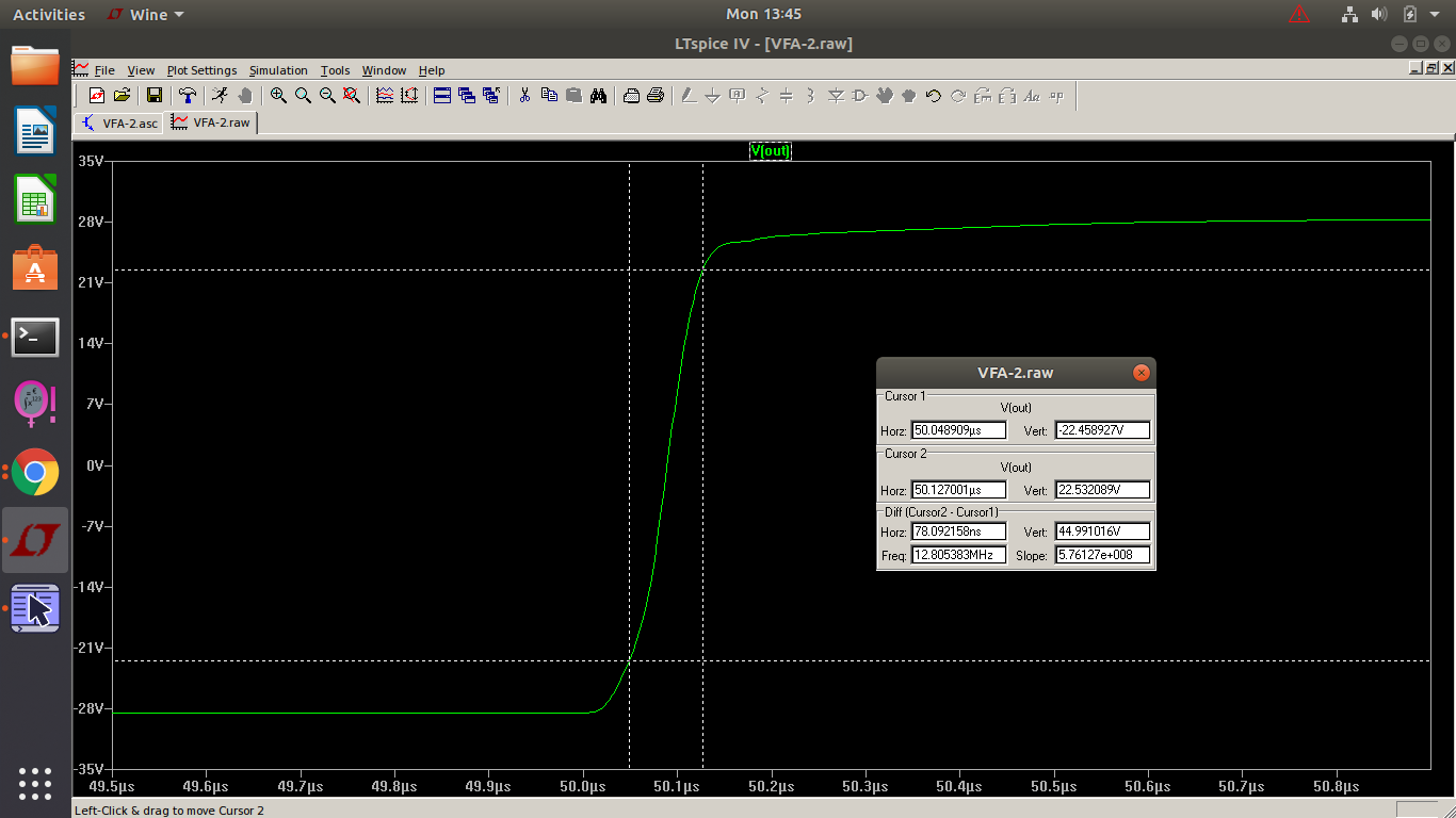

When Ck3 goes UP, PM and ULGF go UP, GM goes DOWN.
It has much less impact on SR comparing to VFA.

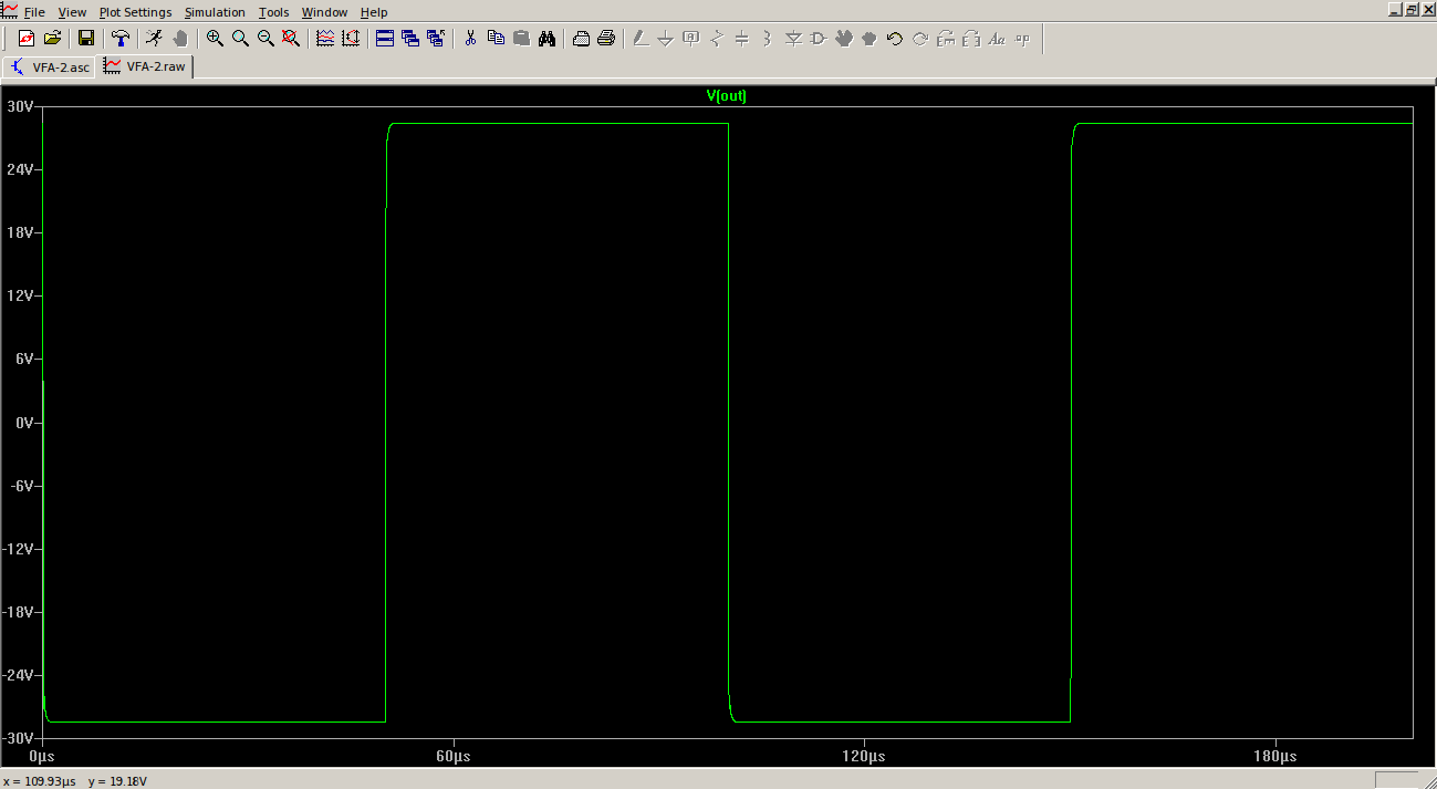

I had to slow this down to 600v / us for stability. one of Valery's designs

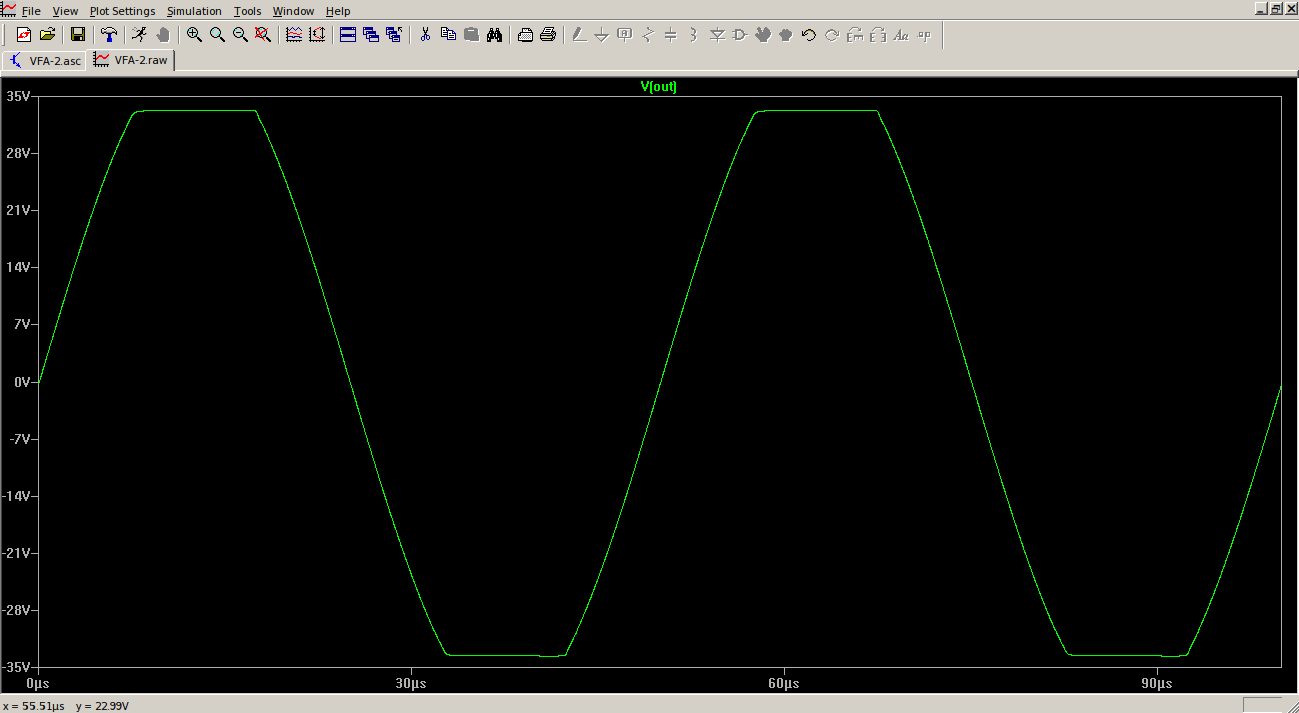

3.6mA driving current and TO92 devices. enough for sine20k 30Vp, not 600V/us.
above sine100k 30Vp significant cross conduction
KSA1381 , KSC3503 are a bit slower and shift the phase. 3.6mA is the driver idle current
both can peak around 200mA. you are correct with TO-92 devices sustained 500khz full swing drive will cause them to melt. The 0.1uf cap and 3906 bias transistor prevent cross conduction.

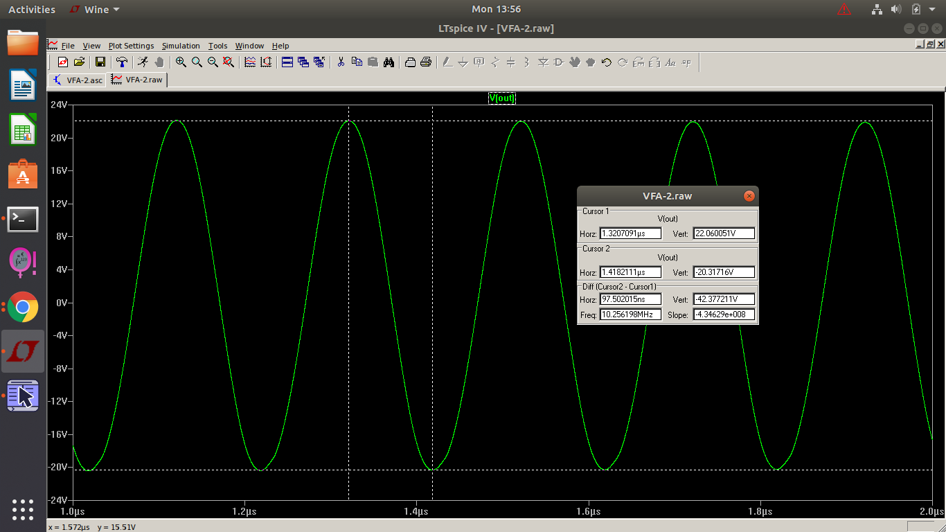

with the 22pf caps removed, this circuit will drive 2.2k to 40v p-p at 20mhz.

This is TMC compensation, i believe. I saw Bob Cordell use it in his simulation somewhere in this forum.
I design symmetry topology amplifier using this compensation. A friend made the PCB layout and built the prototype. It worked. He said, sound quality is very good.
it's TMIC (Transitional Miller Input Compensation)

I see. The connection is the inverting input, not base of the VAS.
- Ultra high speed VFA 500V/us
