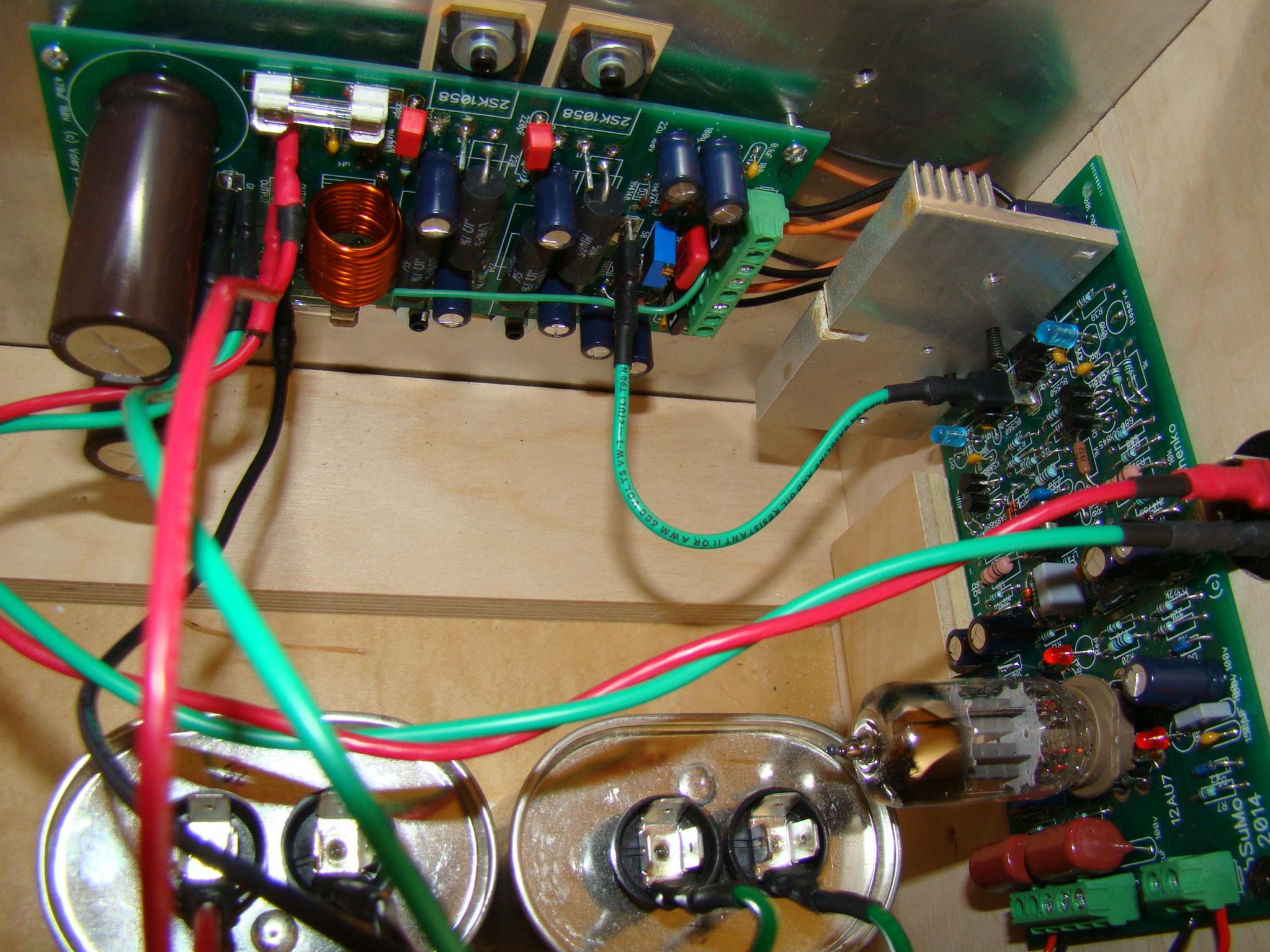

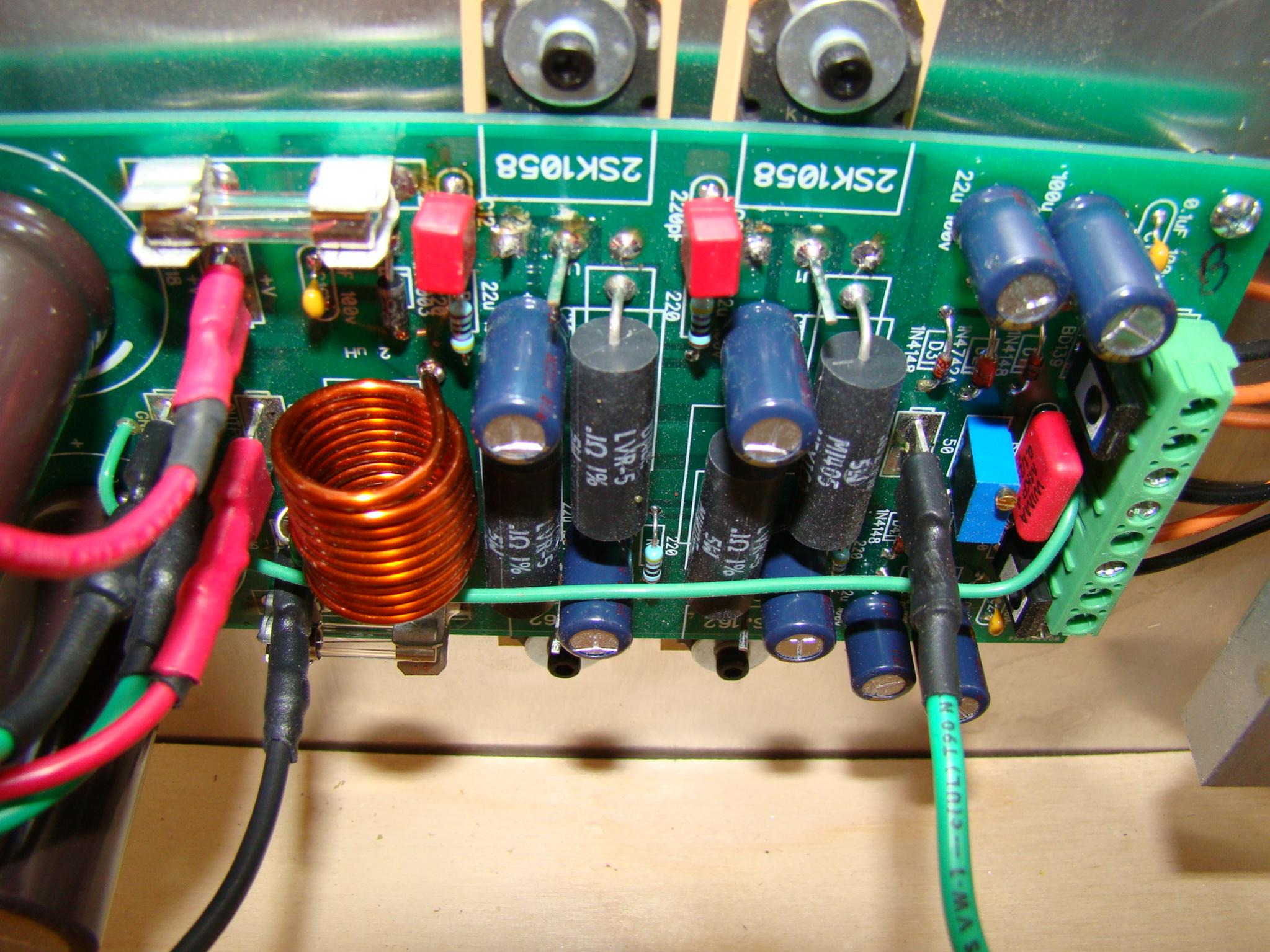

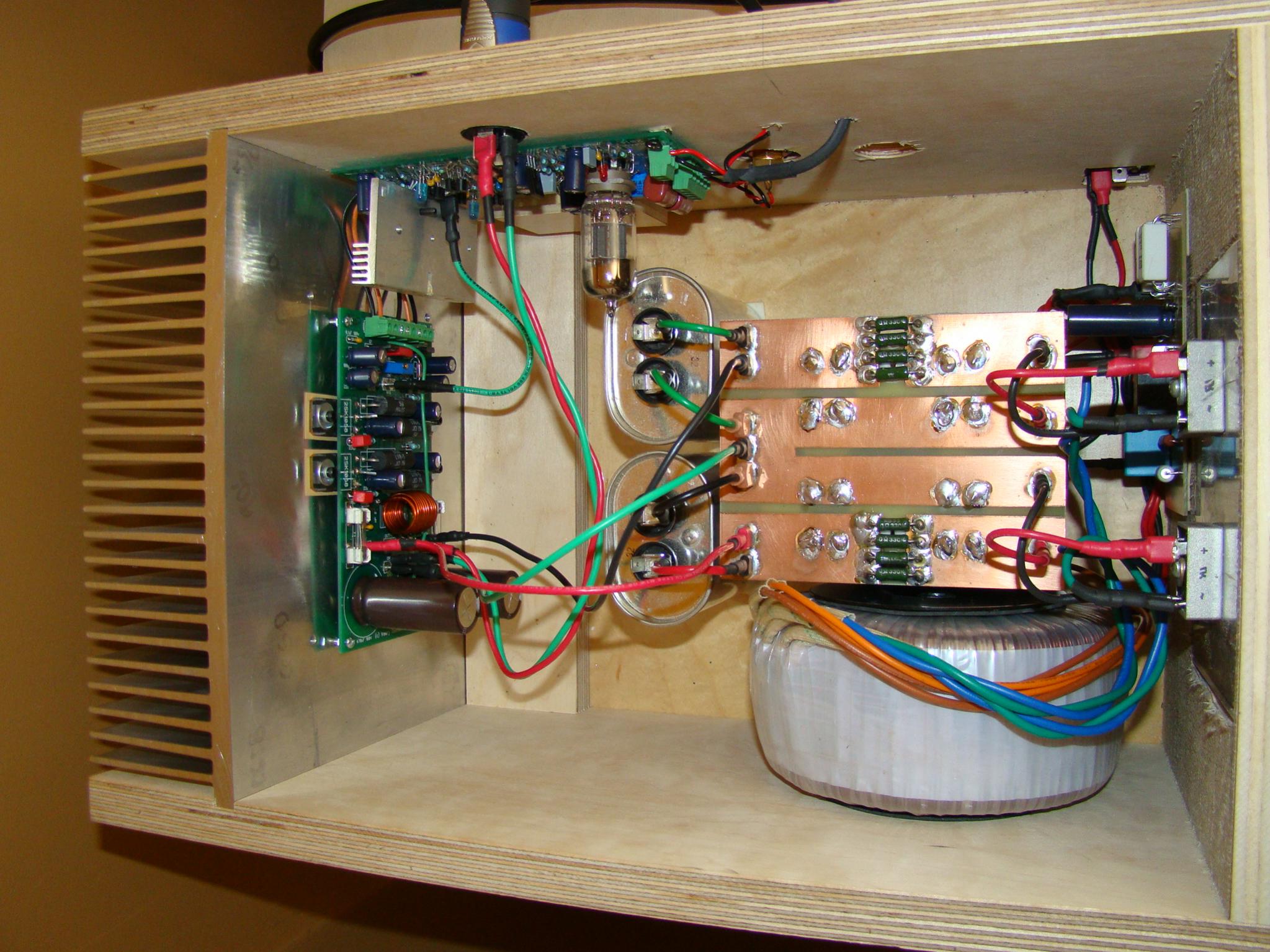

Thanks for taking the time to work this up. It will take me a bit to digest your plan. I can do balanced input or single ended. Starting with double outputs and a single input looks OK. Here are a couple pics of the amps as they stand now...should be no problem to add a second output stage. 600va transformer and good amount of space. The heatsink with boards attached slip right out of the case for easy playing.

Nice job Evan! Funny, I'm a retired carpenter and I never think to build cases out of wood.
Speaking of power, my P101 uses just two pair of latfets and it runs on +-70v and will do 300W into 4 ohms all day long. It was my first amp build and got a lot of use into 4 ohms. I built it three channel thinking I would use it for the front end of a 5.1 system but ended up just using the center channel for sub duty and it worked beautifully for that too. Unless you are doing DJ work, I'll be surprised if you would ever notice the extra pair of outputs.
