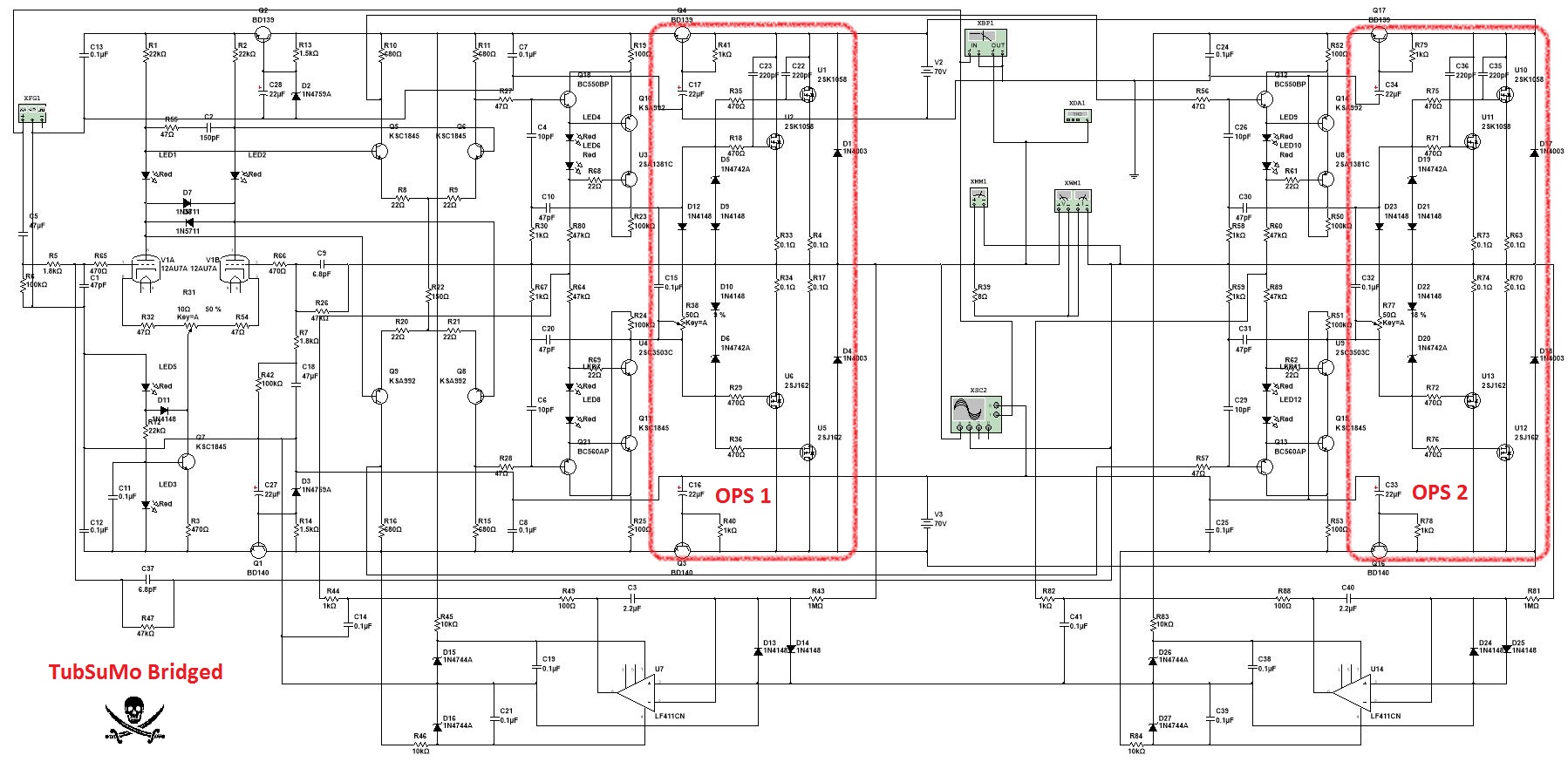

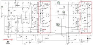

Evan - tried the bridged setup. Double VAS, double servo, double OPS, two NFB loops - works fine in simulation. Also, fully balanced operation is possible (balanced input is easy to arrange).
Output power is limited by OPS modules in this case. With two standard ones I would not go above 250W. However, adding two extra pairs to each side of the bridge (and increasing the VAS current a bit) will allow driving up to some 500W at 8 ohm load with the same rail voltages.
Ultra-high performance super-power 😛
Wanna try? This is a hell of a project. I would build two mono-blocks, each with its own PSU. Balanced inputs. Sort of no-compromise hi-end
In fact, for home use, two standard OPS modules per channel are more than enough...
Bridged IPS requires certain PCB enhancement - not really difficult, having the original in hand.
Overall schematic as simulated is attached - just to give you an idea of the design.
Valery
