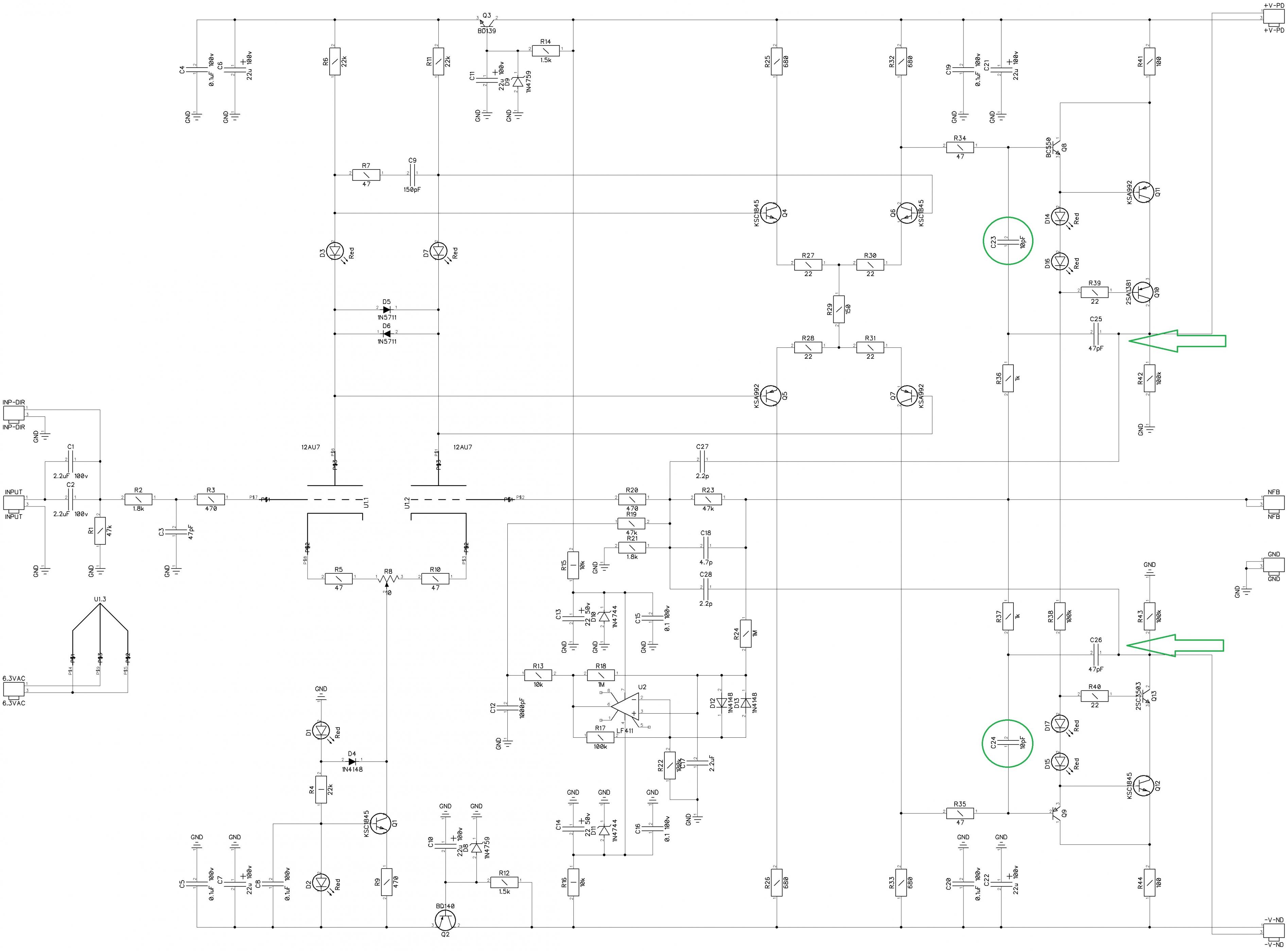

Terry, can you please try a few of things:
- first, let's try to connect the right sipe of the additional caps right to the PD+ and ND-;
- if the above doesn't help, let's increase C23, C24 to 22p;
- if the above doesn't help, let's remove R36, R37.
There are more heavier options, like adding caps between collectors of Q4, Q6 and Q5, Q7, increasing C18, increasing C9...
But let's start with those three above first.

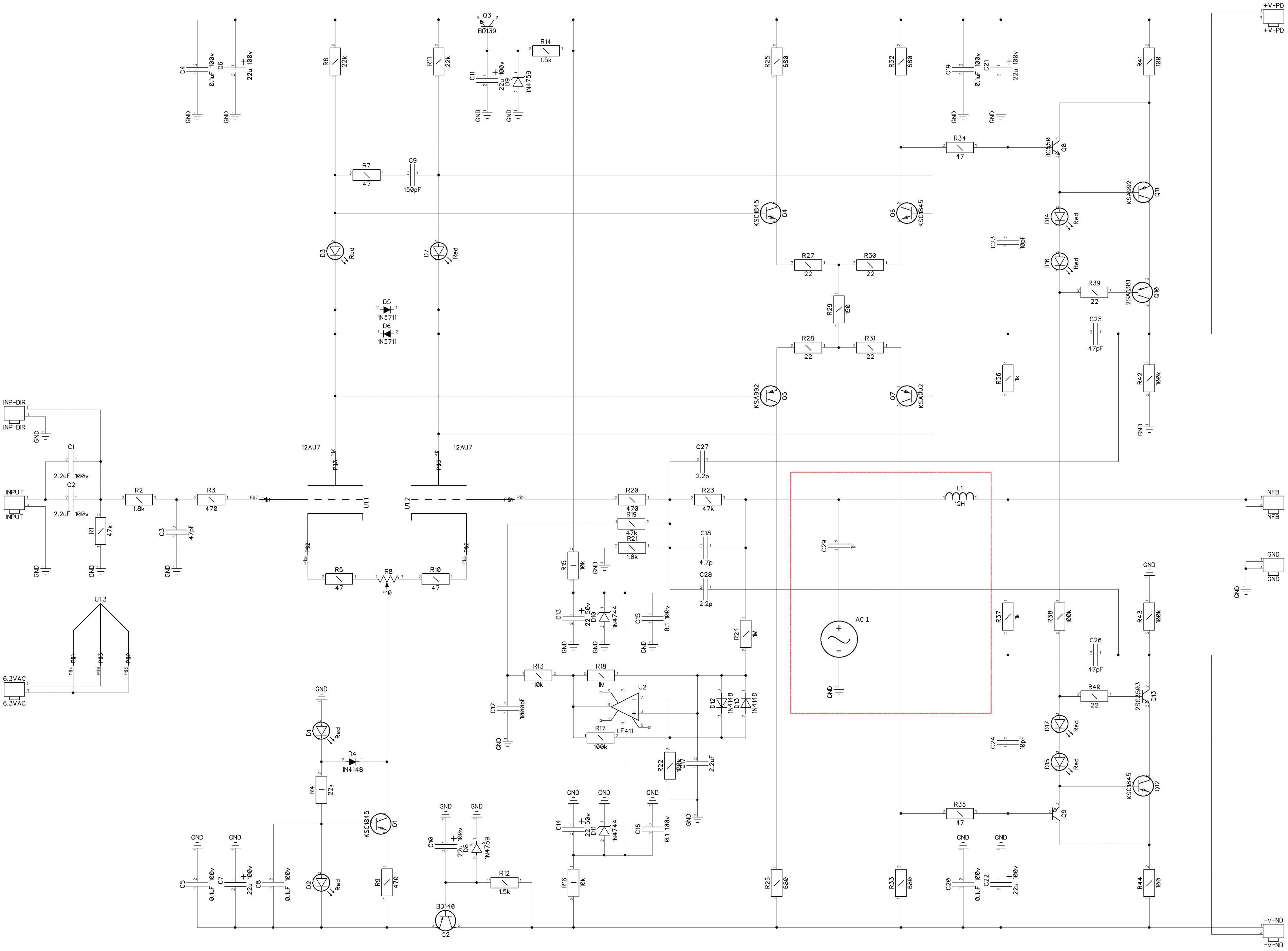

Most often I use the method, described by Bob Cordell (huge inductance + huge capacitance + voltage source -> AC analysis) - see attached.
In many cases it gives rather good results. When I can, I compare with LTSpice curves and margin values, published by others, and it's very close.
I agree, in complicated cases it may be not so accurate.
What is still rather strange - I'm torturing my prototype here and cannot make it oscillating. What is the difference?

...Most often I use the method, described by Bob Cordell ... - see attached.
Unfortunately you have it placed incorrectly, even to probe the TMC loop.
And since you have a 4 section amp there is more to do.
When I can, I compare with LTSpice curves ...published by others, and it's very close.
The LTspice simulator itself is very accurate, but many other people make the same mistakes, and then think it's correct because it matches.
The best example of this is the absurdly low value of distortion many people claim for MOSFET amplifiers, because they use the same worthless models.
... in complicated cases it may be not so accurate.
Your amp is probably one of those complicated cases, it would be nice to check.
... cannot make it oscillat[e] What is the difference?
More than just stability analysis differences, I assume.
But if we did a correct stability analysis we could learn more and perhaps see where the critical components are.
Could you put the circuit into an ASC that I can read with LTSpice?
I have built some LTSpice test modules and I can look inside.

OK, starting at the top;
Relocating the 2p caps made things worse so I disconnected them.
I tried adding 10p to C23 and C24. Very slight improvement. Tried adding 15p, about the same, still bad oscillation.
Removed R36 and R37, BINGO!!!!! "NO OSCILLATION"
I haven't tried it with the Slewmaster OPS yet but with the lateral OPS it is beautiful. May I assume we are good or is the circuit now crippled and needs further adjustment?
Thanks, Terry

So it didn't like TMC in your case. Now, with simple miller it feels better.
I'm researching the behavior more deeply, maybe with David help we will get more precise understanding of the loop gain curves.
Measurements to check:
- voltage across R32 = 960mV;
- voltage across R41 = 940mV;
Giving us 1.4mA through second LTP and 8mA VAS current.
