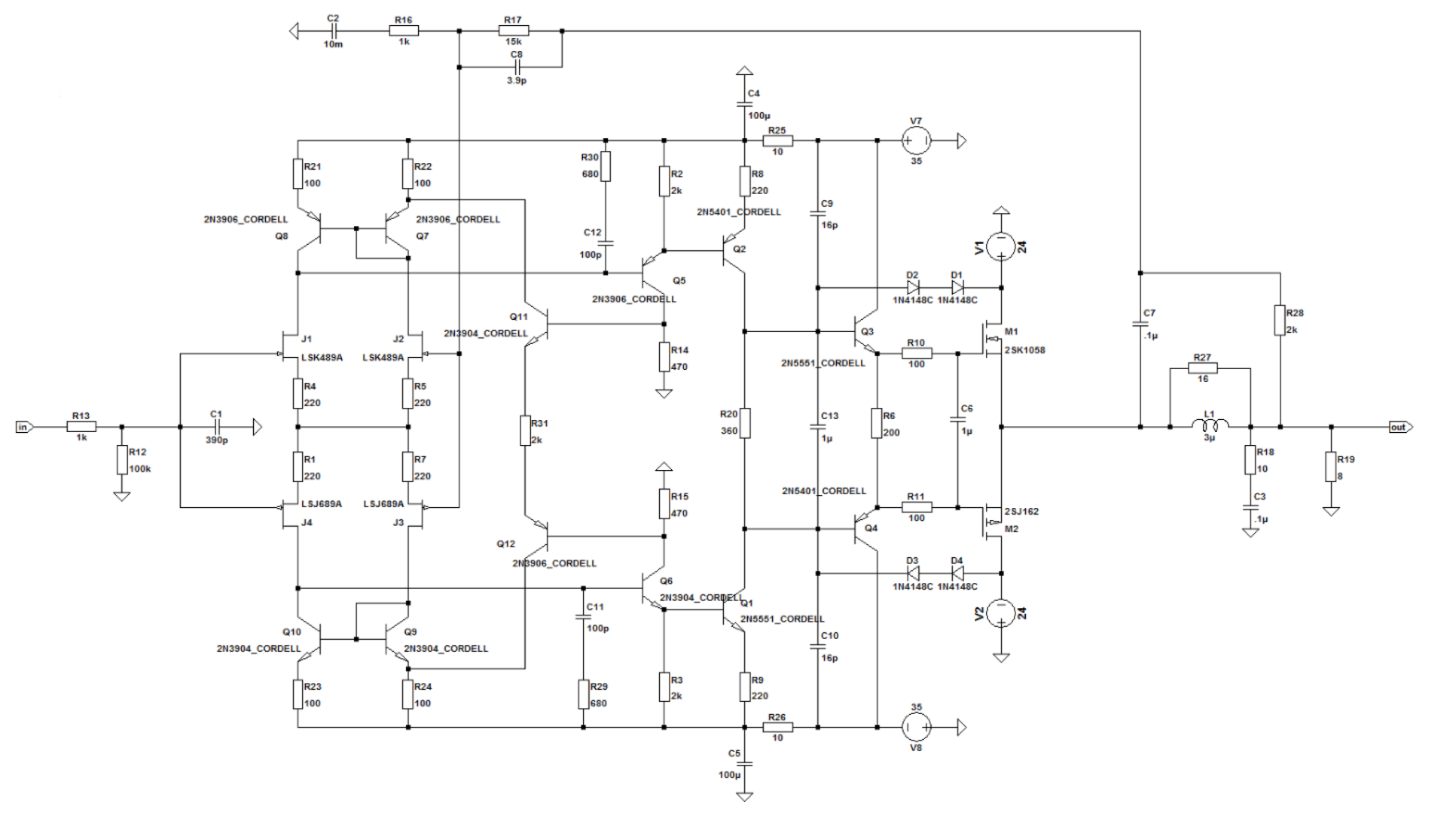

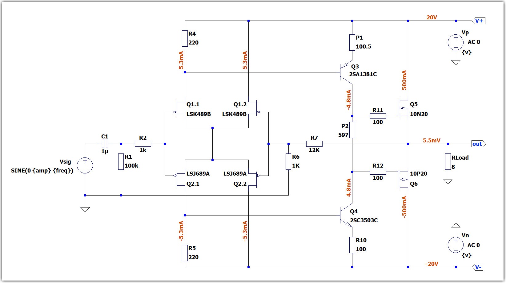

Ultra Amplifier with JFET input and Lateral MOSFET out
Lineup - There's two problems I see with your design if actually built. These are simulation vs real-life differences.

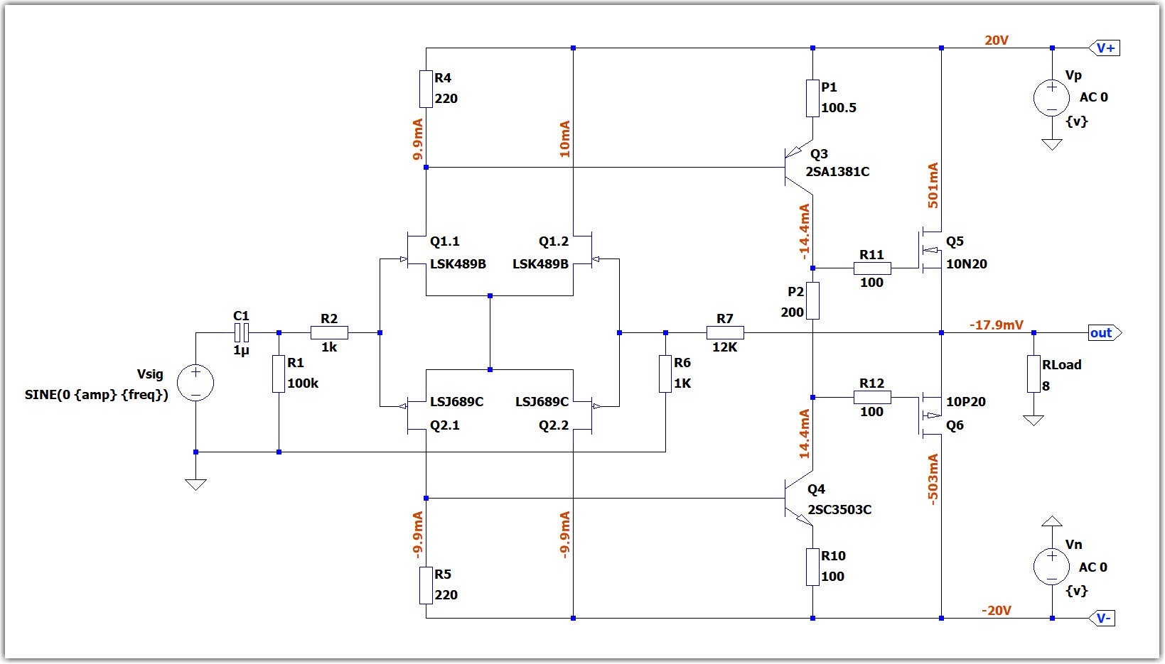

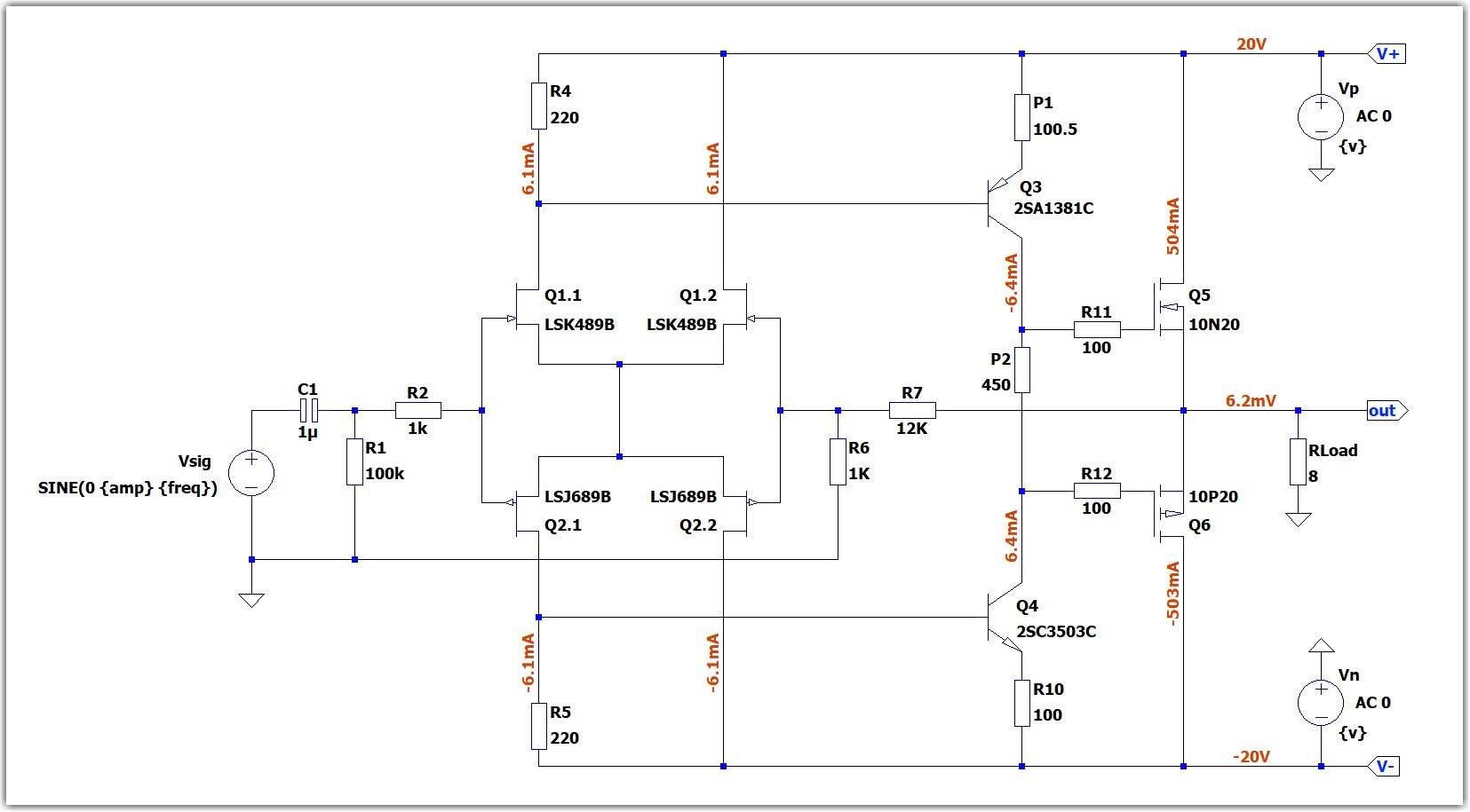

JFETs: you are running the JFETs at Idss. I've mentioned this several times. I'm guessing you only have one model for the LSJ689. You cannot buy these graded, like you can with the LSK489. Idss can range from 2.5mA to 30mA. The models available from Linear have Idss of 5.07mA, 6.84mA and 16.57mA for A, B and C grade. I attached sims at these different grades. You can see that the currents through the IPS and VAS vary widely depending on the LSJ689 grade. You can also see that the LSK489 are now running beyond their Idss range for the C grade LSJ689. This is why I suggest a pot between the sources of the JFETs and run the IPS at 2.4mA. This puts it below the lowest published Idss values you might encounter with the LSJ689. This also give you a set current for the IPS and VAS.
DC Offset: you have a pot on the emitter of the upper VAS transistor to adjust DC Offset, On your schematic this is a 200R and you have it set to 101.574 to NULL offset. However the resolution of a 25 turn 200R pot likely won't be greater than 0.5R. So it practice, you probably won't be able to adjust DC offset below 10mV or 20mV and it will vary another 50mv to 60mV from cold to hot states. If you use my suggested trimming approach, you end up with more parts but have more control over DC.

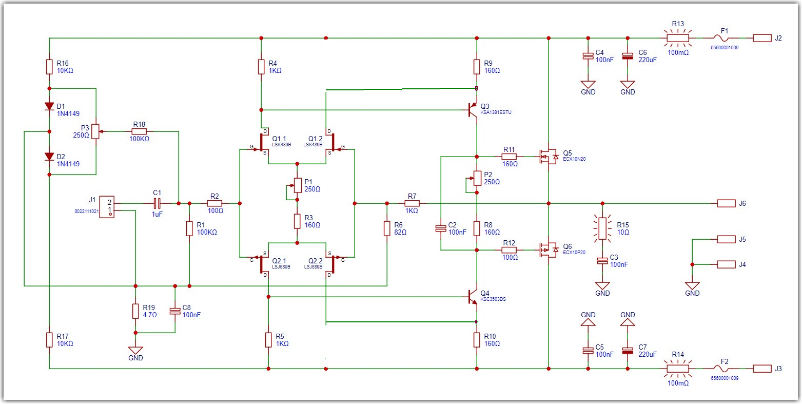

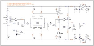

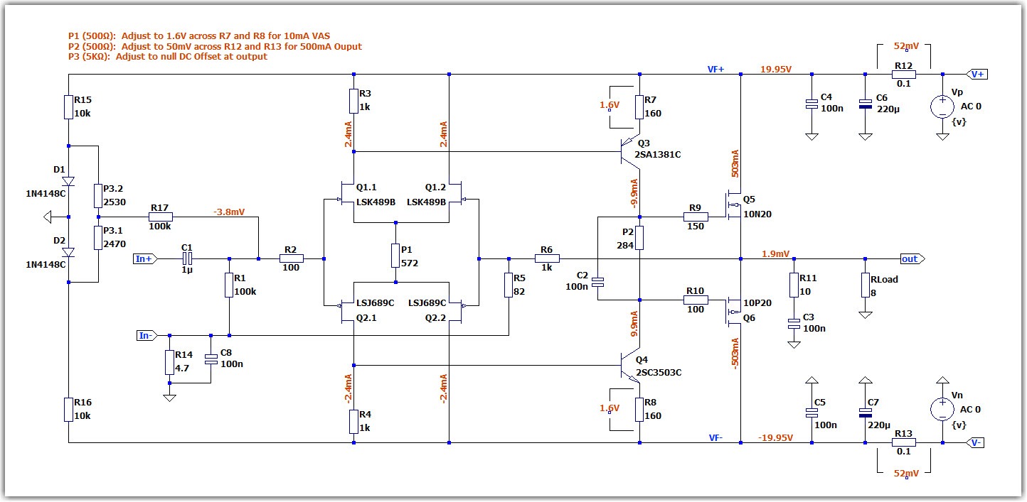

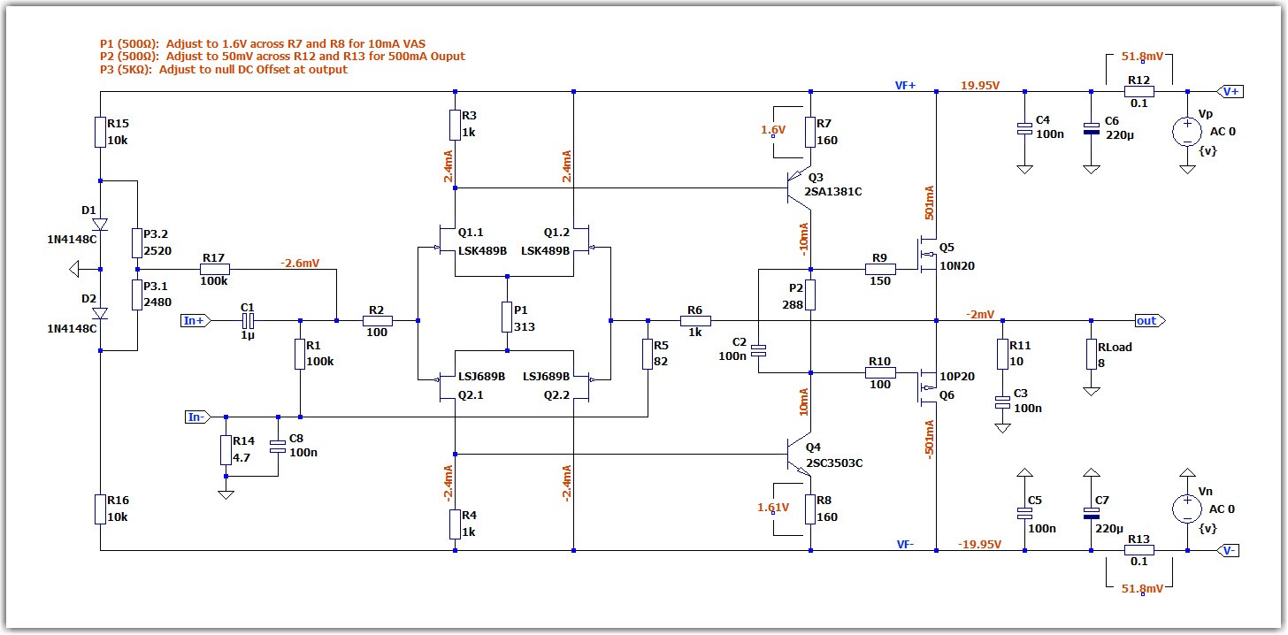

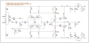

Lineup - this is my suggested changes to your design. It maintains the theme and spirit of your design, but adds in practical considerations.
  • Pot P1 allows for the JFETs to run at 2.4mA. It is accommodating of any grade of LSJ689 encountered.
  • The DC offset adjustment network (D1, D1, R15, R16, R17 and P3) should allow for DC to be adjusted to under 10mV. It should vary less than 20mV between hot and cold states.
  • R12 & R13 allow the output bias to be measured and set.
  • Reductions in R2, R5 and R6 decrease noise without otherwise affecting performance.
  • R9 is increased to account for differences in capacitance between the NPN and PNP channel lateral MOSFETs
  • Ground lift R14 and C8 added to ease challenges with buildings a quiet amp. A builder and put a link in for R14 and omit C8 if this doesn't appeal to them.
What do you think about that mod?
If R21R22 and R23R24 are equal, Q11 and Q12 introduce an imbalance of currents in the input diff stage.
This gives us a distortion of about 0.0005%
This parameter in itself means nothing; you need to see with what distortions the input stage operates and the distortions at the gates of the output power transistors.
lineup thanks for stimulating some discussion.
i am curious why no interest in the design as modified (which we have seen elsewhere: curl and hafler to name just a couple)?
no change in number of parts, just moving 2 connections that now takes advantage of the previously unused current in the other side of the diff amp.
Reactions: banat and lineup
That should be an improvement @mlloyd1
I have tested your way to DC-offset. But with a 10k pot and a 1M resistor.
I see you use 100k resistor. Would reduce input impedance, wouldn't it?
