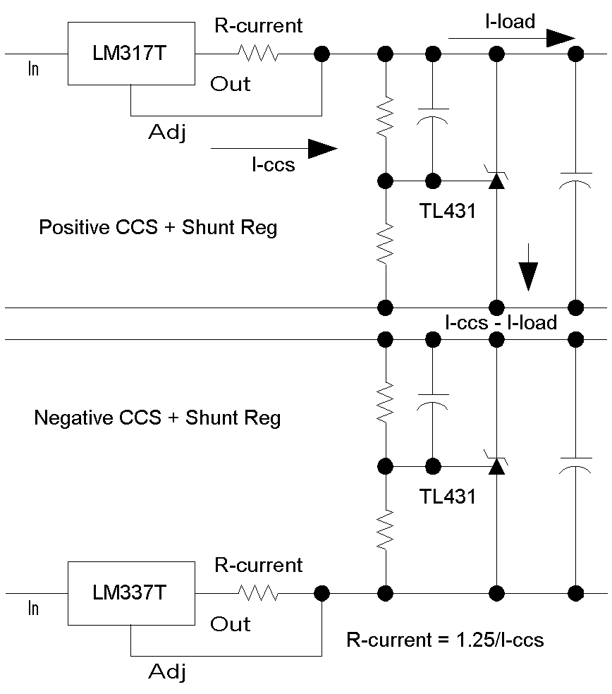

THIS IS USE IN THE 1541A pcb OUTPUT ( I/V) FROM MONSAN IN THAILAND.
Hello Thomas and friends here,
It's not I/V stage. It's power supply unit. I replaced the R load on TL431 by simple CCS. This used to isolate all the shunt reg from each other and to make the current flow on pre-reg constant, I though this will reduce some intermodulation in supply.
Actually, you can used it with all TL431 supply in the Thomas's kit but the most improvement shown when you use it at -15V supply of TDA1541A and Analog supply of CS8412/8414. I often set the CCS current for 2-3 times that the load need. I had set it 10 times and little more transparency present, anyway I can't stand their hot and loss energy. So, 2-4 times should be compromise rate for me. So, if you would try this circuit, beware check that the transformer, follower supply equipment and pre-regulator can stand for those amount of current and also heat ventilation.
I'm try to design the discrete cascode CCS to replace this CCS. Hope it have a little improvement. If so, I'll share to Thomas later. Or if someone ever done it, please share to us.
For someone who used CD-PRO2. This supply is also effective for +5V and +9V. I feed 800mA to 5V supply and 1.5A for 9V supply. You will see that the disc spining is very very constant and the sound detail also improve. I done it with old CD-PRO2 about 3 years ago but hope it will effect the same with present CD-PRO2M.

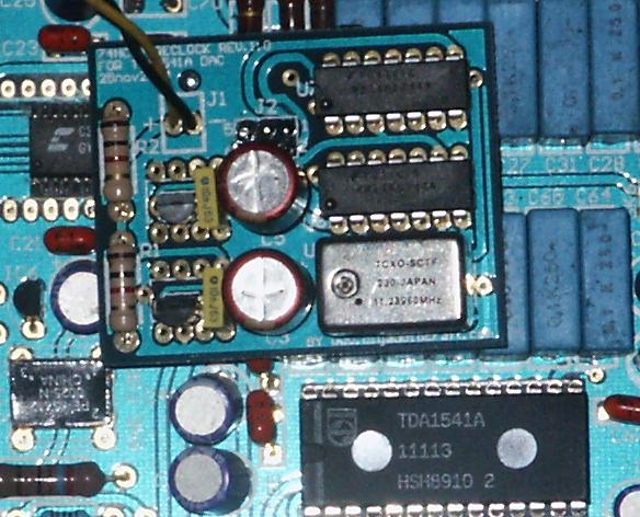

I finished my DAC this past Saturday and I had it breaking in since. This morning I had a listen and the sound is excellent. The amount of information retrieved is quite amazing. And the sound is big, full and dynamic, yet detailed and delicate. I love it.
For now I'm just using the op-amp analog stage. I'll be building the tube stage soon.
I also intend to build the re-clock modules. Can anyone recommend a source for TCXO's? Thomas, do you have any?
