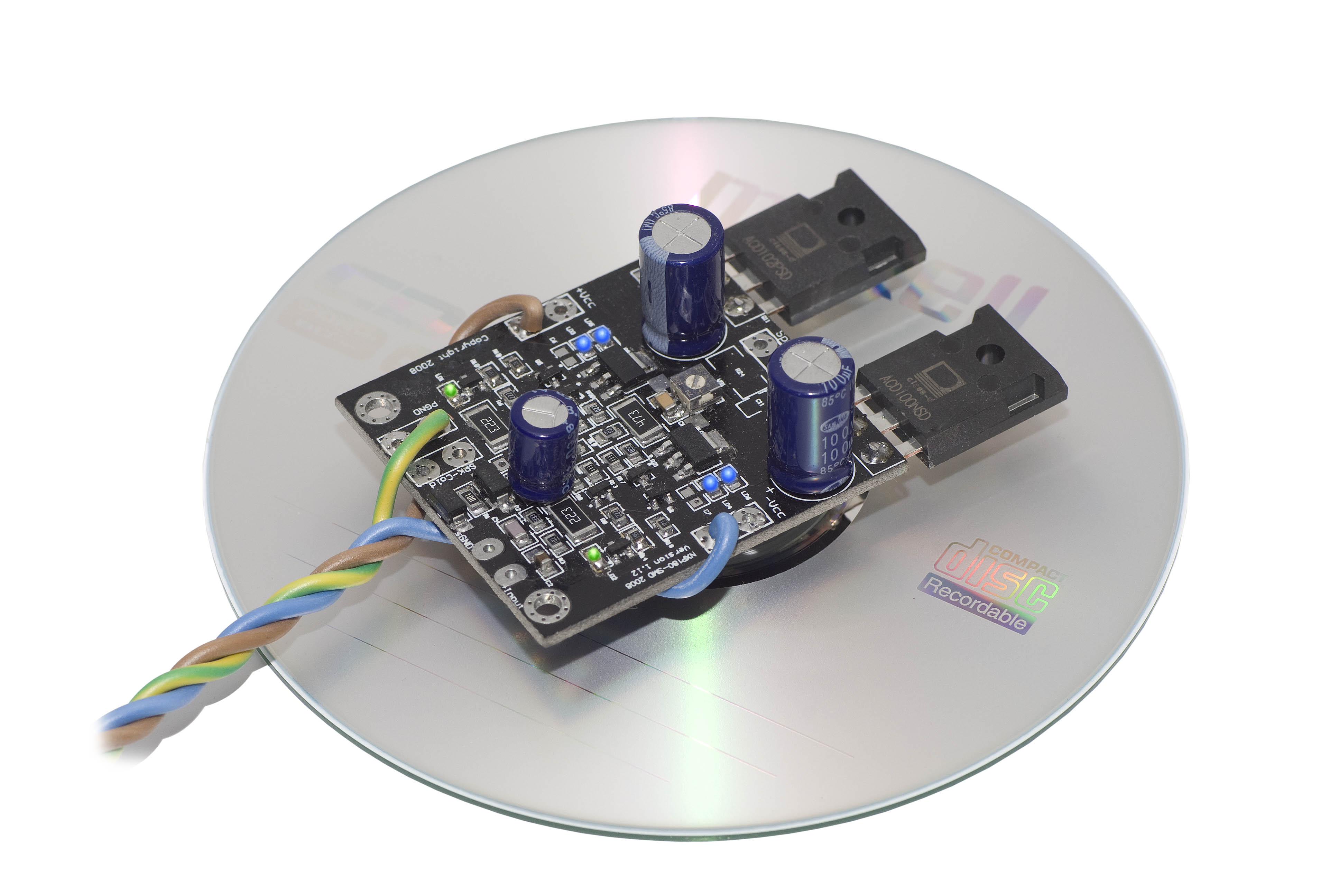

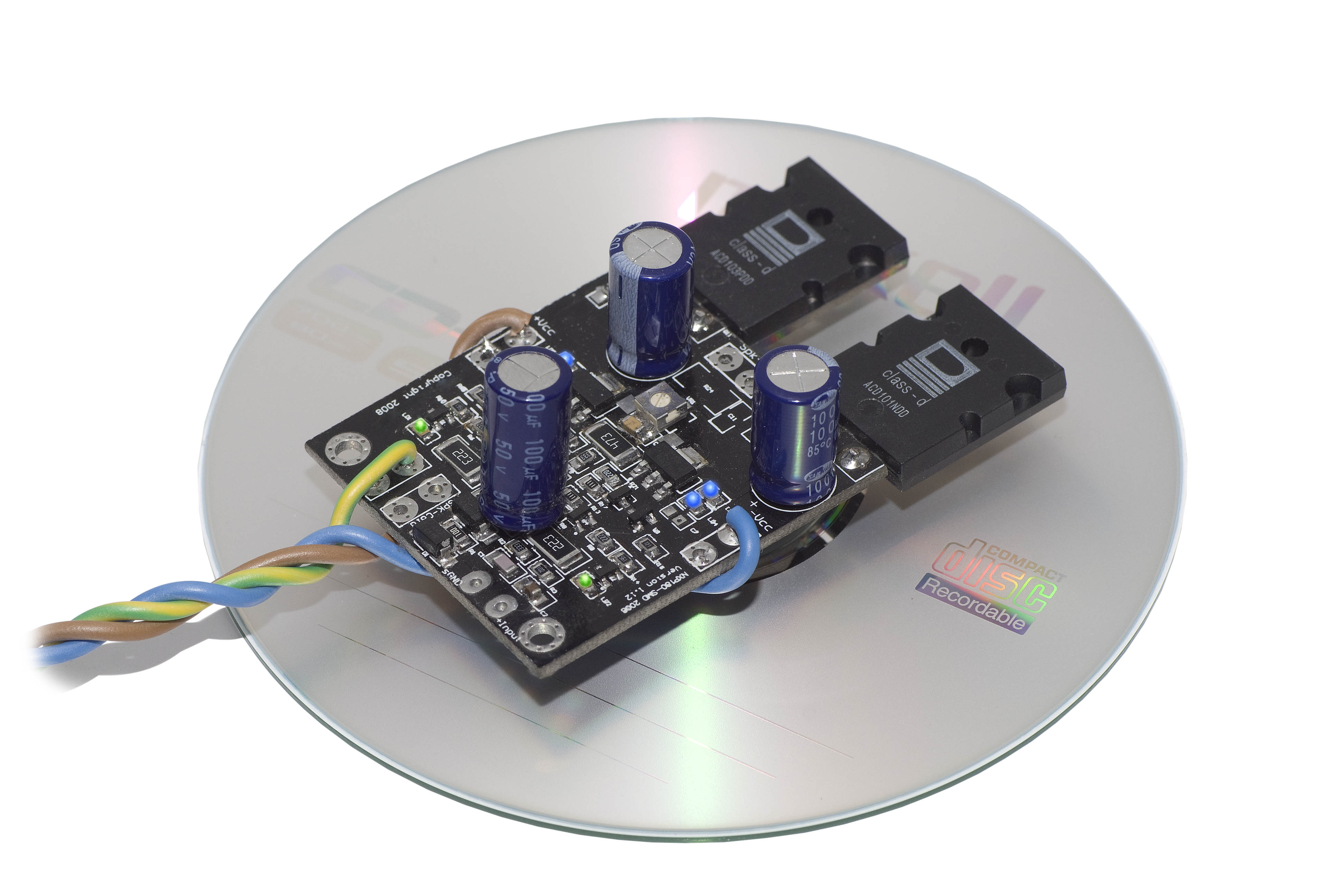

Supplement to post #6
about
Pro Audio - Miniature (M-Series) Power Amplifier Modules
http://www.proaudio.ltd.uk/Content/M-Series.pdf
I have found an additional board, that seems to be also without custom made front end IC's.
I hope, to hear resp. read more about the experiences concerning the audible differences (pros and cons) between all this topologies.
Which of this topologies have sonic character closest to the Pure Class-A Aleph and "First Watt" versions from Mr. Nelson Pass?
BTW - who knows a commercial brand, that offer amp devices or modules/units according the patent as follow?
http://www.sumobrain.com/patents/wipo/Ad-class-audio-amplifier/WO2006024739A1.pdf
unfortunately the describtion is in french.
