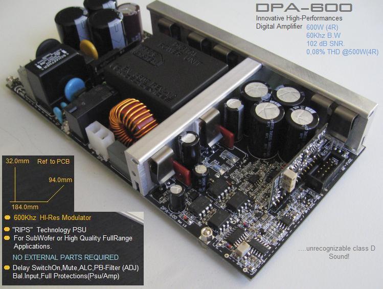

The amps in the above links are NOT class D but AB , although they sound pretty good for the money !
Cheers ,
Rens
indeed they are, they are also using the SEMELAB diffused laterals, same basic type and manufacturer as the ones used in 'the wire' Class AB power amp (not the little one already linked)
the Class D label printed on one of the sets of fets is simply a brand name, not the topology. semelab has diffused these fets under license to a number of companies
Any news?
Interesting fact. Without schematic this isn't easy to know.indeed they are, they are also using the SEMELAB diffused laterals, same basic type and manufacturer as the ones used in 'the wire' Class AB power amp (not the little one already linked)
Because at intregrated solutions there is no possibility to reach the inside components for matching resp. correcting the values (e. g. in order to the background noise requirements).Can I ask why a discrete version would be better! It goes against a lot of design technigues required for Class d amps (effectively a modulated SMPS). A discrete design would be more spread out introducing parasitic inductances amongs other gremlins IMO.

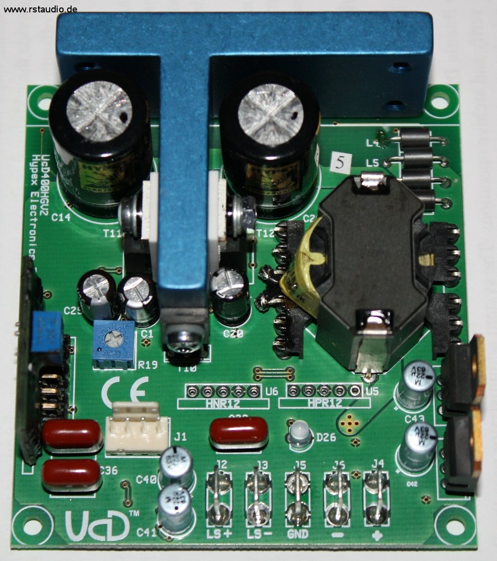

Hypex Electronics BV - UcD

I can't say I like SMD and for DIY I have avoided working with them, usually by buying pre-assembled pcbs. However the march of "progress" is inevitable. And with less people even interested in DIY electronics nowadays it makes the problem even worse. I think the MUSES72320 volume attenuation chip may end up being the ic that forces me to pop my SMD cherry, or possibly the TPA3251D2.
Class-d has some unique problems, people have talked about the parasitic inductance already that requires short traces. Also the problem it may stop oscillating, for me at least means I want DC protection. Also shorted terminal protection is a good idea along with thermal protection. All this ends up meaning that you need a lot of circuitry, but with the ic this is all built in and cheep.
