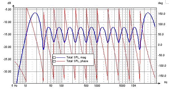

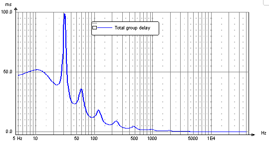

I'd never actually sim'd something so silly 🙄 so I gave it a shot. This is the SPL, phase and group delay of 11 parallel electrical bandpass filters using the OP's frequencies. It's an 11-way as he has 2 supertweeters. The lowest bandpass is an LR4-15 highpass and an LR4-30 lowpass. The highest is an LR4-15360 highpass and an LR4-30770 lowpass. The others are spaced an octave apart in between. Notice how the phase wraps through 360 degrees every octave.

Also note that the average SPL is down about 15dB from the nominal driver sensitivity. That's strictly because of the interference of the filters. Add in the random placement of the drivers and I shudder to think what the acoustic response would be like on and off axis.

Great simulation Catapult.
Yes, if you have an LR4 filter an Octave away from another LR4 (both of them 6dB down at their corners) then you will be throwing a lot away in the filter. It is possible that there is a better summing configuration and of course the driver delay has to be considered as well, but Octave bandpasses are not the answer for maintaining sensitivity.
Still, the real key is painstaking selection of the crossover components.
Interesting. I'm not getting my head around the result, though; if the bandpasses are in parallel I wouldn't expect any driver with more than a 360 degree rotation. Since we're being silly, can you share the schematic?
I just have the demo version of LspCAD so I couldn't save the file. It was built with active transfer functions so there's no interaction between passive components. In the real world that interaction is a real possibility, maybe making the whole thing resonate as Speaker Dave mentioned. The general layout is like this except 11 of them instead of just 3.

Hmm, I'm not seeing where the excess phase is coming from. Would have to sim it.
An 8th order bandpass (4 high and 4 low) has to swing from 360 degrees positive at the low end to 360 degrees lag at higher frequencies. Generally you'l have half that phase shift at the corner frequencies so: +180 and -180 or a 360 degree swing each section (repeat 11 times = 3960 degrees.). How you have the sections add is not something Ronin is telling us, or is apparently aware of, but you always get the best response if you can get the phase swing of one section to overlay the next. Did we mention that the drivers have phase shift due to their response and physical depth? Did we mention that textbook crossovers don't acount for the driver as a load?
