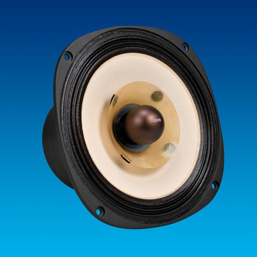

Been listening to Lyeco Fullrange LY802Fs for a bit now. Seems they have something. Efficient enough (93) for tube amps.... at least my 8 watt 300Bs don't have a problem. They have pretty warm full bass (as it goes for any full range) compared to a few other full rangers I have heard.
Currently in TQWT enclosure. Took a bit of playing with stuffing....but in the end, jazz (what I listen to most) and classical sound pretty damn good.
Just finishing up designing BL horn for them. Over the next month or so will construct them (not small or light is the way it is looking!). I know, high Qts... but the math says I can, which is good enough reason to find out!
Specs> http://www.lyeco.com.tw/full range.htm
