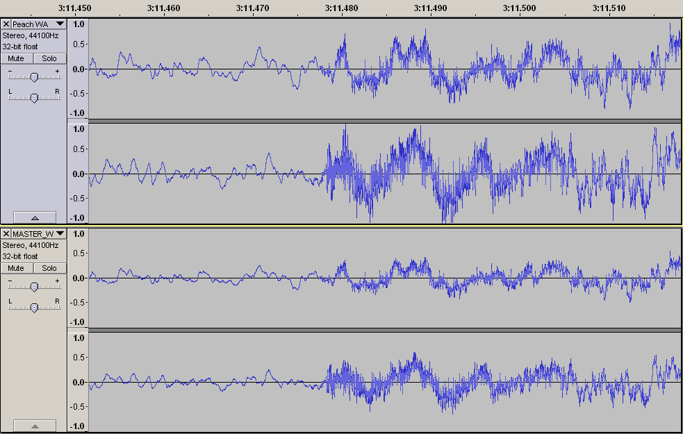

I was examining the files, looking to see about ways of comparing them using software, and this popped out: a clear example of electronics misbehaving, for no obvious reason. This was the Peach vs. Master file, the former nominally well performing ... look at the right channel, the lower of the two in each track, at time 3:11.480 - the circuitry abruptly gets fed a dose of much higher frequency content, and the waveform peaks at a much higher level than it should - clear distortion taking place ...
These 2 files have clear different levels. This can easily be the cause of the difference in graphics.
Never use visual clues to determine audible differences, it not good practice.
