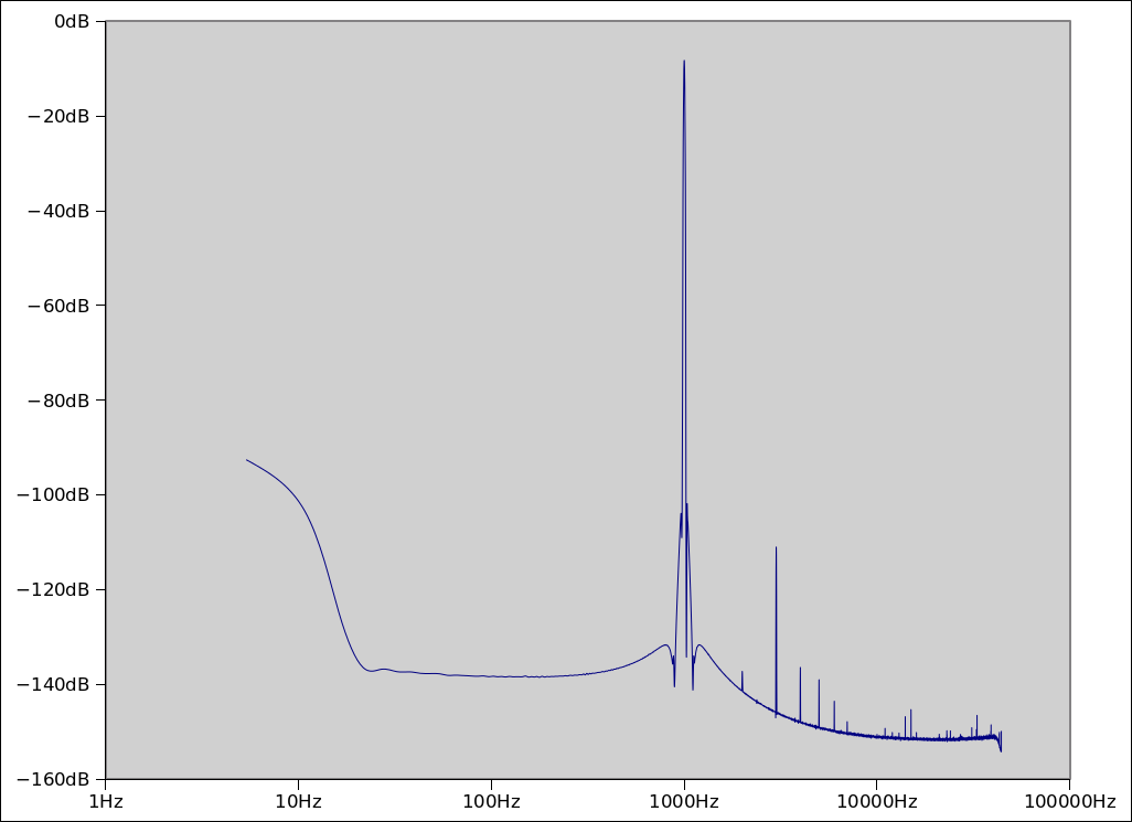

I can do a loopback measurement looking like the attached graph - which is not too bad apart from the insertion of 3rd harmonic at -100dB. There is only one op-amp in this path and DAC and ADC are on the same clock.
I have some quad 741 some LME49710NA and JRC211
Just need some good audio samples and permission to post them...
An alternative might be to get a log sweep measurement of the op amp, calculate the impulse response and let people process sound files of their own choice perhaps.
