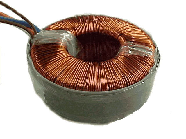

Ref the belly band is that really needed for a toroid? My investigations suggest that it's more use for an EI core.

I think for clarity it's very important to split the discussion into 'internal wiring' related him and into 'earth loop' issues. A powered up amp with inputs disconnected should have zero hum on the outputs. That's the first step.
Diagram: there will be later untill then check out Bonsai's PDF it has a great image on the desired layout.

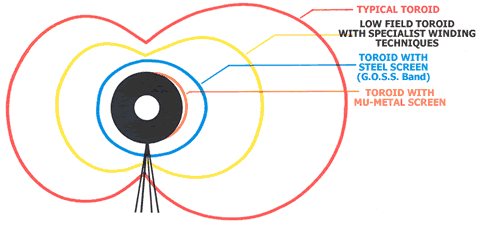

Belly band: Nuvotem Talema :: Custom Design :: GOSS Band

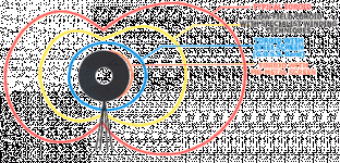

Toroid field: http://music-electronics-forum.com/attachments/25591d1381278081-stray_field.gif

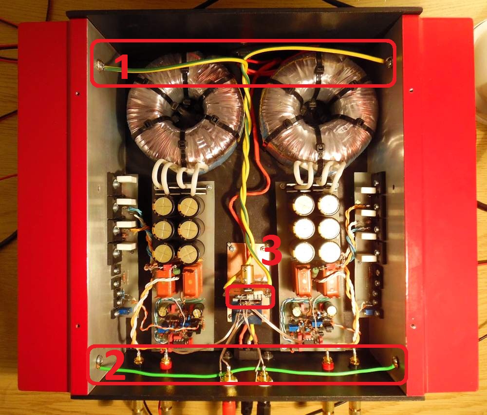

By the way, running a solid cable from the input connector to the earth pin on the mains inlet receptacle can also lower hum if you have a ground loop. I will update my PDFs to show this. The input connectors must still be isolated from the chassis.
In my opinion this is very bad idea. Mains earth should be connected to the chassis, and input connector earth to the star ground and the star ground connected via loop breaker to the mains earth (chassis).
Yes dadod, agree. I am not saying remove the chassis earth.
1. 3 pin IEC receptacle earth (Ground for the USA folks) goes directly to the chassis bond point (I always recomend only one chassis bond point). This ensures the chassis is earthed safely.
2. From the input RCA receptacles, run a wire from the receptable 0V to the IEC 3 PIN Earth. The RCA input receptacles must not connect with the chassis.
Why/How does this work? Any loop currents are diverted away from the input circuit and straight to the earth receptacle. This can reduce hum substantially in some installations.
You can read about it in Self's power amp design handbook. I tried it and it works quite well.
The above technique is for systems that do not use a ground lifter - typically commercial designs.

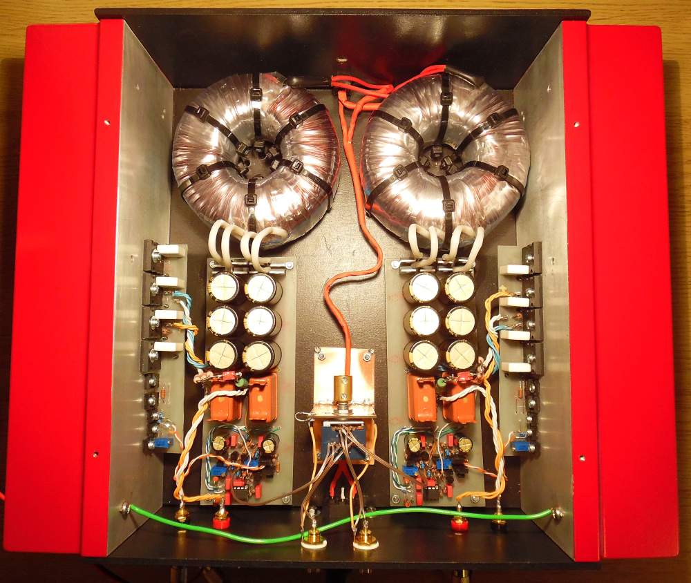

By the way I have some hum issues in the meantime as well.
I have a dual PS in 1 partly wooden case as the metal heatsinks are the sides walls. (Attchament #1)
A just made the mods based my own summary and it helped a lot!
It is still not perfect for some reason but I hope it will be hunt down as well.
Also a strange and new discovery came out:
As you can see at the attachment a had to connect the the heatsink together at 2 different points.
I just tried it because I thought in case of a conventional metal case this is the case via the chassis.
And it reduced the hum a lot... :-o
Do you have any idea why this helped? This is a loop now anyway why is it better..?
You can se at Attchament #2 the fresh mods:
  1. HS link #1 (this goes to the earth star ground)
  2. HS link #2 (this is just a HS link goes nowhere, tested new earth connection doesnt improve)
  3. pot metal case to the earth star ground + (10R+10nF) between earth and RCA GND (without the rectifier yet).
Before that I just had the HS link #1 going directly to pot case and RCA GNDs (earth wast involved at all) and even
a strange cracking noise was produced because of improper grounding while playing music with kicks (drum).
Even turning on of the amp was different and strange ticking noises were present... :-o
Do you have any ideas/comments for the remaining hum based on my layout?
A question: in case of such a dual PS in one chassis where the 2 different PS GND should be united?
At last it happens at the RCAs (just like in my current layout) but is it okay/enough this way or they
should be connected somewhere else for example between the 2 main PS GND in a star/bus point?
