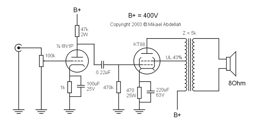

Here is the schematic I used for my KT88 amps. It was designed by Mikael Abdellah. Do a search here for that name and you can find several threads about the amp with a lot of good info.

I loooove Mikael's schematic....
But I'm a little bit confused: how much power can such an amplifier produce?
It is ultralinear, so, I suppose, about 5-8 Watts, as you reported?
And, what is the "operating point" you mention?
Sorry for my stupid questions, but I'm a beginner...
Ciao,
Giovanni
Hi croccodillo,
the operating point is the "way" you choose for make "well-working" the tube. You have to study the datasheet of the tube, seeing the curves, and then choose a load(for output tubes generally it is the output transformer) a B+ and an appropriate cathode resistor(bypassed or not by a cap) for negative V of the grid. Naturally you have to do the same for signal tubes(in this case the load is generally a resistor). This is also a rough semplification of the question and there are many other factors to study ad take care of.
Btw I am not in accord with Sherman, since a KT88 can make more than 5-8W.
It represent a "family" of 35W(plate dissipation) tube, with 6550, and some versions can reach up to 42W(plate dissipation).
So, in triode mode(single ended) the KT88 can reach up to 12W of output power, in tetrode(it is a tetrode and not a pentode) or ultralinear(single ended) can reach up to 20W of output.
In push pull(2 tubes in triode mode) it can reach up to 30W, and in ultralinear mode(push pull) can reach 100W or more of output power.
Generally, an output power of 5-6W is referred to EL34 tube in triode(single ended). Remember that EL34 is smaller tube than KT88. El34 have "only" 25W(plate dissipation).

Given your choices of KT88 I think I would choose either the Svetlana or the EH. No big reasons, it is just that I've heard them and like the sound. I think the Svetlana (if we are talking about the Winged C logo tubes) has a bit better specs than the Sovteks.
If you can't find a 6N1P you can substitute the 6922 but you will need to change the anode resistor value since the 6922 has a lower max voltage than the 6N1P.
Another and possibly better option than simply putting in a bigger resistor is to decouple the PS. Use a 20K resistor in series from the PS, followed by a 47uF cap to ground and then the anode resistor from the schematic. (Double check that the voltage will be OK on the 6922, I didn't do the math! 😀 )

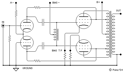

E-Linear
Hey-Hey!!!,
There is another way of getting some more NFB w/o making a loop from OPTx secondary to input cathode...
Peter Millett did it SE just a bit after I did it PP. Same inspiration, just slightly different methods.
Connect the input amplifier tube's plate supply to the g2 tap, instead of another de-coupled B+ supply. Here it is with a PP grid choke on the finals and in PP. Cut it in half for SE. It works best( lowest output Z ) if the amplifier/driver is a pentode, or a faux-pentode cascode.
cheers,
Douglas
