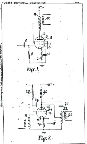

might be when you think of Blumlein
invented the cross ferenced bias, mentioned previously
and didn't he also invent ultra linear
just didn't yet have the trafo UL tap
and I didn't know that Williamson's amp was 'adapted' to be used for most of the UL tapped amp
and another surprice that the Quad scheme may have been way ahead of them all

for which I guess it was originally invented
