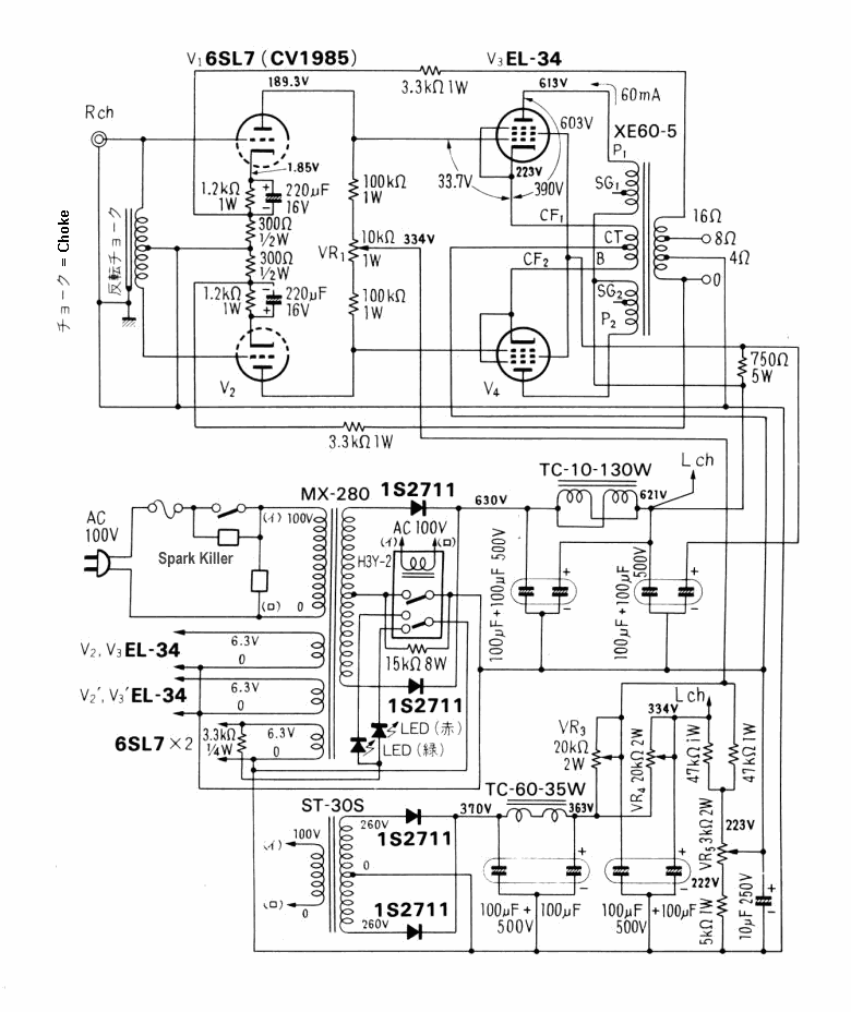

"looked to me like he connected the UL tap to the catode and cross referenced the PP plates
ahead of his time ?"
Hey,that's my Elliptron design! Extremely advanced. What was the title and source of that article?
Maybe: "Amplifiers and Superlatives" by D.T.N. Williamson and P.J. Walker (Wireless World)? I don't see Elliptron in that article, just ordinary CFB.

I don't see anything about "cross coupled" in the "Amplifiers and Superlatives" article. Is that where you meant? I just see CFB coupled, like for the Quad ampl.
I found it on google, somewhere
that is yours ?
hey, thats fun, I hope 😛
yeah, I know its not the original drawing from Williamson and Walker
couldn't find it again
but it was similar to yours
and very close to Quad schematic
hey, your Elliptron looks interesting, using UL tap to drive the catode in crossreferenced circlotron style

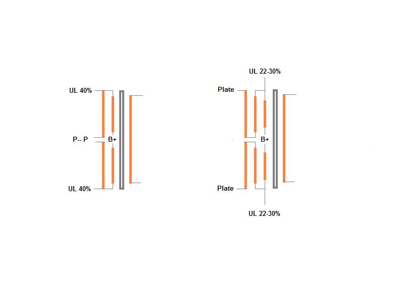

Since parafeed is not normally needed for P-P, I would think that PPP would usually refer to parallel P-P.
It's hard NOT to get UL with Circlotron, since just using a fixed screen voltage from ground reference gives UL, due to the cathode moving around.
That's why each screen is tied to the opposite anode !
And to obtain a fixed screen voltage from the two full floating PSU you just have to sum them with two resistors and a by pass cap !
You may even stabilize'em if you wish 😉
