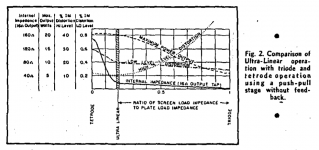

UL is an example of distortion cancellation. Usually when you apply feedback, distortion goes down proportionally with the amount of feedback you apply. More feedback = lower distortion. But when feedback is applied to a different grid from the input, strange things can happen. When you nudge the amount of feedback to some magic value, curvature in one part of the system can cancel out curvature in another part, giving you a sudden and deep null in distortion, over and above what first-approximation NFB theory would predict. Ul is aiming for that null.
This also means the optimum screen tap varies with the type of tube (and it's health) and with the operating conditions. i.e., with your choice of primary load impedance, which is also a function of your choice of supply voltage and operating class and... it could go on.
If you truly want to hit UL, you have to cut-and-try different feedback % while monitoring the distortion, or copy a proven design. If you can't be arsed with all that then you buy an off-the-shelf transformer which probably uses a generic 40%-ish tapping, and call it good enough for rock and roll.

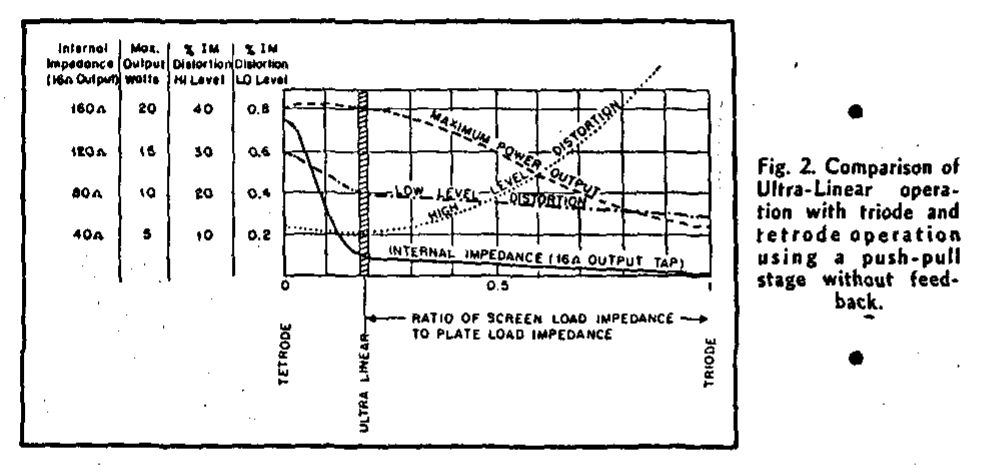

So if you want UL you have to understand what it provides vs. other screen tap points. Here is the plot for 6L6 and the Acro tranny designed for it, TO-300. Moving past the UL point you get more triode like results with lower power available and higher IM distortion.

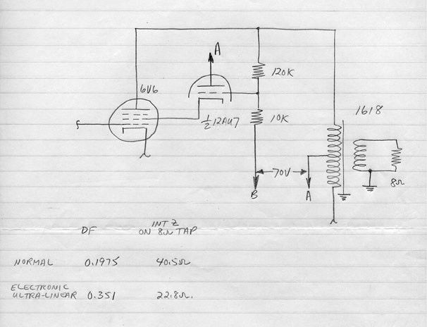

Around 1960 I thought, 'Why Not Electronic UL' , cathode followers driving the output stage screens. At the time the research project I was on used a lot of 6DQ5s. When hard driven it was possible to drive 1.5A pulses down a transmission line, something we needed. The 6DQ5 screens run at lower voltage so that seemed like a possibility. I got as far as some preliminary tests on 6V6s, but all seemed too complicated for the results. Somehow one of my original sketches survives. Attached here for the curious. Much later, about 20 yrs ago I found a tapped OPT meant for educational applications. It looked perfect to do many tests. But another money maker contract appeared & away I went. Think it was Lundahl, but not sure.

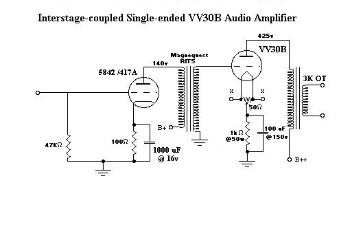

The SE partial triode 6LU8 cct is also attached so all are free to trash it. It is very different authoring for publication an article in a magazine directed to a widely diversified audience when compared to preparing an engineering report or a sales proposal.
