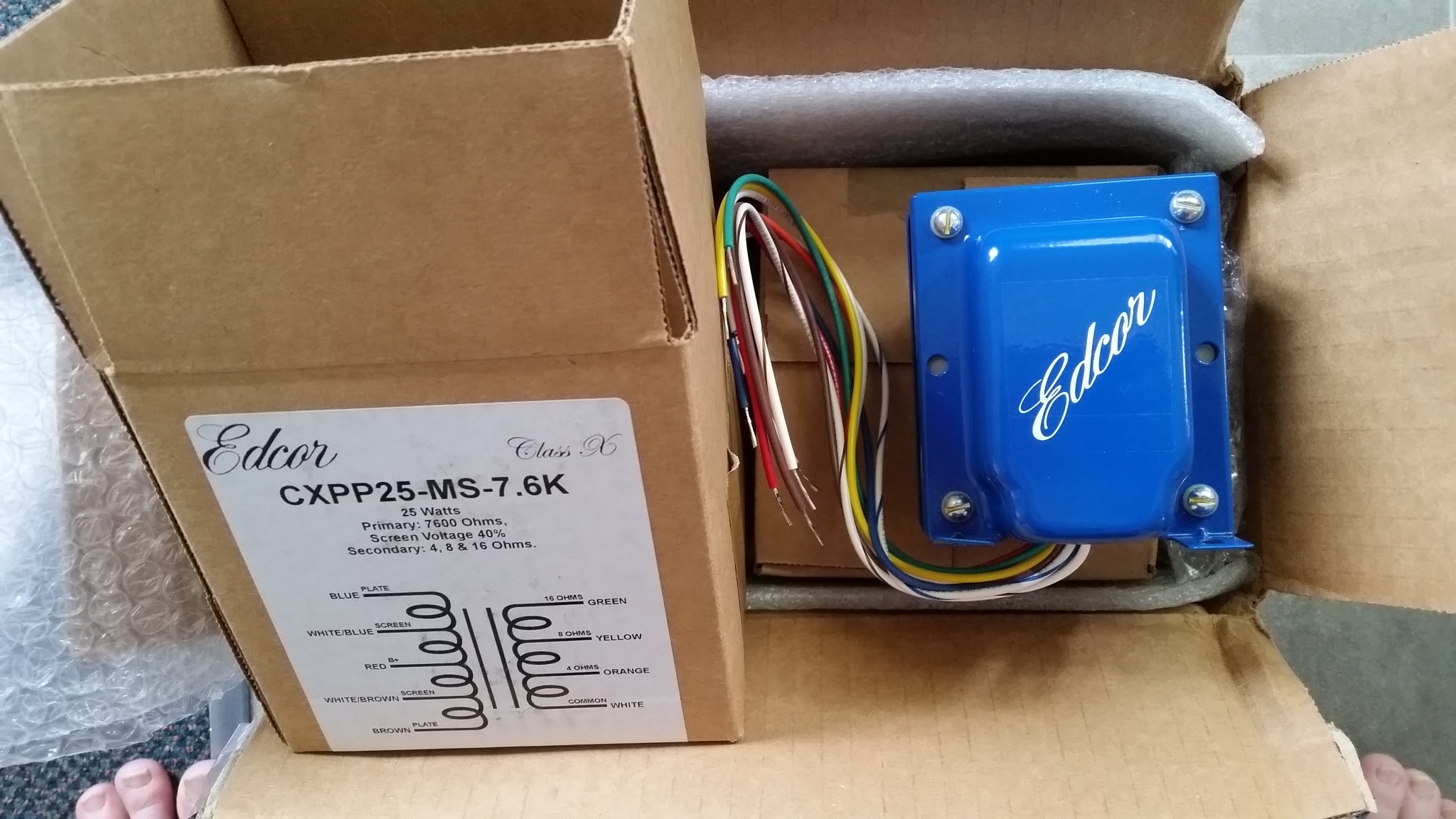

Finally ordered Edcor trannies and they have been built and waiting at freight forwarders in Oregon for sea freight to NZ. Total cost inc post to freight forwarders 168 us dollars and a further 54 to freight to NZ inc good and services tax.so all up us$222 delivered. Just the 3 month wait the trials living in remote part of the planet but will give me time to organise last little bits and pieces and start the chassis
Finally the Edcor trannies have arrived 6 months after ordering ,unfortunately little too late .I have final operation in a week or so to repair body mangled by a spaced out meth-head who drove wrong side of the road over me and me old motorbicycle so will be unable to do anything for 3 odd months. Surface freight turned out only took 10 weeks and was cheap in comparision to normal postal delivery costs around 80 nzdollars inc gst ,local sales tax,on total.So about US$110 each landed at my door

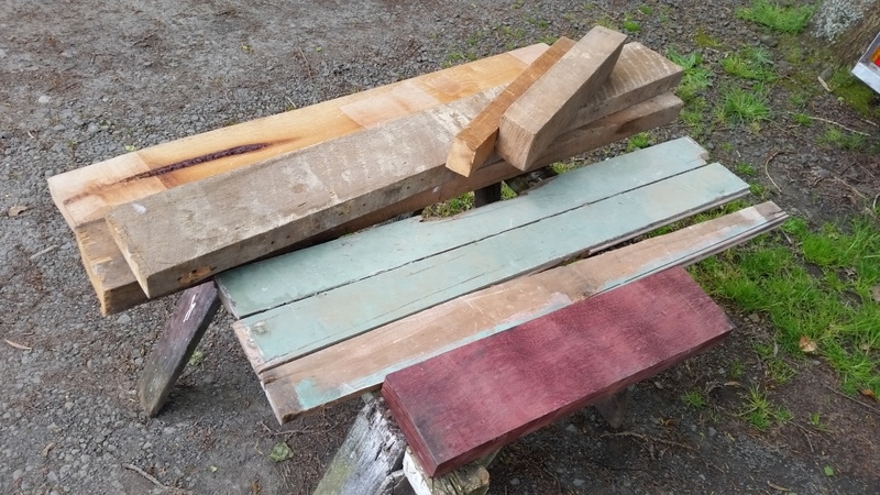

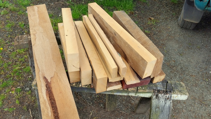

Taking advantage of the fine day before rain hits managed to dig out some shorts of demo Kauri and new timber ,Purpleheart and Rewarewa ,denail and rip off the paint on the really rough stuff, ready to start machining it up for the chassis 's of 2 amps and one preamp but the El Cheapo will be the main one to get started on.

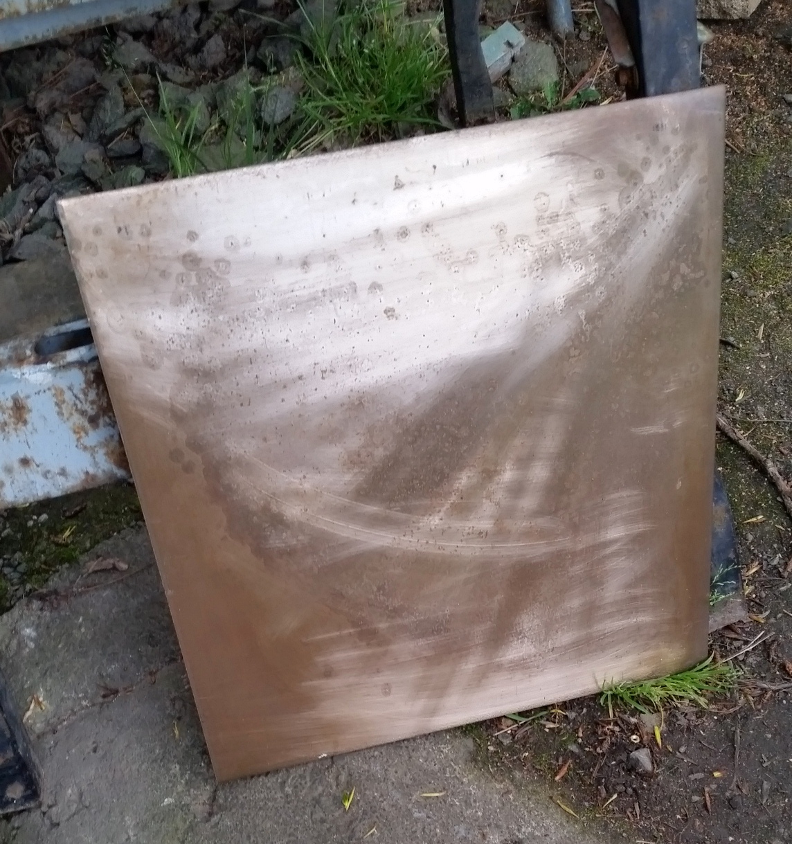

Also hauled out the weighty 13" x 14.5" bronze sheet but looks like a cat had pissed on it etched and oxided ,bit of a wash and rub with scotchbrite almost good enough to start marking it out for drilling
