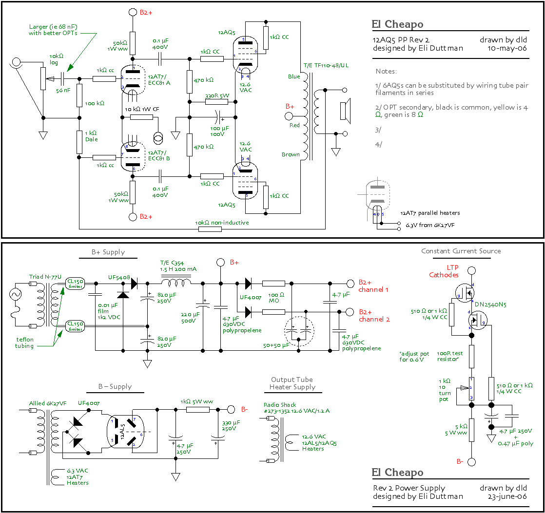

I'll toot my own horn and suggest you look at "El Cheapo". A lot of what you already have can be adapted to that well proven design. Please notice that "El Cheapo" uses a differential phase splitter too. As drawn, triode mode O/P tubes are shown, but switching to higher power O/P modes is quite feasible, if the "iron" is up to snuff.

Much better circuit and surely a better amp the "EL Cheapo" I'd build it with the 6 volt output tubes.

The "El Cheapo" that was suggested is an alternative amp to build.

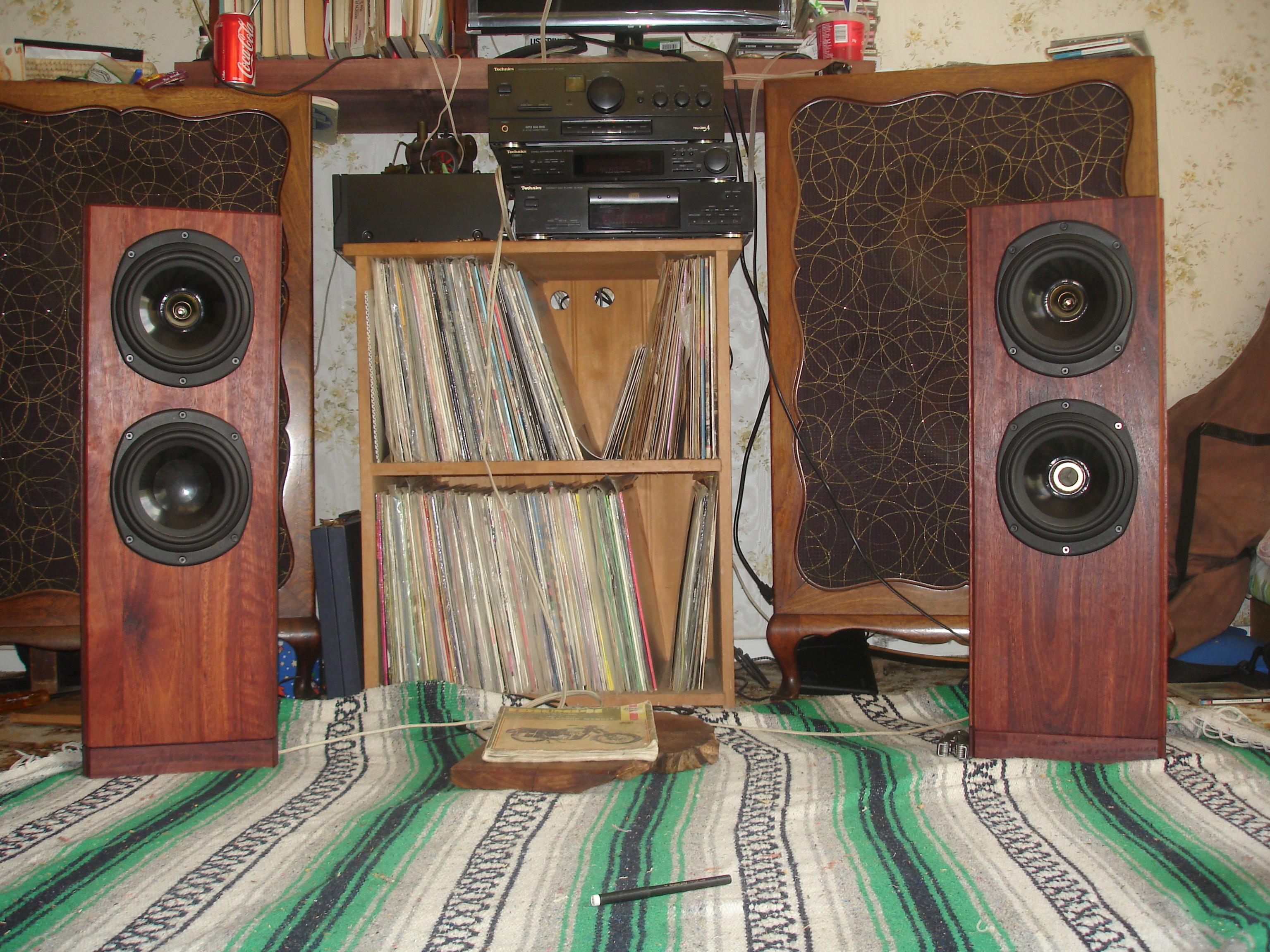

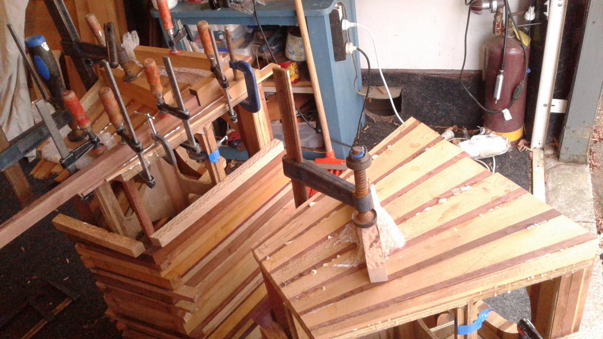

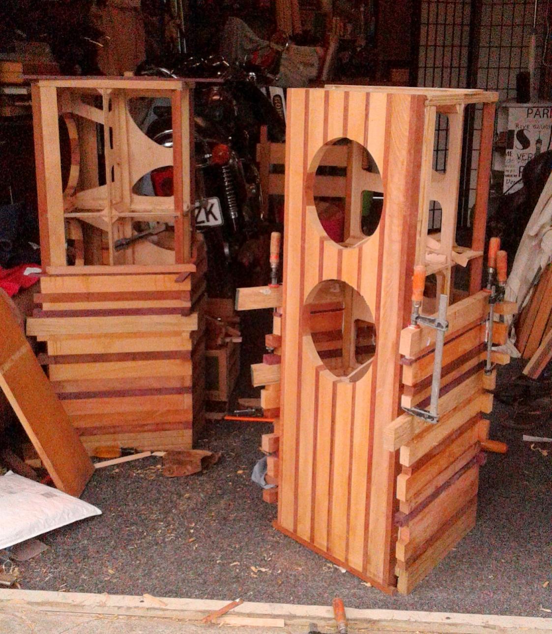

Have added some photos of speakers,the larger ones just got their top veneers on today.Dont normally make things that are so "busy" but these are an exercise in using up off cuts from furniture building scrounging etc and sort of inspired by rulers you could by with small inlays of various native timbers.

I'm anything but expert, when it comes to things Tannoy. A triode wired "El Cheapo" is good for approx. 6 WPC. UL and full pentode modes are good for approx. 12 WPC. So, mid and low 90s sensitivity speakers, respectively, are what you need. Given the NFB loop present, the damping factor is "OK". Remember, no tube amp exhibits the sort of gargantuan damping factor many SS amps do. Keep the impedance curve reasonably flat.
Edcor models CXPP25-7.6K & CXPP25-8K are suitable for a UL mode "El Cheapo". Magnetic headroom is essential, when (like here) a GNFB loop is present. Plenty of metal mass to be found in those models and shipping between New Mexico and New Zealand is going to be very costly. Expect shipping cost to be approx. = to product cost.
