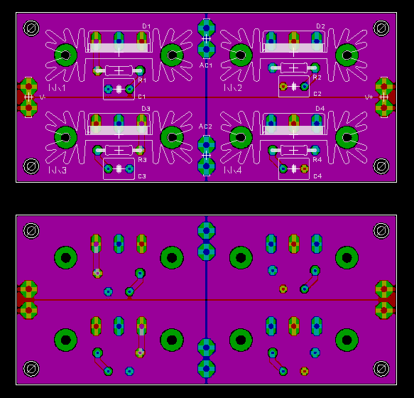

Right, I have had a quick bash at a rectifier PCB using the BYW99W-200's but without any of the snubber caps at the moment. I'm off to bed now, but I should be able to fit the snubbers on here quite easily when I have spare few minutes, and see if I cant make the thing any smaller so it gets a bit cheeper to make. This current revision would cost just over £3.00 per PCB for a single sided board, about another £6.20 for the diodes and about £4.20 for the heatsinks (so about £13.50 in all, which isn't too bad).
For the next bersions, the cost of the diodes and heatsinks will remain constant, and as long as I can keep the board single sided when I add the snubbing caps, that should still be the same price, so you would only need to add a pound or so for a couple of decent little caps to put on if you wnated to.

Fantastic BP ...... I would be in for 3 boards.............+ associated components.
I am really impressed with the quality..............+ layout ...this is seriously professional! Well done!!!

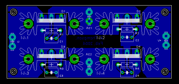

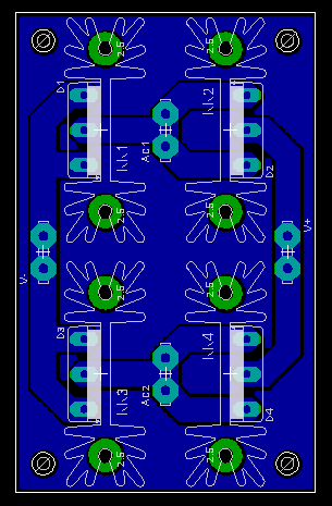

Ok, I have gone back and redone the layout to include snubber capacitors and resistors (these can be left out if you want, or run just with the caps so long as you put a wire jumper where the resistor is supposed to go). I also have some rough specs on what the board should be bale to handle in terms of curent with the selected diodes and heatsinks. The SK104 heatsinks have a thermal resistance of 9 deg/w, and the maximum junction temp for the diodes is 150 degrees, so with a Vf of about 0.9V, you should be able to run at 14A for a room temp of 25 degrees easily.
I have also worked out the rough pricing for the total parts list and boards, assuming we get enough parts to make about 25 boards (to get the price breaks on the components):

So, if people are interested this could be something else we could look at getting together (I'd be happy to get the boards sorted allong with the heatsinks, and Jason mentioned he had an RS account, so perhaps he would be able to help sort out those parts?).
Nice Work!!
Count me in for 2 definitely!!
