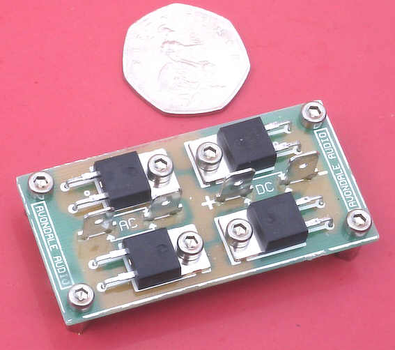

Hi All,
OK, first Kram is in for 32 FETs.
Secondly, understand that Anders cannot supply in the quantities we want. Now, what is it we need to measure on the FETs? (Noob Me! 🙄 ). ISTR that there are small testers for passive and active components (also Cat 5 cables etc). Maplin have them on offer at the moment. If this is what we need, then I may be persuaded to make the investment.... I do have a reasonable DMM, though. If this is what we need, then I will be pleased to sit and make measurements to an agreed standard and sorting model.
Finally, the bridge issue:
I have a couple of bridge PCBs from Avondale Audio
http://www.users.zetnet.co.uk/avondale/
and plan to get some more for my 8-bridge 4-channel gainclone. Now, I also have a very nice tube of 50 MUR860 diodes from my friends at OnSemi. The Avondale Bridge is described as:
FWB1 - Schottky Full Wave Bridge Rectifier
** ".....what a superb improvement for so little effort" - BL Manchester
A jolly quick amplifier upgrade indeed
Comprises 4 x 20A @ 200V Dual Schottky Diodes, with non - ferrous fixings - overall size 68mm X 33mm
Drop one into your power amplifier or pre-amp for an instant upgrade. All 'push on' connectors.
Ready built Price: £22.00 - Bare Silk Screened PCB: £4.50
As you see, it's not too expensive. I will call Len and see if there is a price break - if there is enough interest. Perhaps less hassle than making out own board, but we could customise it with heatsinks, more space etc........... Anyway, here's a pic:
http://www.users.zetnet.co.uk/avondale/Bridge.jpg
Looks nice, n'est-ce pas? I can vouch for the quality. Len can supply the 3mm hex-head fixings, but I found stainless equivalents at my local fastener suppliers. I could make up fastener kits if anyone wants. Or, if we do our own board, I could put kits together............... (with or without the diodes!!).
Cheers! 😀
Jon

Bridges....
Per-Anders' bridge does look good quality, but the price is nearly seven and a half quid per board. We could get Alan Jones / Alan Sheldrake of DAU Components to help with (Fischer) sink selection if we decided to go it alone....

I'm not too sure I would trust that bridge to run with the sort of curents that will be used with this project as it is. This is mainly because of the heatsinking or lack there of, as even with a lowly 5A bias curent, with a minimum voltage drop of 0.8V (that's for a 100V schottkey, I believe this would be higher for a 200V type) you would be looking at a total of 16W from all four diodes, which is quite a lot to dissipate just by using the PCB as a sink.
I think in this case I would be far happier going for something which had individual heatsinks for each of the power devices so that they could be happily run up to or over 10A continuousley.
If I get the work I was supposed to do this afternoon finished I might try and see what I can come up with before I head off to bead. I take it people would be happy with the spade lugs for conecting, as these will allow much larger cables to be used compared to any clamp mechanism? Plus, what would people consider a reasonable total cost when the diodes and heatsinks are figured in as well? Less than £20, a bit more, or a lot less?
