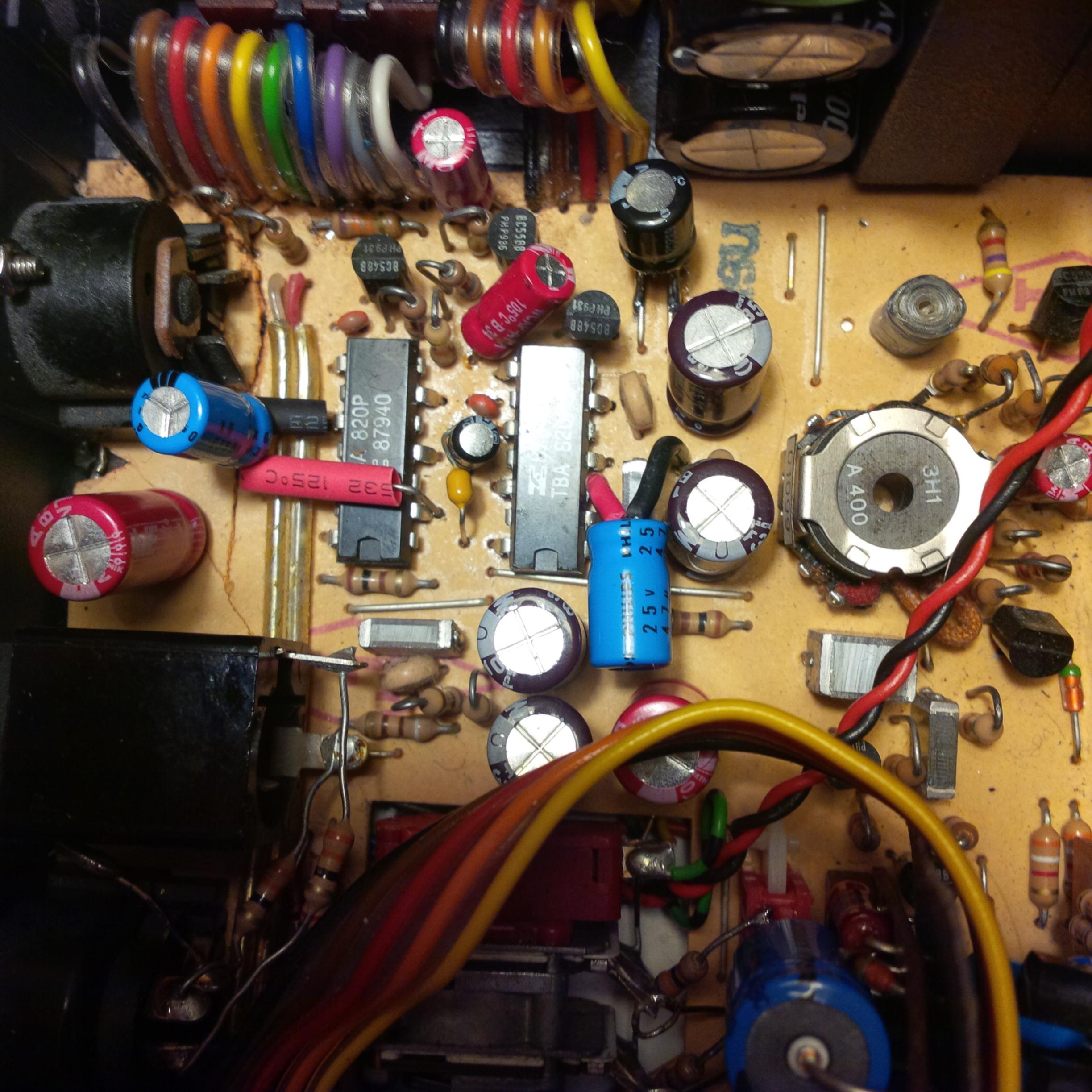

Thank you for all the help. Finally after Christmas I've got onto this and the result is that the headphone experience is much improved. The speaker output is attenuated too, but it sounds good. It's probably confirmation bias, but I was very impressed listening to it when I'd finished. The photograph shows the new resistors in place on the headphone outputs.
Now there's just some crackle occasionally from the Dolby board, which I haven't yet touched. It's either the tantalums or a dodgy connection from the board edge sockets.

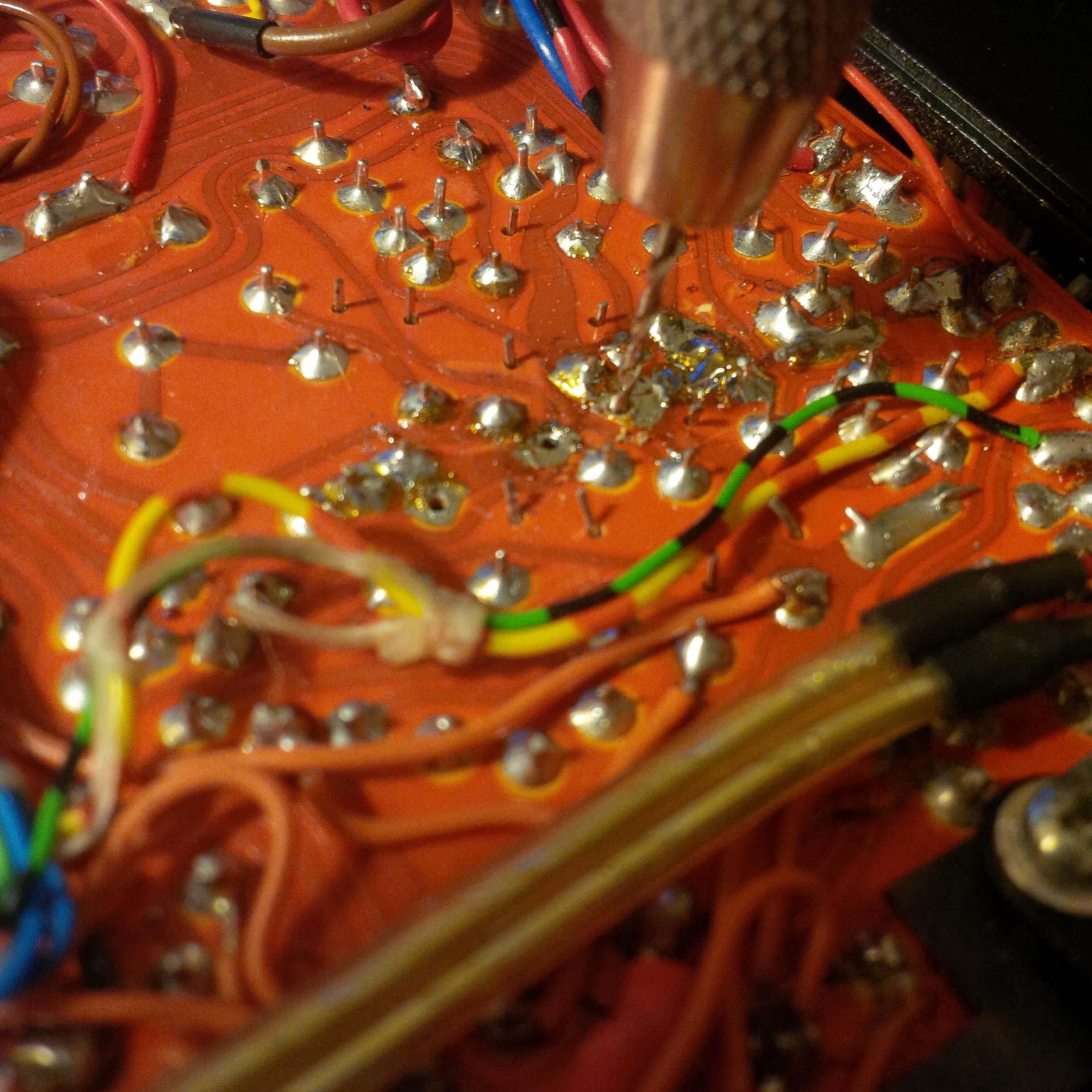

I was quite pleased how I managed to fit in the extra capacitors for the TBA820. In the pictures attached you can see I've got them away from the ICs themselves, as that is where the back of the loudspeaker sits and there's very little room above them. In fact, I think that's why there was a fire on the board, because a previous repair had allowed the 'speaker to push the previously cracked motherboard down until the solder side touched the casing. The two blue ones are "C6"; the yellow ceramic bypasses the black for RF in the centre; and the larger black one at the top right decouples the power supply which helpfully happens to be bridged to the component side at that point.
I drilled out some of the holes to allow two component legs through them - a couple of the IC pins required were unused so the legs were just in un-padded holes in the board. At the bottom of the drill photo, all those orange wires are jumpers I had to put over all the traces that were cracked when I first bought the machine...

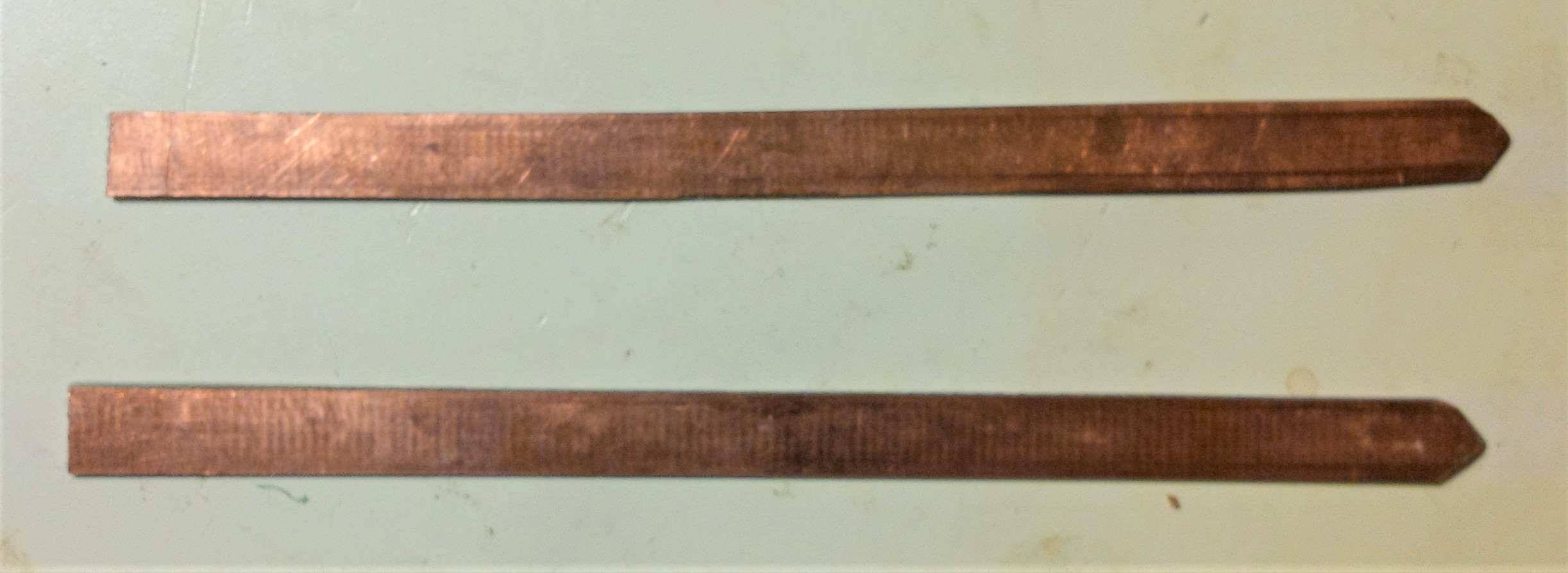

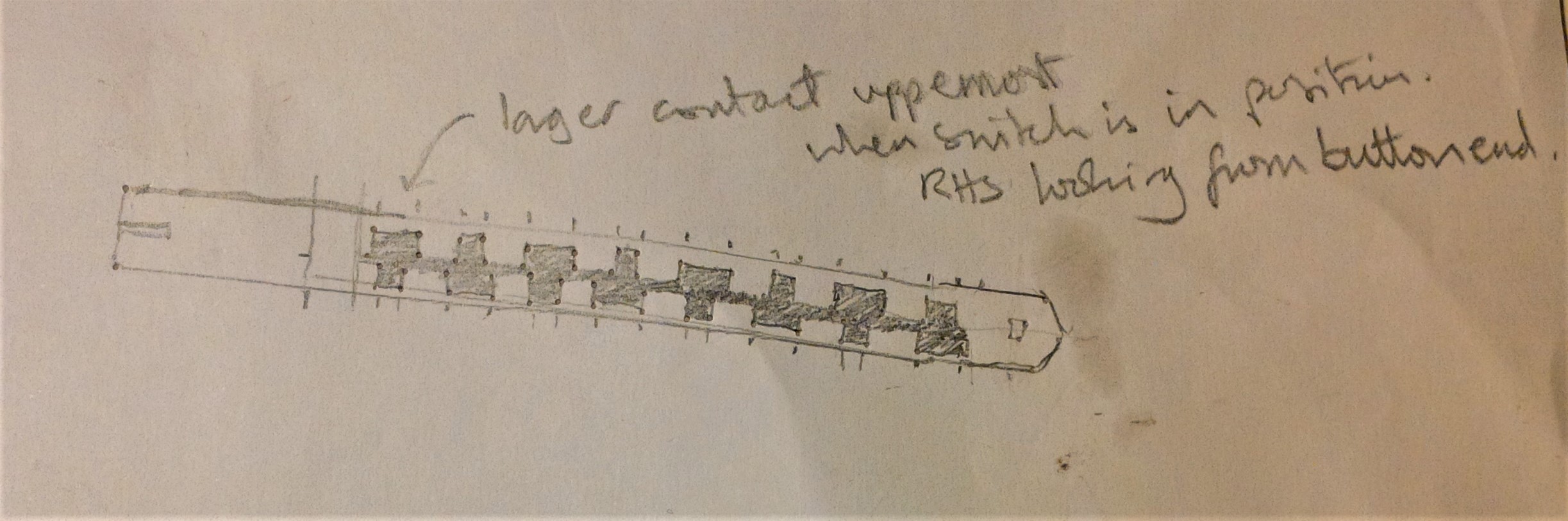

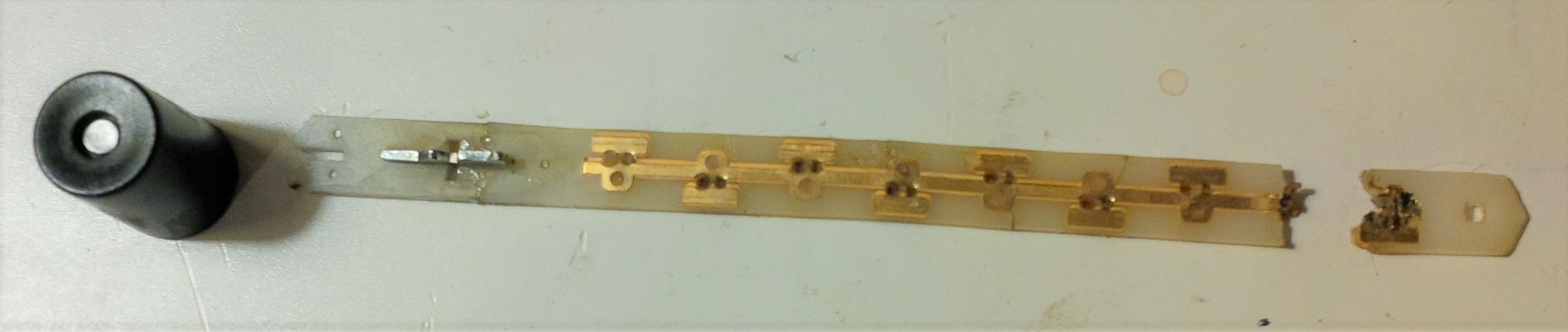

Thank you for the kind words, Colin. This machine has really been a labour of love since I got it in 2018. It came to me in a Uher Miniline set delivered via a friend in Germany as the seller wouldn't post to the UK. As mentioned, the motherboard was snapped and one of the cast case lugs which hold the bottom screws was snapped off. Araldite and jumpers carefully soldered cured that.
I hadn't used an oscilloscope before, so experimented with help from the vintage-radio UK forum and managed to learn to trace signals and interpret transistors, having only had valve experience before. The new circuit diagrams I had from SDS were a real boon as before I'd been working from the only PDF available online which was pretty low resolution, and for an earlier model with component differences.
Then there were problems with the recording signal and the record switch snapped. See photo. Unfortunately I can't find my photos of the new switch...I made a new switch from carefully copying the original onto tracing paper and making an etching templet (using callipers to measure the contact distances), which I used to etch two pieces of copper-clad board. I had some double-sided board which I had to file down to two thin pieces of single-sided which I Araldited together. I then etched a rudimentary contact shape on each side with permanent marker resist, then tidied it up with needle files while testing each contact on the switch in the two positions. I then glued in the latch from the old switch (I had to file a cavity between the two halves of the new switch) and glued on the knob. Despite all my measurements, the knob is a little proud. I'm calling that patina and aged character!

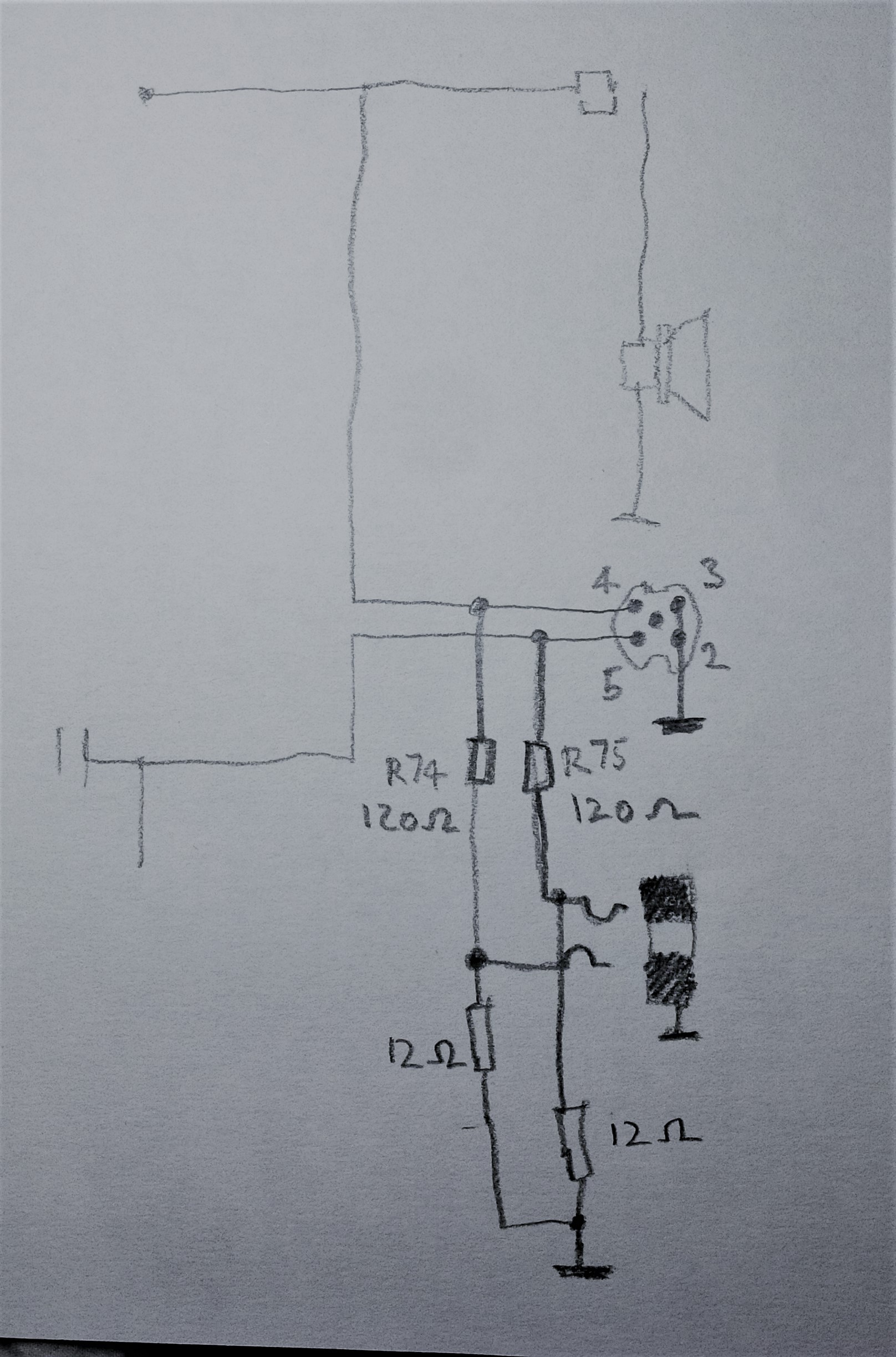

That doesn't sound right, unless you also reduced the gain. What exactly did you end up changing in the circuit aside from the capacitors?
I realised once I'd put it back together that I'd taken the potential divider from the same position rather than the headphone ground, i.e. the new resistor to ground is in parallel with the socket, with the output and both resistors meeting electrically at the same point.
Thus, with the speaker switched in, the output is still coupled to ground without headphones plugged in!
The DIN headphone out has no resistors in the original. I wonder why.
I am not sure I follow what you are saying. Each output should be seeing (R74/75 + added Rx) in parallel to the speaker, only adding some negligible extra loading.
Could you try drawing what you did into the schematic, just to see whether we agree on what is present vs. what should be?
External speaker connection, I think.
BTW, these DIN headphone jacks have one neat trick up their sleeve: Turn the plug by 180°, and you can choose between muted or non-muted speaker.
It's almost a year, but I'm still here...
I've got the Uher apart again and finally made the sketch. Funny old year, eh?
This is what I've got inside. You see the loudspeaker is always going to be coupled to ground when switched on.
