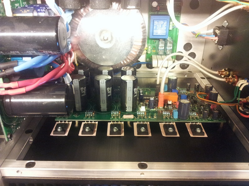

Hello,
Some time ago I finished my copy of the U.P. The pcb’s came from one of the French group buys and I followed the instructions given in the French document during the assembly.
I haven’t listen to the amp very much until recently. I took my Aleph-J and U.P to a friend over the weekend and we did a lot of A-B test. I was not really happy with the sound of the amp. Well compared to the A-J the total presentation is brighter and thinner. The soundstage is not as big and it’s difficult to pinpoint instruments and musicians.
During the this tests we switched between two types of speakers. One regular 2-way box spkr and a tangband 4” in a TL. Source was UGS pre-amp and DAC-END connected to a squeezebox.
What the amp is phenomenal at is bass. Tight, fast and with great authority.
When I assembled the amp I didn’t use the best possible matched mosfets. I bought them already matched but didn’t measure them until after I powered the amp. I measure between 0.09-0.14V across the source resistors. I didn’t match any of the transistors for the front end…
I expected the "sound" to be better then the A-J. Could the mismatched mosfets be the "problem"?

it's easy to test matching issue :
using light load ( 4" tangband) ,try with disconnected (pulled from circ , easiest with desoldering one end of source and one end of gate resistor per mosfet) all but one output mosfet per quadrant (so having just 4 per channel) ....... if sound is the same , regarding mid and highs , matching isn't problem
however - generally speaking for amp , be sure that you're having all operating points exactly where they need to be ( currents , voltages)

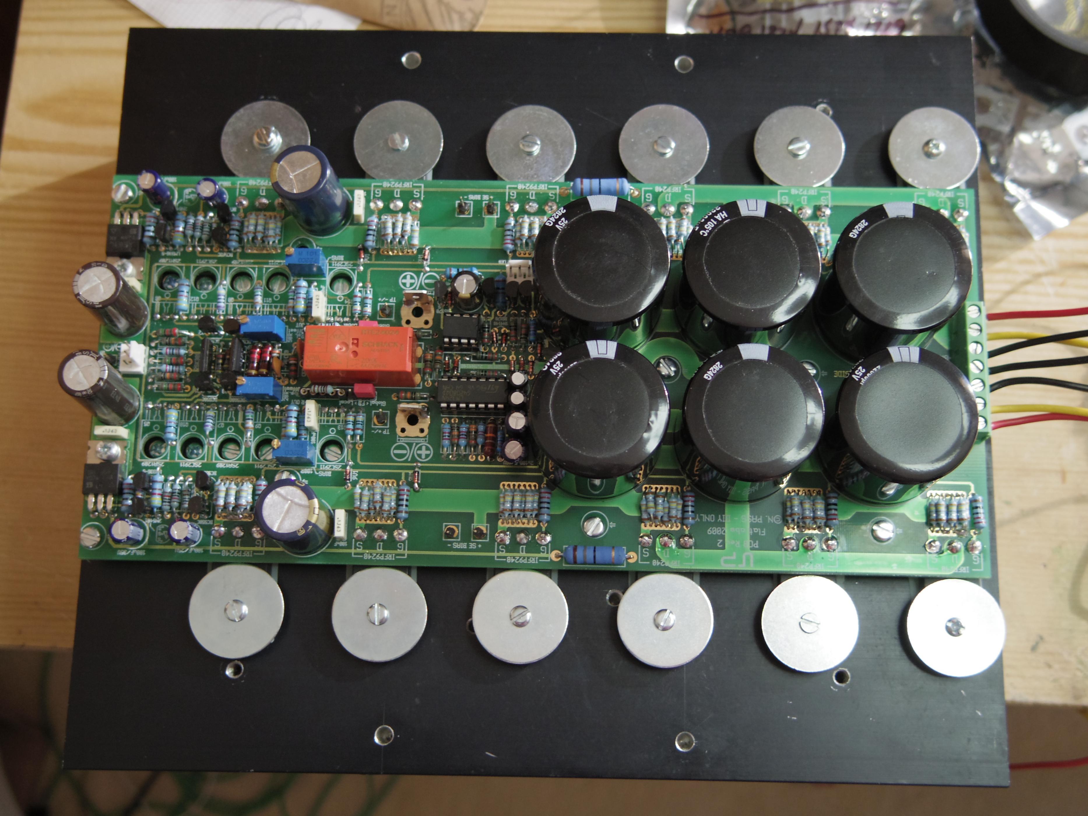

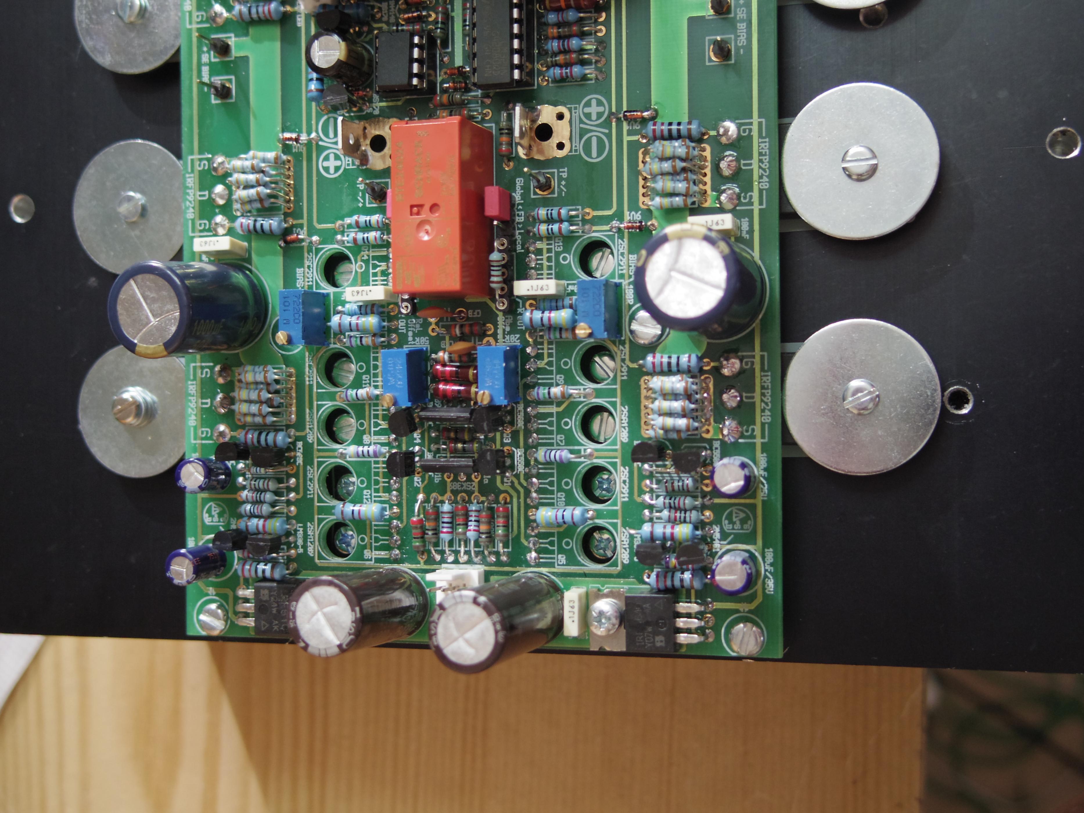

Hi everyone,
I have just put together one channel of UP but have hit a snag and need help. I have carefully followed the manual v2. Everything was going according to spec until I installed the 22000 caps and output devices. On power up, the manual says to check voltage va where I should be getting 24v. I did so up to this point, however now I'm only getting about 9v! Is there a likely cause?
Your help would be very much appreciated
I should point out that I have used some substitute parts:
KSC3503
KSA1381
FQA16N25C
FQA12P20
But these are all pin compatible.
