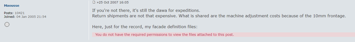

Ah... it's maybe a problem on my side then. I added this file for all of you to be able to download it.
It is on my Google drive, you cannot download it? If not I will need to arrange something else for the sharing, I thought Google will allow this.

It is the design file for the rear panel.
Let me just share the 2 minor issues I experienced when I mounted first time the rear panel (was for an UGS all inclusive so almost 10 years ago !).
a) The holes for the RCA connectors were a little too big for the REAN/Neutrik version of the BOM. If using these, you need 10mm diameter instead of 11.5mm as currently drawn.
b) The DB15 opening was slightly too small in the direction of the fixing holes so end up having to slightly file the cut-out to enlarge it.
If it can help, I just tentatively corrected these 2 points in this attached version.
Remark: for the DB15, I used the standard macro provided by the front designer tool with adding 2 blind holes 2mm deep, 6mm diameter on top of the fixing holes. This is to compensate for the 3mm thickness of the panel when using hex jack screw terminals.
  • Face_Arriere_Maousse_mod.zip
