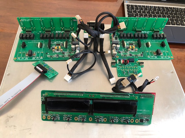

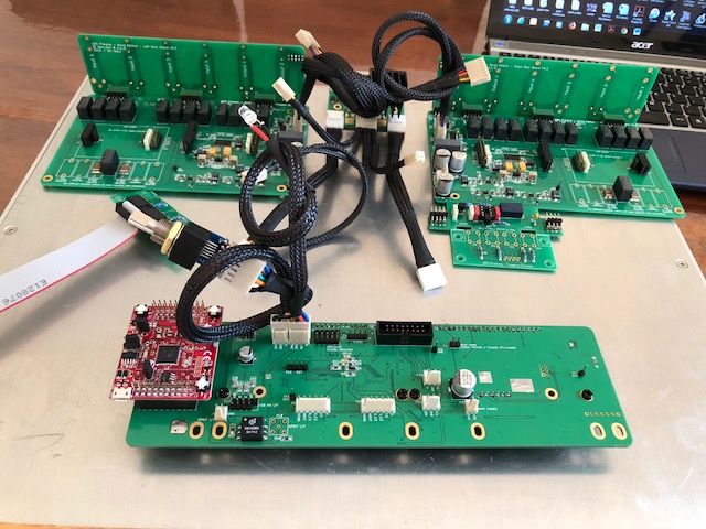

Hi Alex_Taiwan, i am almost done on all the boards, i would like to ask how to configure or enable the HS USB and WIFI option. i have already fixed all the components for those options even the digital in/out are all on the uC board. attached are the pictures of my build.

Hello Marjohn,
Congratulations for the nice work.
These features are useless for the UGS Muse and were added to make this board a bit more generic and in case I use it in other applications where digital audio and streaming make sense like for a DAC.
So unfortunately I am not going to develop the firmware here to support WiFi and USB.
Alex.
