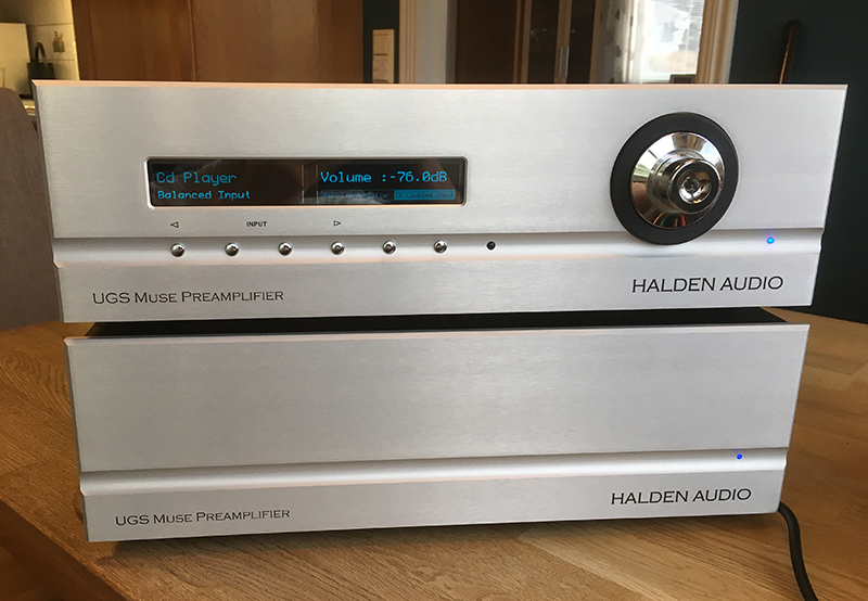

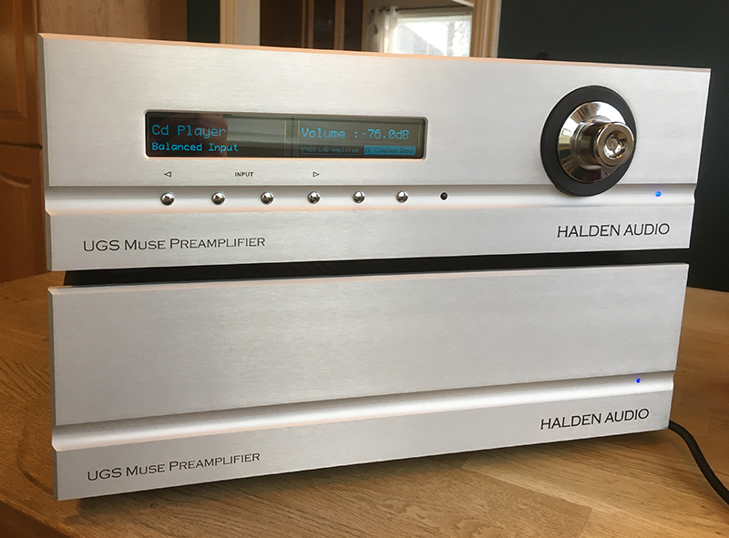

@alex_twn
Any chances to develop your project further?
I even not dream of additional HW and support for DAC, wifi etc but just small tweaking to display layout to make better visible from the distance and balance display is what I would appreciate.

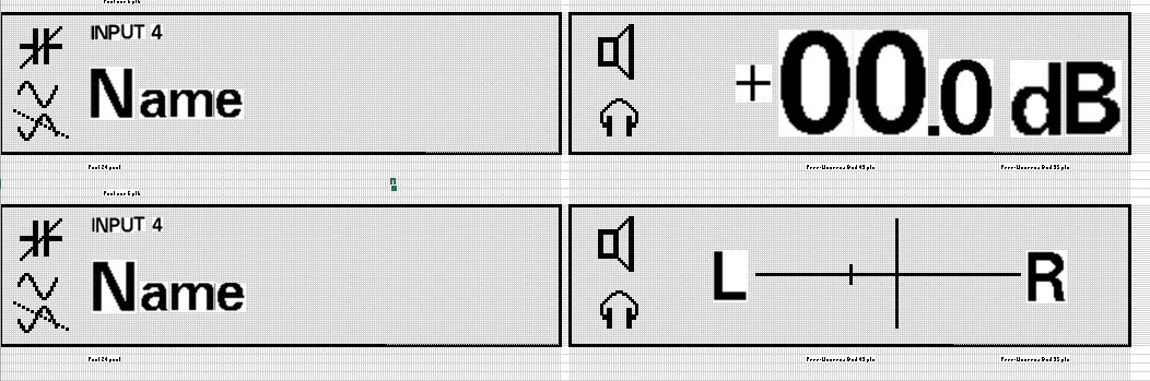

Alex,
I made some sketches of proposition of new layout of the displays for dual OLED ( I believe that this option is mostly used). I got 2 ideas in my mind doing this:
- better visibility from the distance
- we do have graphical displays so maybe we can use some graphical symbols instead of text🙂
Following your suggestion I pick some standard fonts from u8glib library and all graphical symbols are being proposed in the places which do not change rapidly so performance of loading bitmaps should not be an issue.
This is only a proposition, I am just throwing idea to discuss and explore 🙂

Thanks Jacek,
This is nice from you and I believe you must have spend some time to draw this excel.
I'll look at this carefully.
I think I will first implement the balance in a graphic way with the current GFX layout as several person are pushing then I will look at how to integrate more graphic elements as you show here.

Hello,
I implemented the balance as requested.
Now you have a visualization on the display of the balance value at each press on the remote control.
After a short time the display gets back to main volume display.
This is v2.92 of the FW that I need to upload, not done yet as I plan to optimize some SPI routine with DMA control (stuff that I did on my new DAC project using the same controller but not yet back ported on the Muse).
Alex.
