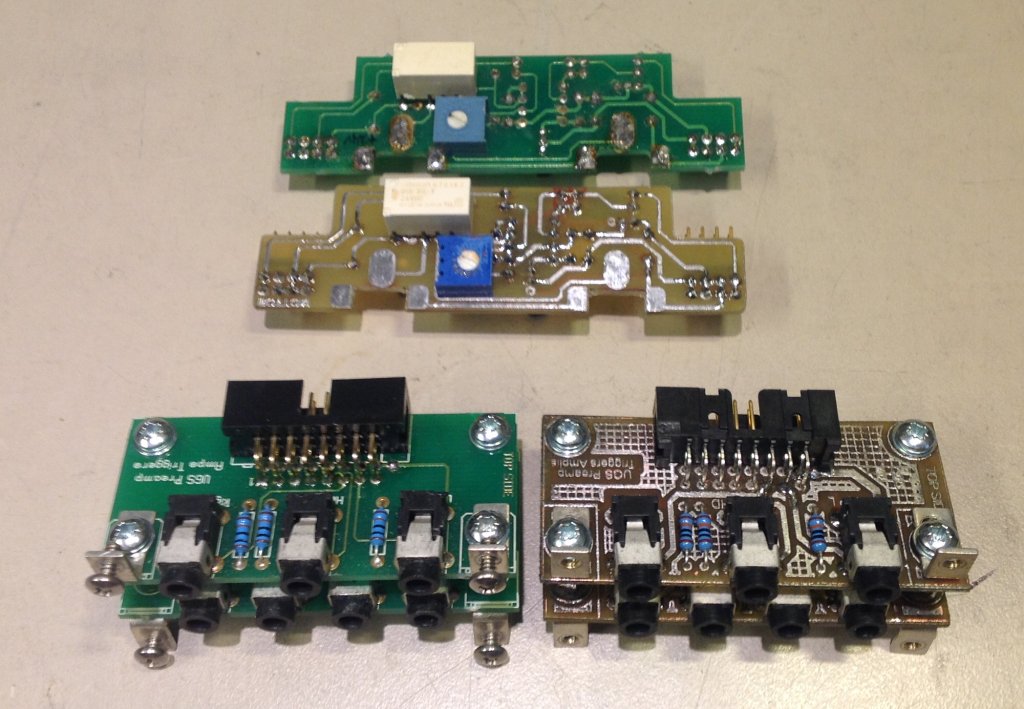

I sold my triggers and Sub PCB with a complete UGS ''All-Inclusive'' kit that I had extra. Since this new UGS preamp is using the same little PCB, I had to make a set for me, by hand. Here the result compare to the original. I installed the new ones into my wife ''All-Inclusive'' and I kept the original for the Muse-UGS 😉
Now I'm starting the others pcb assembly.
