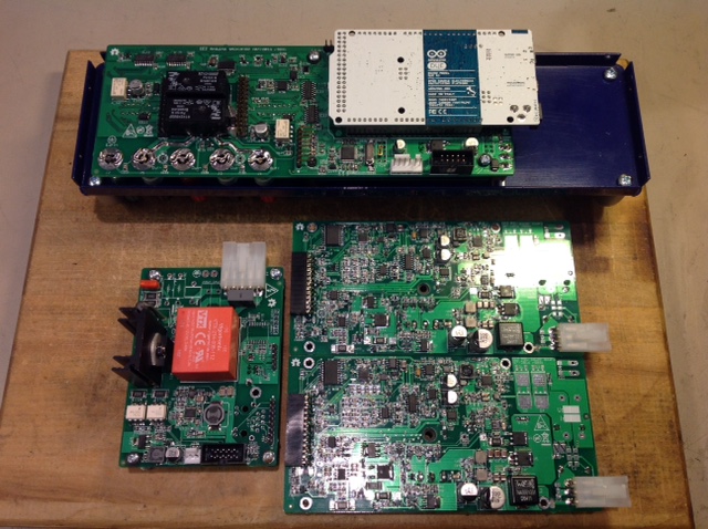

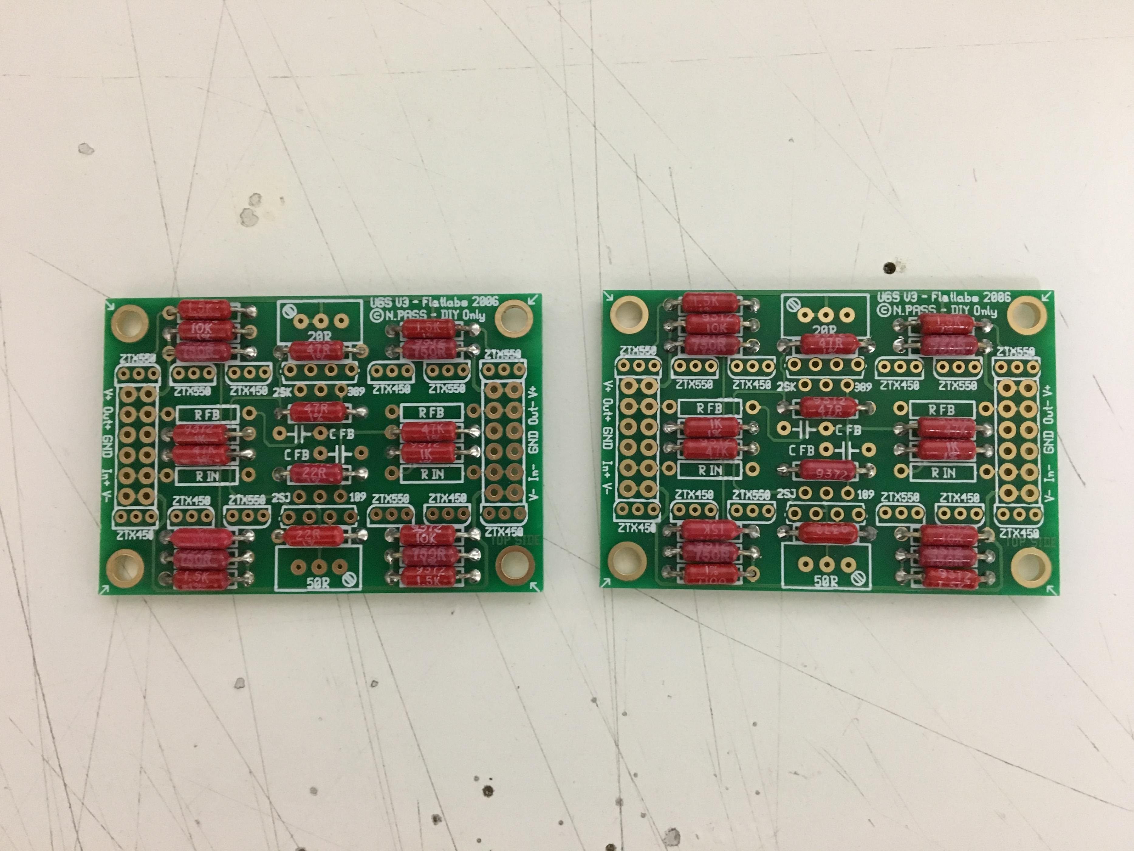

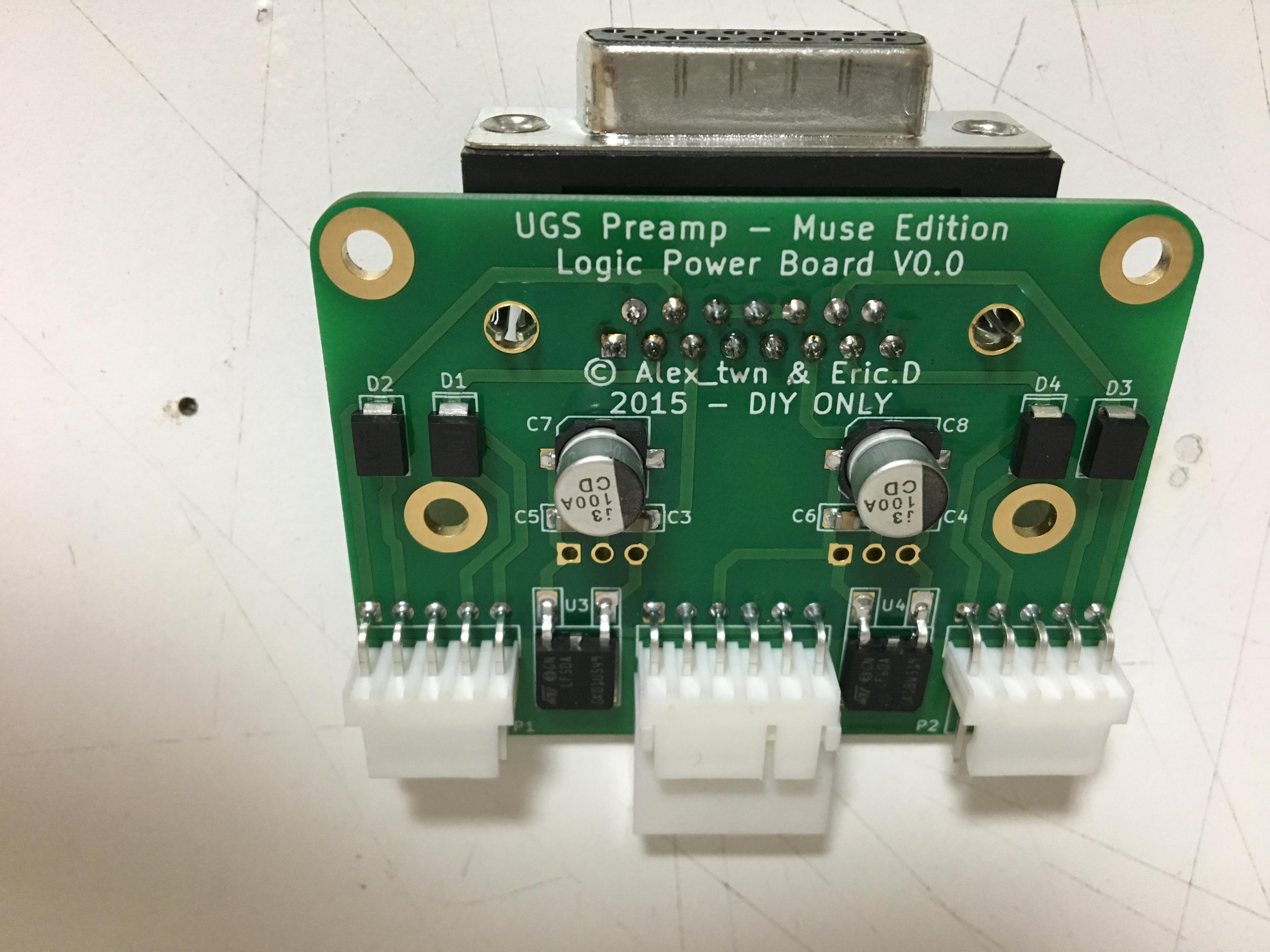

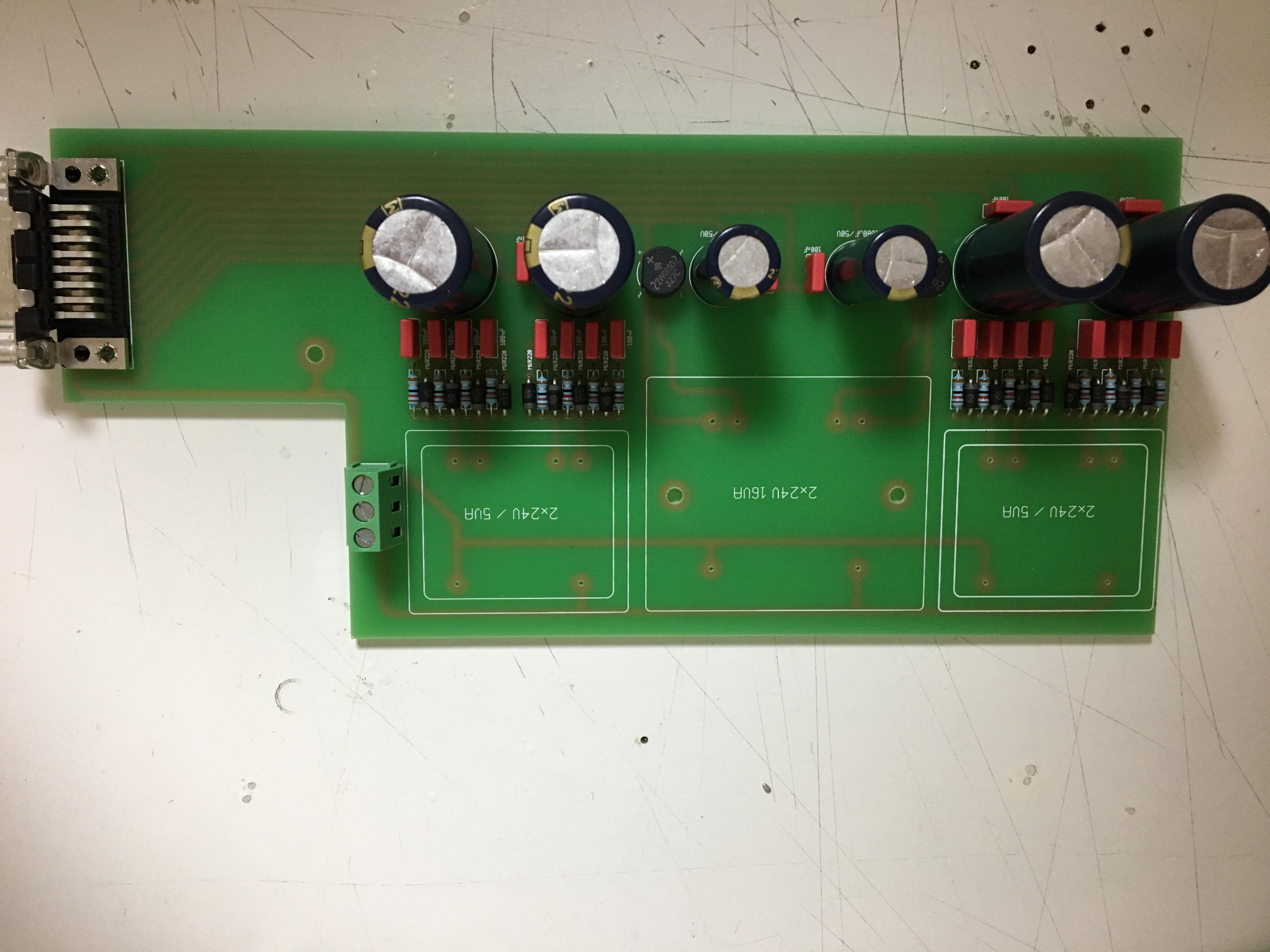

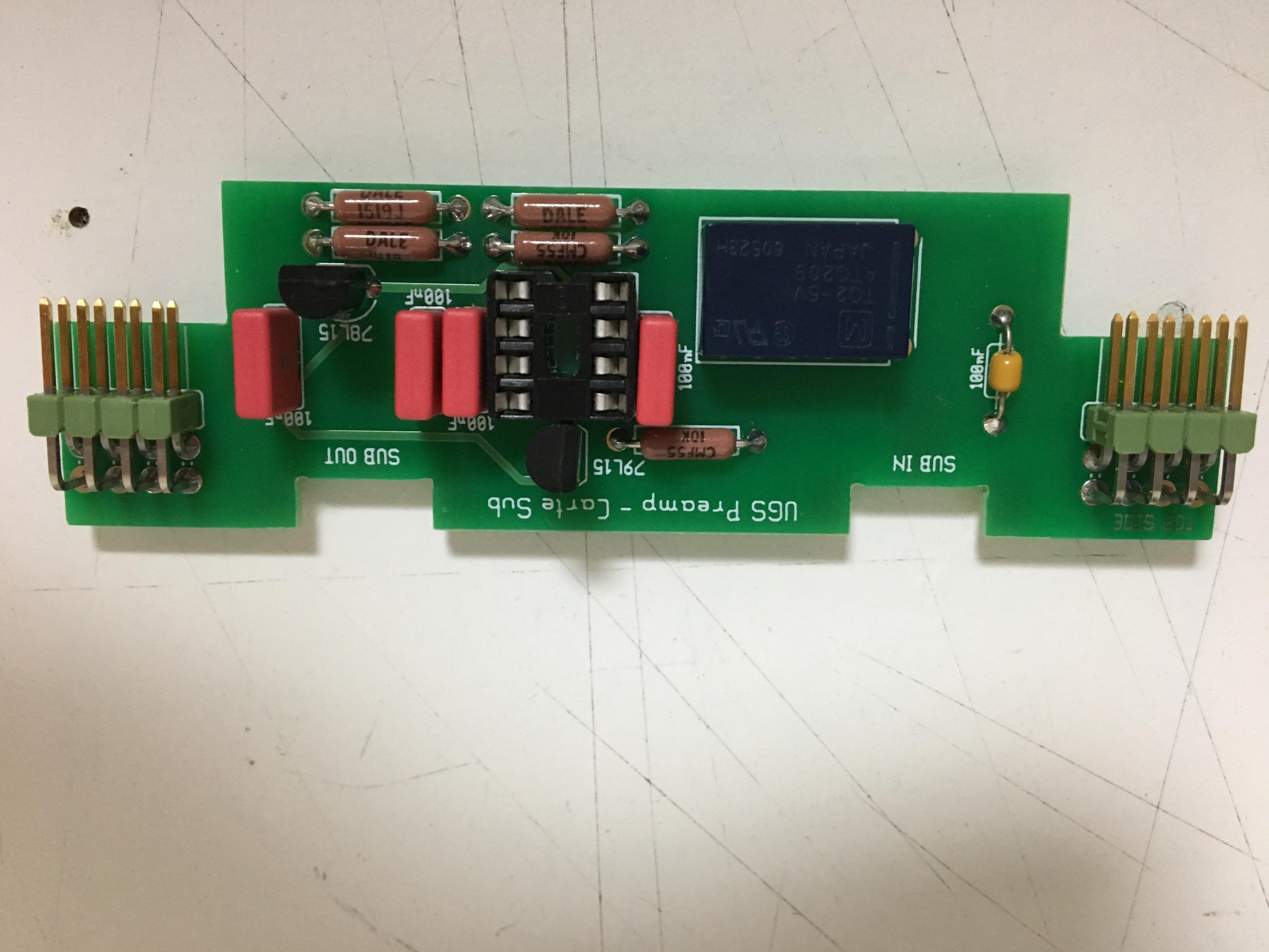

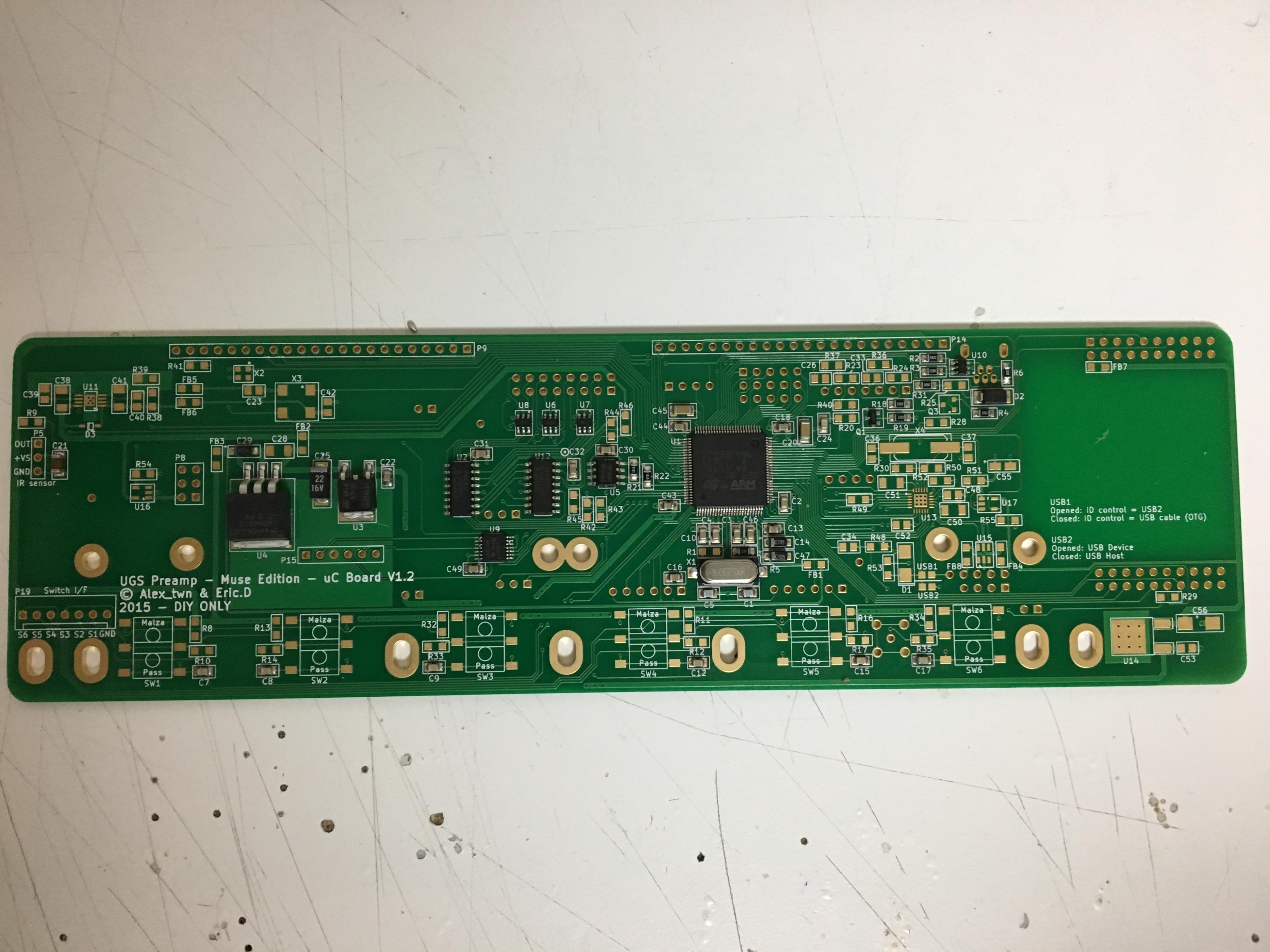

Recently I get a full set of pcbs for this preampli in the swap meet.
Take me long time to read (thanks to my old scholastic Francais) the long HFCR thread.
I am really impressed for the quality of this project and the enormous work and relevant documentation done by Alex and Eric.
I bought already almost all the parts, waiting for the 2SK389 and some other few to proceed. Will be a long term project also due to my short time available between family and work and time to time I will ask your help 🙂

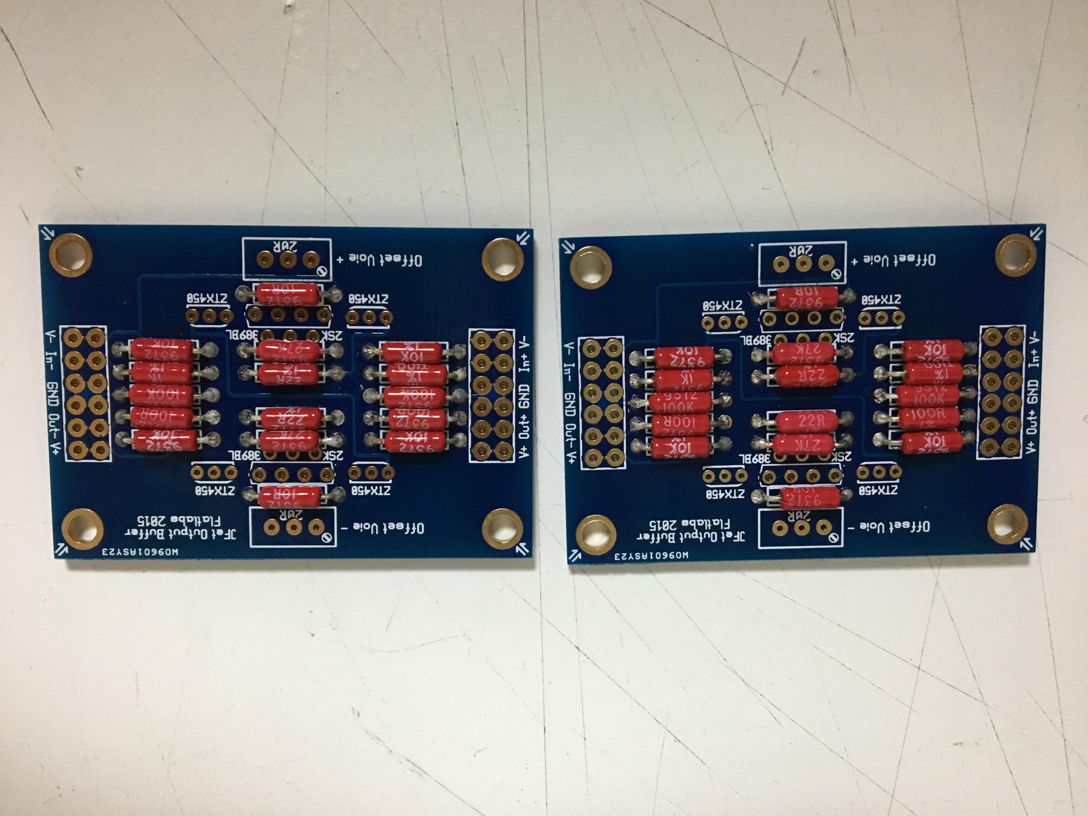

Attached are few pictures of the work in progress. I downloaded the gerber file for the buffer boards (blue boards in the pics)
I ordered the rear panel from Frontpanel (thanks for the file) and I started also the design of the front panel.
I need some help about the 6 push button. I can't find them anywhere and probably I will ask to Frontpanel if they can do them but before I would like to know if someone can address me to get them already done. Until I don't solve this part I can't proceed with the design... any suggestion is welcome.

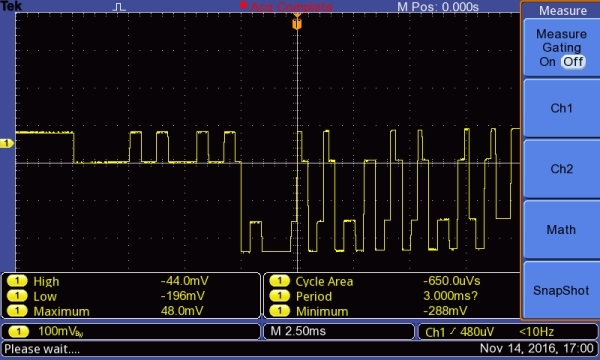

As per schematic the output of IR is directly connected to the pin 90 of the chip. I checked with the scope and the signal is there when I push the remote.
My feeling is that I miss something in the first setup. I have a Sony RMT-B104P remote that is programmable. I choose the NEC configuration but no way to male it work.
When I enter in the setup menu the program ask me to press two times the button to save the command but I didn't received any confirmation back. It's that correct?
When I exit from the setup no one of the command is working...
There is anyone that can kindly help me to solve the issue?

This is strange... If you see the signal toggling on the pin and that the code is NEC or RC5 then the MCU should decode it unless the the remote control support is disabled in the program.
Can you send me a screenshot of what you are capturing on the IR sensor pin?
Just to be sure that the waveform is what I am decoding.
Would be nice as well that you measure the timings, there are plenty of PDF on the web that explains the RC5 or NEC timing, you can then make a direct comparison.

Here is the print screen captured by the scope.
To me looks fine but it is the first time that I have problems with the remote control and I have no experience.

Hi Enrico,
The waveform is terrible !! 😱
Also I am not sure to understand the scale of the scope...
Anyway the signal is going negative, it is all wrong, it will never work like this.
My only thinking here is, are you using the right IR sensor / correct Vcc - Out - GND connections? Some have a different pinout...
It should look like this (in an inverted manner, but I take care of this in the SW) => NEC Infrared Transmission Protocol | Online Documentation for Altium Products and between 0 and 3.3V...
Hi Alex,
The IR sensor is the TSOP2436. I already checked the datasheet and the pinout is correct and the IR is installed in the correct side
Thanks for the link... I just back home and I still don't have the time to search in internet as you suggest me before
Can be that being the remote programmable I choose a "wrong" coding?
I will try to setup again the remote control. With the scope connected I should found a proper wave?...
Hi Enrico,
I don't think that the remote is wrongly programmed, the waverform seems correct at the beginning but the levels are very low and then it becomes wrong.
Are you sure that R9 is 100Ohms?
Yes scope connected you should see what I put in the link.
