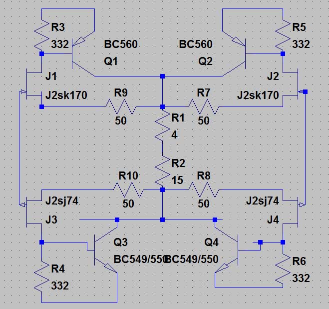

Finally, after some four years, I stuff my ugs boards
I spiced it, and played around a bit. Did anyone try to hold the fets on constant current by the use of bjt of opposite polarity clamped around it?
My sim shows a decrease in distortion roughly by ten times!
Rüdiger
Rüdiger
Lower distortion
........ would be interesting for me too, UGS lies in the corner. Could be a revival!
