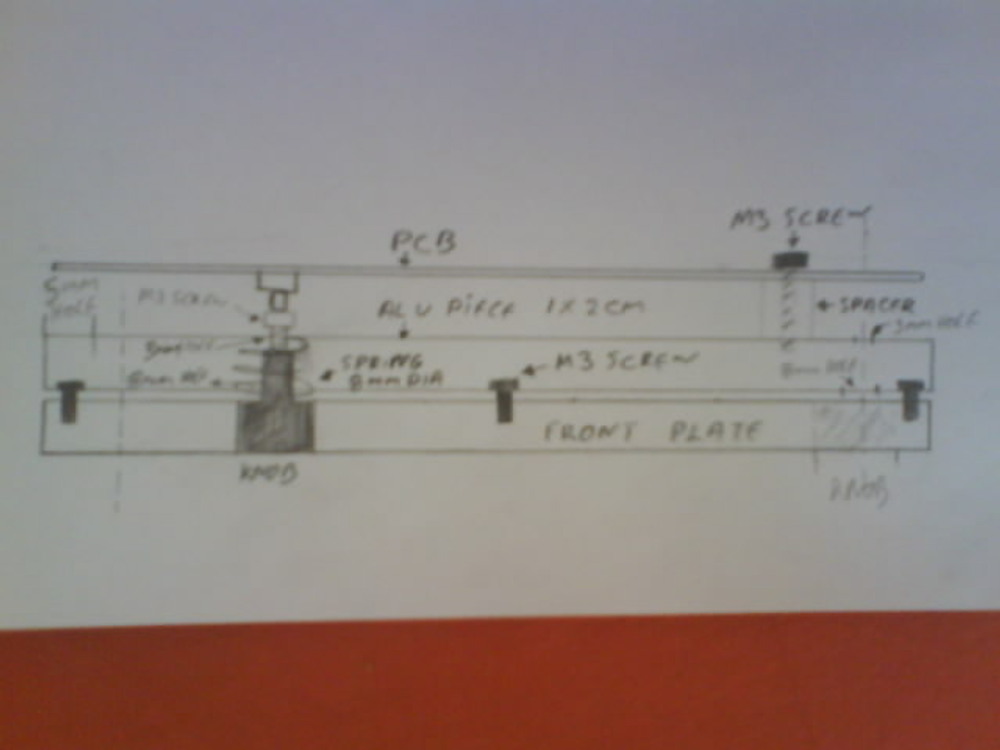

Manu,
a length of rectangular nylon bar reduces friction/wear of the buitoni, plus minimal tolerances.
Merely requires drilling the holies in 3 diameters of different depth.
(drill bit with a broken-off tip to flatten out the bottom of the holes)

Thx
Seems faisable, even for me...
I have already metall drill bits with flat ends ... they will fit perfectly ...
hehe .. no need to wait till I broke a bit inadvertently, as usual 😀

Welcome.
About the knobs take a look in your local store maybe you will find even better if not email me.

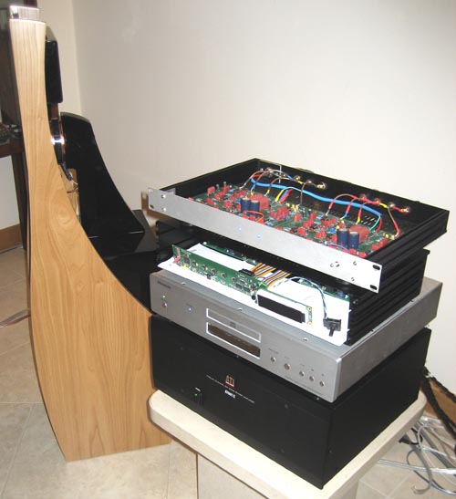

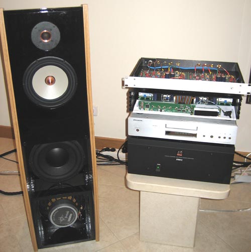

...for the galery, from the promised foto session!
Finally got everything working;
Orion ASP - with temporary front panel.
UGS - sans front plate and testing the display 1.
Shanling - waiting for my own transport....another thread in these pages.
ATI 6012 - 8x Orion amps....with 4 spare.
the sound is amazing !
Thanks to Nelson Pass, François, Vmoreau for the GB and SL for the sharp end !
....now to spend some time with my CNC to make the front panels with the care such a system deserves.

Very nice set-up!
Could you tell a little more about your speakers? If cheff don't mind...
Are you happy with shanling? (Tube output, not?)
