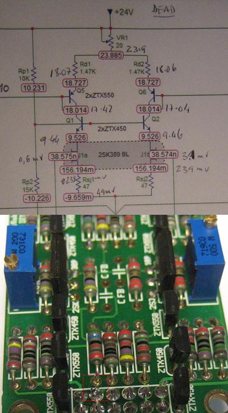

Ok i promised some pictures today, so here goes;
Solved the "dud" issue.
After measuring the whole board it became quite clear something odd was going on arround the K389.
Taking a closer look at what i thought i had looked at many times, i saw that there was a cut track connecting the fb resistor to the connector.
Fixed that, tested and put it playing after aligning the offsets....it sings.
This just goes to show that one can look and not see what is in front of us .

Hi, glad you've made it.
Nice work 🙂
So it was the PCB...
I'm so confident in PCBmakers that I don't think about testing the fab quality
Where do your PCBs come from? Is it the last french GB?
Nice work 🙂
Thanks for reporting.
And thanks for having had this issue 😀 - so to speak ...
Half serious : Its always very interesting ... Thats sharing experiences ... which is precious.
I suppose you did the first tests with the FB res not implemented. And all readings were OK. So you couldn't see the problem.
So I think it could be usefull in the future to test the boards a 2nd time with the FB res in to be sure...

Hi Manu,
Yes the document published by François is very thourough but as he states near the end...it does not cover everything.
The feedback resistor is only put in at the end before offset adjustment, odd thing with this board was that the offsets adjusted ok before but what was clear after a complete check on all the bias points was that the gate values were crazy.
This is the clearest sign that the feedback resistor was not ok but this was a test that was not included in the paper...we can include it now i guess 😉
Now i will try to debug the other board, wich plays but does not adjust absolute offset.
