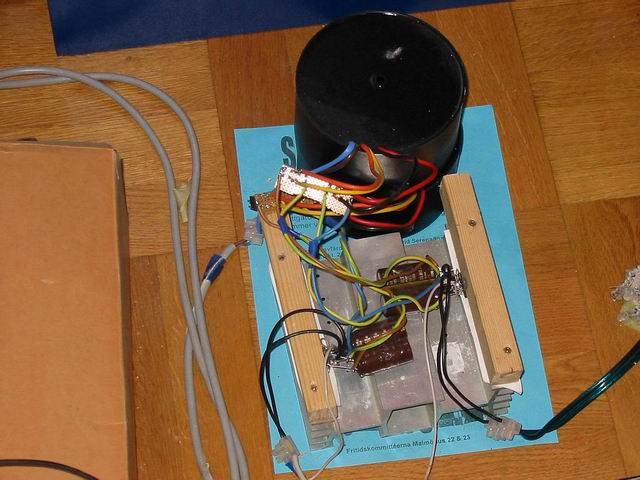

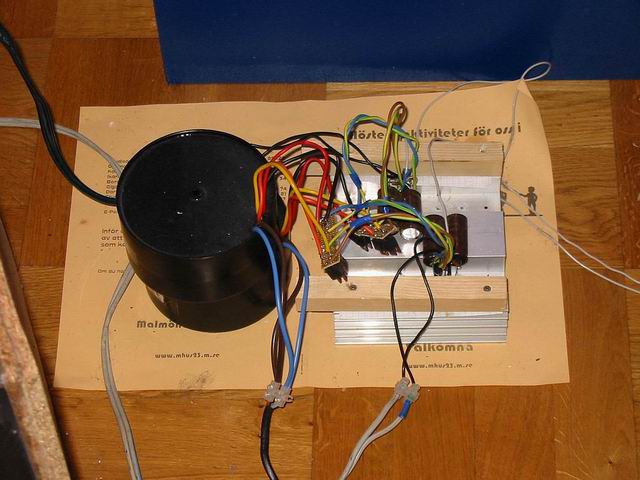

Here is my current amps.
4 Gainclones using lm3886 each with 2 x 1000 uf silmic and 300 VA 25V AC.
The small prints hold a double bridge mur860 for each channel.
Isolation pads are to layers of normal paper. And it kinda of works, the heatsinks can actualy get a little warm.
Note that the amp is place on a sheet of paper to make it more moveable.
Left channel:

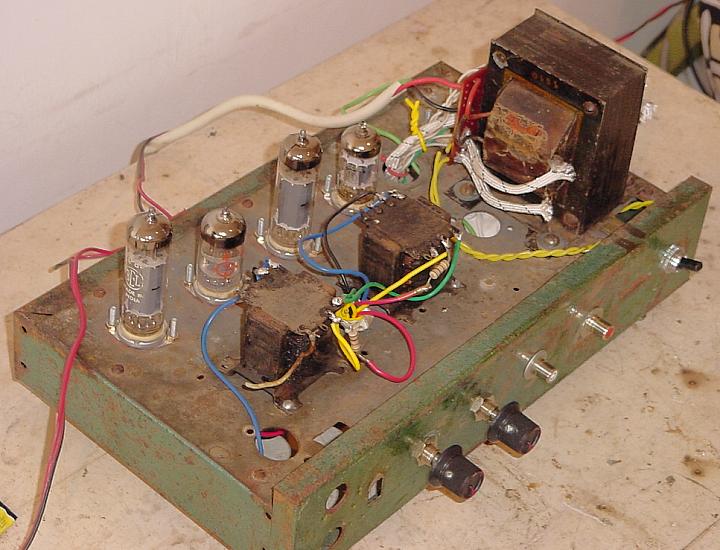

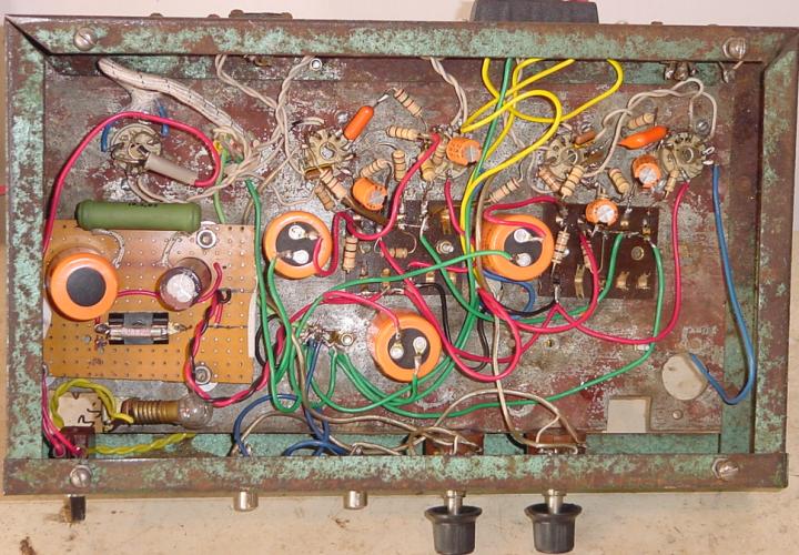

This gotta win the most ugly amp award here. 😎 A 6BQ5 affair which sounds heavenly. Spent very little money - mostly on the passive components. Everything else was salvaged. Working fine even now.

Yup, it's ugly. Don't change it a bit.
Have you got a 6BQ5 amp schematic that you could post?

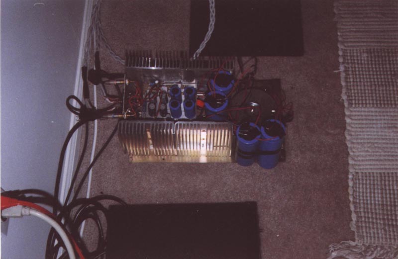

2x LM3886 running -+30volt rails from a switch mode power supply. The power supply is a hybrid of the two supplys on www.sound.au.com and some stuff from the data sheet.
The vast majority of the parts came either from the amp that once inhabited the chassis or from old monitors...TVs...etc. Got to love good ol student engineering.
works though and is only used on the midbasses in my car.

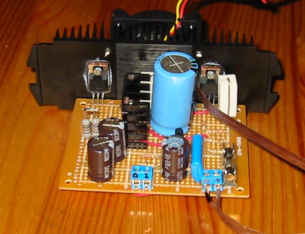

Look, it's almost as nice as Peter Daniel's work ... ok, maybe not 😀. I just made this as a prototype for a case I hope to make in aluminium for the little amp. Topic here.

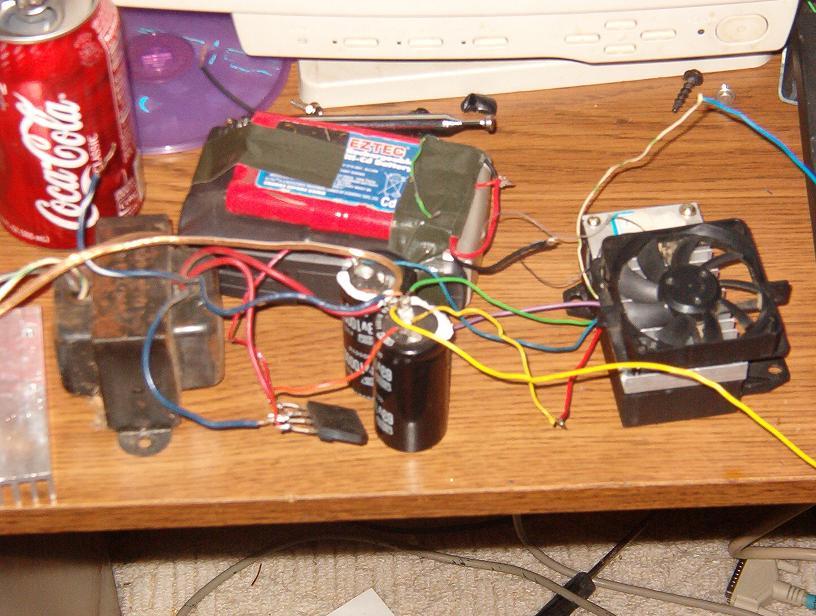

here is my ugly amp.
i used a box from an old scooter speed controller.
I put the coke can there for size comparison, and the pocket TV has a battery pack taped to it, that powers the old PS2 cooling fan.
it was going to be a briged lm3886, but its now a single lm3886, because my second chip, I had to run wires from the chip to the perfboard, and the pins 1 through 11, I had backwards!!!
pin 1 was pin 11, and pin 2 was pin 10, and so on so on,
oops. the chip got really really hot, and didnt smell good.
i pulled it out, and put the other one in place of it, soldering the wires on the right way this time. it worked.
im afraid to try that chip again, i think overture and spike didnt save this one!. its prolly dead.
