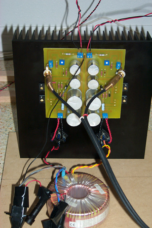

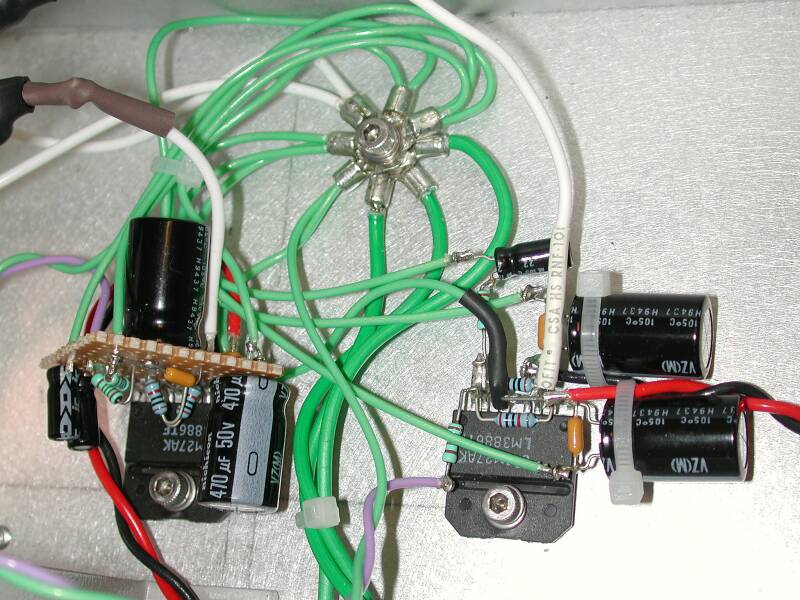

Here's the two amps and star ground.

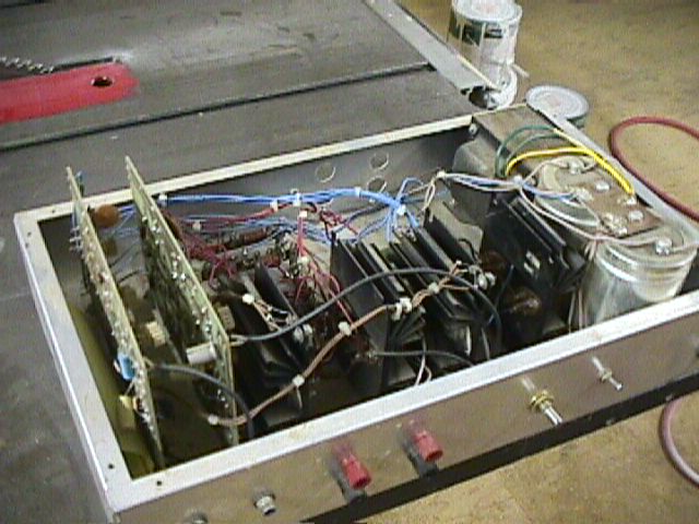

MRehorst Scrapyard Boxed Amp
MRehorst:

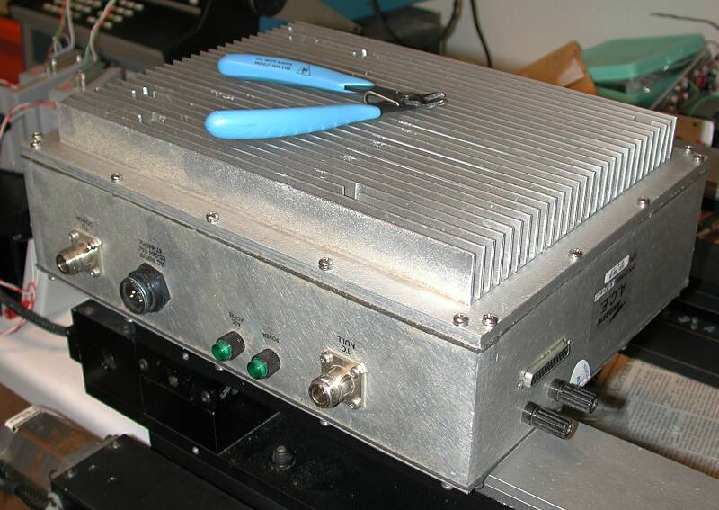

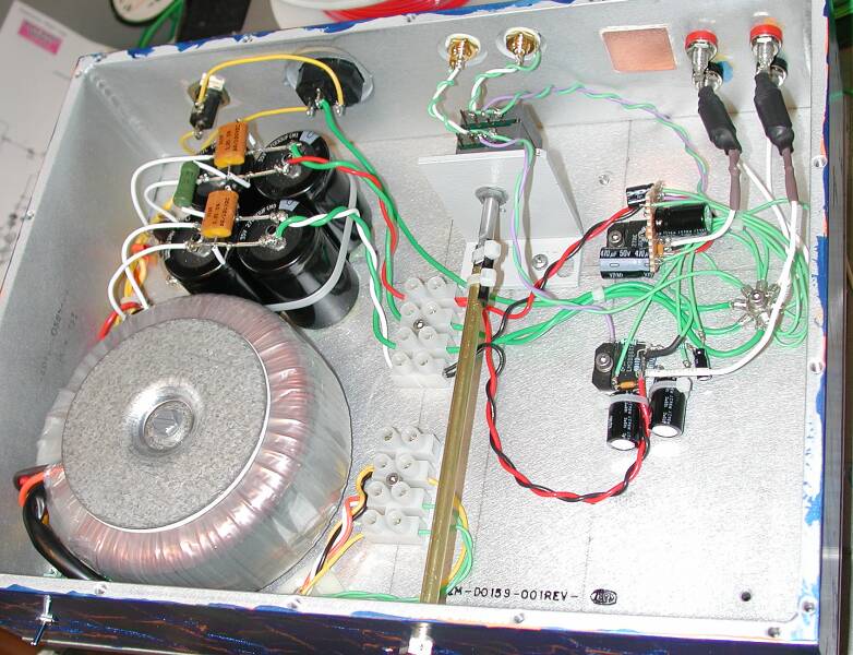

Here's my ugly amp, built into a box I picked up at a local scrap yard. The box is from a cellular phone base station diversity antenna amplifier (I think). It is 13" x 5" x 10". The walls and the base of the heat sink are 1/4" thick. The fins are about 1" high by 11.5" long.
I was able to use some of the existing holes in the box to mount the line cord socket, the fuse holder, and the input jacks. I filled the remaining holes with bondo, then drilled a few holes of my own for the power switch, volume control, and output jacks.
The nice thing about this box, besides the good size, massive amount of heatsinking, and ultra low price ($15) is that the walls are a separate piece from the top and bottom covers. To build the amp, I mounted everything on the heatsink (top cover), wired it up, tested it, then simply wired the connectors that were mounted on the walls.

This amp sounds pretty good, as I expected (it was designed by engineers, after all). No hum. No noise. No turn-on or turn-off thumps. It just starts playing when I turn it on and stops about 5 sec after I turn it off. After playing loudly for about an hour, my hand can just barely detect a slight temperature rise on the heat sink fins.

Yes, it was cheap! I used standard 1% metal film resistors made by an unknown manufacturer. I think they cost me about 2 cents each, but I bought them in bulk a long time ago so I'm not sure. I did match them with my meter to insure equal gain in the two channels (though this was really overkill).
I used two bridge rectifiers because I had a pair of them in stock. I don't know the type or specs on them, but they turn AC into DC. I bypassed all four diodes with some 10 nF ceramic caps. I used a set of four 27,000 uF 35V caps that were available locally, and bypassed them with a pair of 1 uF polyester film caps. I put a 3.3K resistor across the supply to bleed the caps down to nearly zero within a few minutes of powering the amp off.
Most of the wire is silver plated copper with teflon insulation. I didn't use it because it "sounds" good. I used it because I have a lot of it which I purchased in bulk when I finally got tired of cheesy PVC insulation melting everytime I soldered a wire. The teflon stuff can take a lot of heat before it melts.
I tried using a triac to switch power but found that it caused the transformer to buzz, so I pulled it out and just wired the switch directly.
The output jacks are banana jacks chosen because the bolt that secures them is metal, not plastic, and because banana jacks are GREAT, low resistance speaker connectors. I think they are nickel plated, but I'm not sure. It doesn't matter. I spaced them so I could use double banana plugs on the cable ends.
The input jacks are very PC gold-plated, teflon insulated things that I bought in bulk in Japan for about $1 each a few years ago. The ground side of the jacks are insulated from the chassis and connect to the chassis only at the star ground point.
The volume pot is a detented dual 20K thing made by Noble. I got it in Japan for a few bucks several years ago. The two sections seem to track well which is good because I don't have a balance control. I hate mechanical pots and will replace this one with an electronic attenuator when I get around to it.
Let's see, box $15, xfmr $25, filter caps $10, I/O connectors $5, volume pot $5, misc. $20. About $80 in parts, total.
I didn't use any coupling caps, which is not a real safe way to do things, but my middle name is "dangerous". I don't recommend such a set up because any DC that shows up at the amplifier input will be amplified and sent to the speaker. Speakers don't like much DC for very long. I'll be adding coupling caps in the not too distant future.

I don't think so. This is one of those things that I don't have to try to know if it works well. I know that the effect of removing the caps will be to increase the ripple on the supply and reduce the average supply voltage and thus the available power output. Increased ripple and lower power output are not advantages, in my humble opinion.

That would mean removing the 18 screws that hold the bottom cover on. Maybe in a week or two, when I've prepared a proper circuit board to replace the shabby wiring around the amps.
