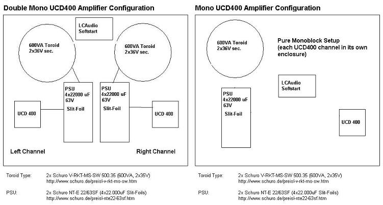

My UCD400 setup
Hello folks,
While I'm waiting for my UCD400s with OPamp 6820
upgrade, I want to share my setup ideas with you
so others may benefit when building an UCD400 amp!
I plan to build either a monoblock (two enclosures)
or a double mono configuration (single enclosure).
My drawing contains details and the part list.
Hope you like it!
Michael

How does the sound change with the supply voltage ? I only need about 50 w for a midbass horn so a lower voltage could be used. Any advantages ?
It was covered a little on the UCD180 thread. Basically, the opinion was that this module plays best with a decent powersupply. Lowering the supply voltage, only has a minor decrease in the idle consumption, and the amp is 95% efficient when running.
So basically, put in a reasonable size powersupply even if you won't need a lot of watts
(By the way, this is all heresay: I have no experience to back this up!)

Maybe I was not clear, I will use a big size supply but with a lower Voltage. Some amplifiers like the Gainclone change the sound with the voltage and maybe the UCD also will get another sound ?
According to Bruno, the UCD400 is quite insensitive to
a different voltage so long you drive them close to the
recommended specs (25V of course wouldn't make much sense)
I will try this myself when my UCDs arrive.
Michael

With a perfect +-60 VDC source it should get you 225W in 8 Ohm (right?), but with the safety margins we need to have on an unregulated powersupply so that it doesn't exceed 60 VDC we'll probably end up closer to 50 VDC and only a little more than 150 W in 8 Ohm.
Jan-Peter: How's it coming with the cap replacement and change to over-voltage protection such that we can safely use transformers with 2x40 VAC secondaries?
Right now I'm trying to decide if the UcD400 is enough or if I can wait for the UcD700 (900?) 🙂
Hansen,
All caps on the UcD are rated for 100V. When you know your mainsvoltage you can probably go safe to 2x60VDC as an unloaded voltage. In my private home the mains is quit stable and goes from 225V to 235V. Our 500VA transformer gives you 56VDC by 230V mains.
2 times 40VAC must be safe.
You can remove two protectiondiodes, so you don't have the overvoltage protection. But you must definatly add a capacitor to avoid DC coupling.
We don't recommend this, so this idees are on your own risk.
Jan-Peter
