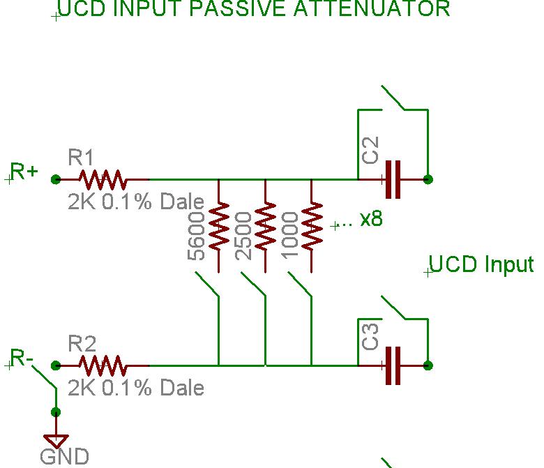

I think I have a fairly unique layout for the UCD input which allows me to use balanced & unbalanced inputs, a high quality passive attenuator driven by relays. The design goal here is to have the UCD input as high quality as possible through using as few components as possible (minimalist approach) and for those components to be as high quality as possible.
See the attached schematic:
- Negative inputs switched to gnd when using unbalanced sources
- Relays for shunt resistors driven by a microcontroller
- Input caps normally bypassed except when DC protection fired.
I'm not sure this circuit is optimal, as it might be better to bypass the negative input series resistor when using unbalanced sources (to reference the input source gnd not the amp gnd which this schematic currently does) and switching logic is needed so that the negative input cap is bypassed when using unbalanced sources. Or even better, bypass the negative series resistor and the negative input cap together when using unbalanced then the attenuation shunt to source gnd will include the 2K series resistor, as there is a relative volume difference between unbalanced sources and balanced (6db from memory?) then including the series resistor in the shunt circuit will help make up for the relative volume difference.
Is my logic sound?
Dean

Hi Dean,
I'm not sure I follow all that but.. sounds pretty good. Are you positive you need that series resistor or just trying to make it as foolproof as possible?
I was wondering, why don't you make it more failsafe by ensuring that it is DC coupled firstly, and if it then detects low enough DC, say 5mV, or less, it can fire the relay and short out the caps safely, same idea really, but this way you never DC couple unless it's safe enough, and so the modules protection won't kick in.
You have to be careful not to leave yourself with a situation where unbalanced will automatically =DC coupling.
Try to keep the balanced/unbalanced logic independant of the the AC/DC coupling logic.
Chris

Dean,
I am not sure I understand what you mean by DC protection. If you are referring to DC on the output what you propose doesn’t cover the case where an output device fails. I do like the Idea but see problems implementing it. You could use a more classic type of circuit for the main protection then have a manual switch for the bypassing chore. Or much better have close by relays do the job with the actual control switch anywhere you want. If the amps don’t turn on then flip the switch or if there is popping when you change volume levels then, once again, flip the switch or better yet replace the faulty source.
Roger

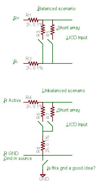

Chris,
My edit crossed your post, basically there is a flaw in my logic as the protection circuit will oscillate if I use the output DC to determine if I DC couple or not. A DC input detector will be needed, which would require an opamp due to the more sensitive input levels, adding to the complexity but not significantly.
I'll be using a microcontroller to control everthing so the more complex logic will be no problem (I have a software background).

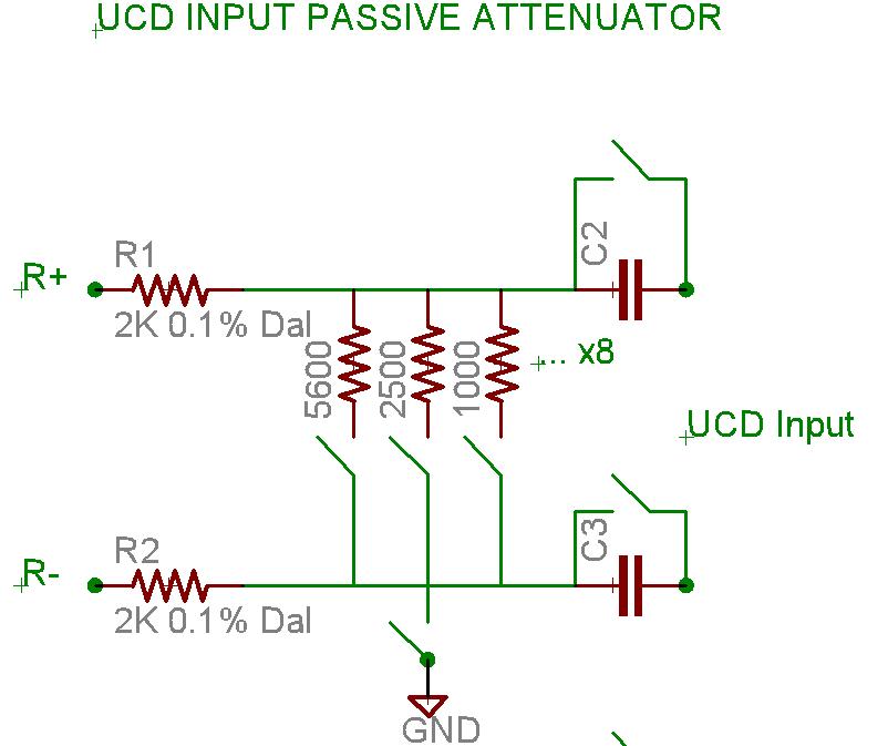

Am I correct about the volume difference between unbalanced and balanced and by adding the negative series input resistor to the ground shunt will make up for the difference? I have re-drawn the schematic if that makes it easier to read by removing the extra relay shunt to ground.
THis means for unbalanced sources, there will be no earth connection between the source earth and the amp earth except at the UCD input. Which may be a problem if there is a significant earth differential (the source is a SMPS in a PC, and the amp is on a dedicated mains circuit) or is this it a good thing not to tie the source earth & the amp earth together? I could add another relay (!) that shorts the negative UCD input to the start earth.
(edited to include image)
Dean

Roger,
See my post just posted (crossed your post).
I want to bypass all caps in the input chain where possible, although my high end sources will only be balanced. You are correct, the DC input detection will need to be separate to the output DC protection to protect from UCD failure.
Its more complex but the ability to bypass DC coupling caps and still have versatility to connect different sources will be worth it.
Hopefully the sonic signature of relay contacts is less than an Auricap!:D
Dean

Hi Dean,
Actually I had the assumption you were thinking of detecting the DC at the input of the module from the very start . Depending what you MCU you use perhaps you can find one with an A/D converter to sense it with? Yeah it gets complicated alright... Seems it would only really be worth it if you could incorporate all the control through software.
I'd thought of using an MCU with mine for something else but I have to ask myself do I really want the noise of a clock signal in there?
I like Roger's idea... unless you want to produce them for the DIY market .... a switch is hard to beat.
You're dead on about the 6dB difference. From what I'm picturing if I understand this, I dont' think it would make up the difference so much as load the input down since it would be in parallel with the 100K input resistor of the module? But I'm not sure I follow that part at this time.
Chris,
Yes, the MCU I have has an A/D, so that part is easy.
I'm not sure about the analog side of things, I have redrawn the 2 scenarios, balanced and unbalanced. I dont think this is workable, as the extra resistance in the shunt will not allow for sufficient attenuation and I'm not sure about the grounding in the unbalanced scenario, if it is OK to connect the source ground at the input of the UCD and not to the star gnd.
If I go back to the original posted schematic, which had for the unbalanced scenario a shunt to the star ground, then the 2K negative lead resistor will be in series between the source gnd and the amp gnd - should be OK?
Dean

Thanks for your help guys, appreciated.
I can use the MCU to compensate for the 6db level difference between unbalanced & balanced when attenuating.
Might be easier to use a line driver like DRV134 to convert unbalanced to balanced. The driver will add noise/distortion but unbalanced sources are not best quality anyway.
I'll breadboard both scenarios to try the theory out in practice. What is interesting about analog is with simple circuits there are still a lot of considerations to be had. With digital it either works 100% or it doesnt (most of the time) :D
