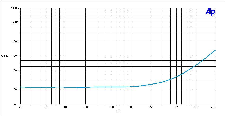

damping factor
Hey, I was just wondering what the damping factor on these modules is. thanks.
Watch the impedance by 10kHz (still 0.065 ohm.....😀)
Jan-Peter

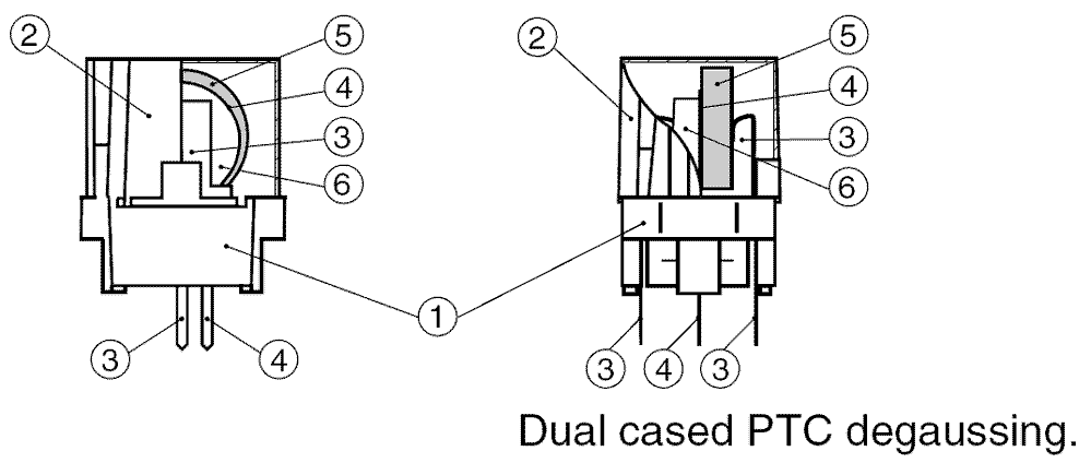

Yves Smolders Has anyone considered a polyfuse and resistor combo for softstarting large transformers?
Yes i do. I take NTC from the ATX SMPS (no marked just a 2 pin green tablet, intensive soldering efforts help you to clean green compound&pins) and put this into the PTC_for_Degaussing_TV (3 pin black box with two tablet inside, as a heater one, and other is a PTC as switcher) instead the PTC tablet. Resume -very neat 3 pin softstart device. So when we turning ON the trafo, then NTC are cold and have 5ohm resistance, over 10 sec NTC come warmer and .3Ohm now. But i'll try to buy 10-20Ohm NTC for this purpose, because trafo primary have 2.5Ohm, and how much effectively it will work, i don't know so far.
