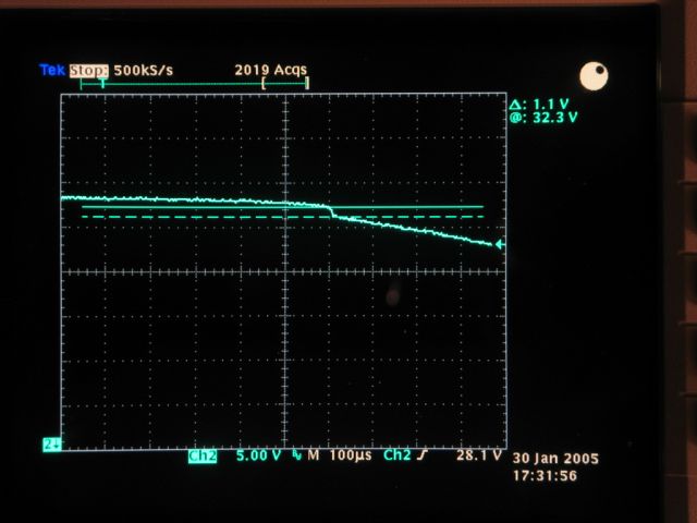

Roger,
I never stopped to think about the situation when the diode goes reverse voltage and stops conducting. The energy stored in the leakage inductance has to go some where.
So this is the reason behind this waveform?! It's already for a while that I was trying to find the mechanism behind it! Now you enlightened me, thanks!
On the scopescreen there is visible the rectifier anode / transformer seondary node, at the moment of cutting off. The sinus is de-capped because of the voltage drop caused by the charge current on the secondary impedances [hm, suppose so..]
If I get it well this time, then the glitch visible in the moment of cutoff is because: the cathode tension is fixed by a low dynamic impedance at this moment [reservoir cap]. The diode is closing, so do not provide a path for the energy stored in the leakage inductance; so there develops that inductive back-voltage step [Lenz's Law] on the rectifier anode. This step sits on top of the [original] sinusoidal EMF induced in the transformer secondary.
This has nothing to do with reverse recovery currents; this happens with each type of rectifier.
Thanks, Roger, really!

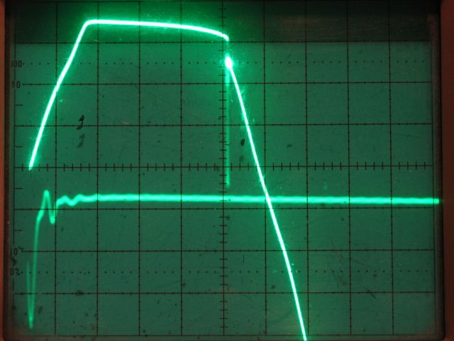

Snap back spike.
Joseph K said:
And this is what it looks like when there is also reverse recovery snap:
Ciao, George
George,
Really nasty stuff! Lots of HF components in it and can couple into other circuits easily. Sounds like a line freq buzz but is very misleading as it is really almost all HF. A proper snubber will almost entirely cure this but instead of a voltage spike you now have created a current spike. This can also radiate into nearby stuff so you have to keep the leads short or at least twisted together. Remember the current path includes the transformer and its lead wires. Like Bruno says, “it’s in the details”.
Roger
