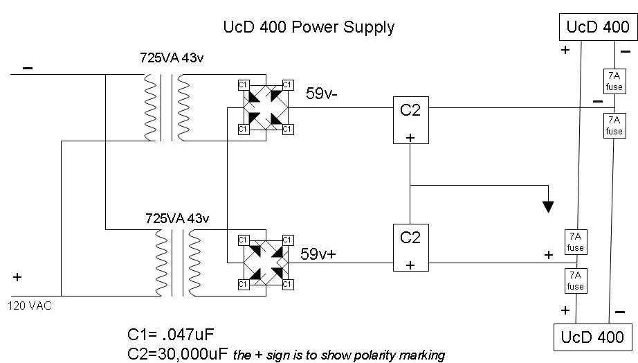

So I bypassed the overvoltage protection (thanks for the info Jan-Peter) and luckily, that (as far as I can tell) was all I damaged on the modules.
However, when I power them up I had the same problem as before- the positive rail voltage went up while the negative went down. Before, I figured it was just bad caps- but I wanted to check before I went out and bought new ones. What causes this? I'm not an engineer and this is my first project- so I have the feeling I am doing something wrong.
From the rectifiers, I am getting steady 59.5-59.7 volts DC on both rails with no load. The transformers are staying within .1v AC of each other. The positive rail's cap has the rail connected to the terminal labled + on the cap and the ground on the other terminal. On the negative rail, the ground is connected to the + terminal.
Both of the caps are on an alumunum shelf directly above the transformers. Would the proximity to the transformers do this? Unfortunately, the caps are huge (7"high x 3"dia each) and the transformers are huge (6.5"dia by 3.5"high each) and I don't have much room to move them within the 1cubic foot enclosure I built.
I will eventually be buying better caps, but I just want to check to make sure I am doing everything right first.
Thanks,
Larry
Thanks,
Larry

power supply
line937s
You are using 2 transformers and one bridge rectifier right? This means you have to connect the transformers outputs together in some way, probably series right? Did you also connect this tie point between the transformers to the ground connection between the 2 caps? It sounds like you have a floating ground.
Sure would be nice to have a simple drawing of what you did. I really wished there were a share ware or free program to convert schematic drawings to jpeg or bit maps. Would be so nice to do a simple drawing and post it to show what I mean. Guess I can freehand one and scan it.
Roger
line937s
Roger

I hope this picture works- this is the first time I've tried to post a picture. I think this gives a better explanation of what I've done- sorry if I used any of the wrong symbols (I made it in Powerpoint). The rectifiers are just heavy duty potted type, bypassed by .047uF film capacitors. I left out the circuit breaker, power switch and soft start (just a momentary switch in series with some resistors bypassing the power switch), but I didn't think they would cause this problem.
Thanks to everyone for their recommended fixes- I am really anxious to get this working so that I can get to listen to what everyone has been raving about.
Thanks again,
Larry

lne937s said:I hope this picture works- this is the first time I've tried to post a picture. I think this gives a better explanation of what I've done- sorry if I used any of the wrong symbols (I made it in Powerpoint). The rectifiers are just heavy duty potted type, bypassed by .047uF film capacitors. I left out the circuit breaker, power switch and soft start (just a momentary switch in series with some resistors bypassing the power switch), but I didn't think they would cause this problem.

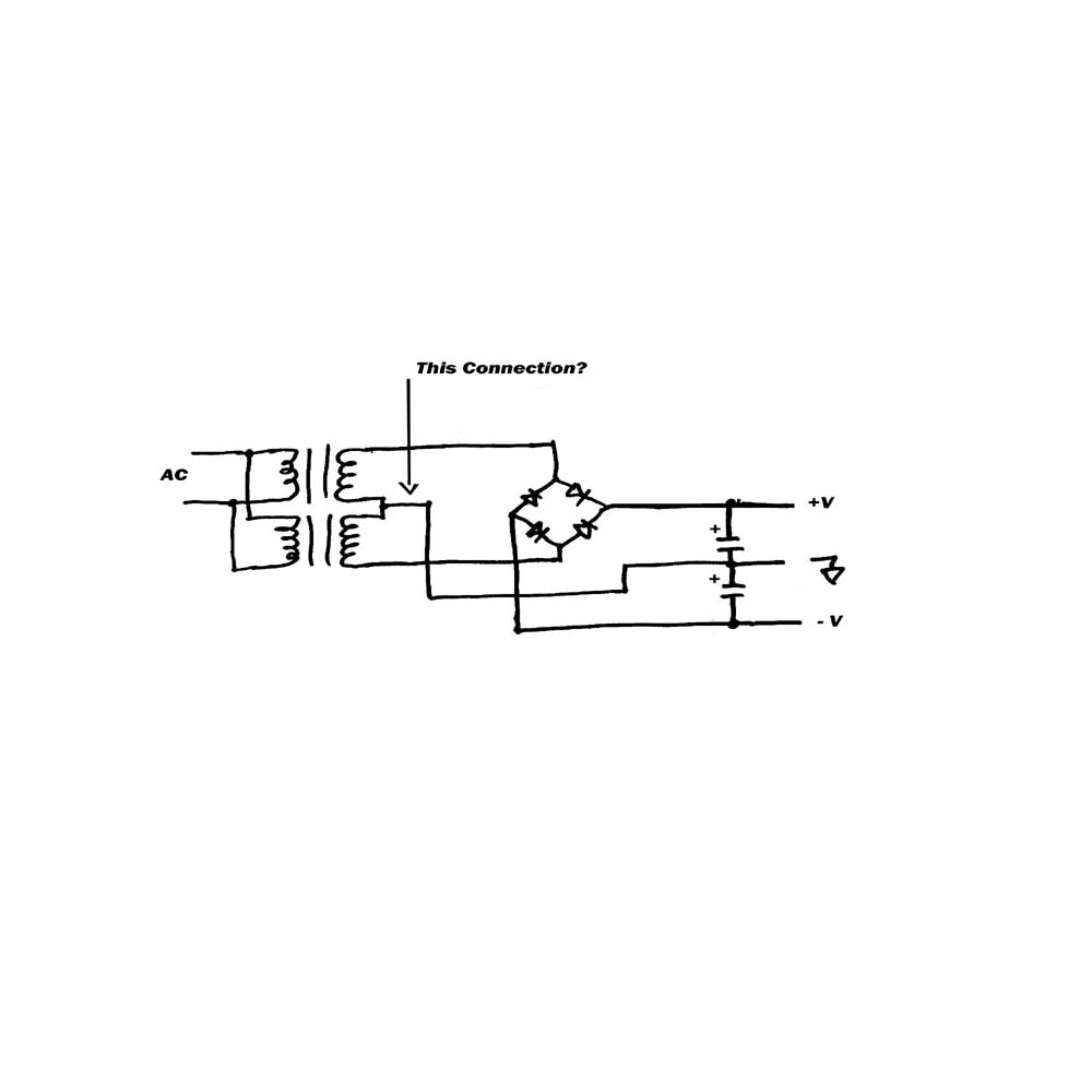

lne937s, look at sx881663 last posted picture (circuit), I believe you are missing the ground from the transformer secondaries to the caps through to the ucd's.

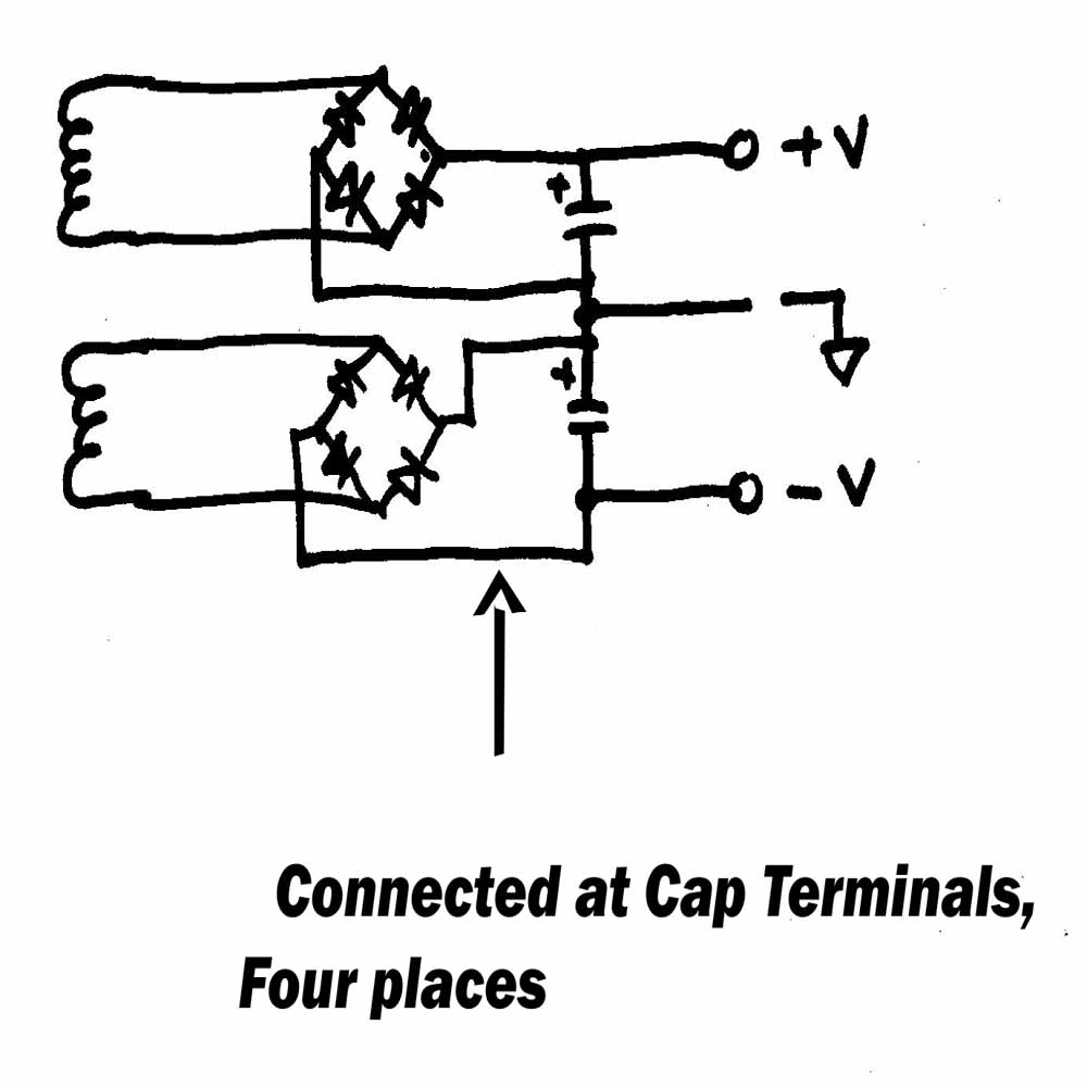

Floating ground
lne937s
Connect the 2 points where the diode bridges are connected together to the common tie point between the caps and you have it fixed! To do it right the +/- of the bridges should be connected to the caps +/- terminals so the transformer charging current doesn't contaminate the common ground.
Like below.
Roger
lne937s
Like below.
Roger
lne937s said:Roger/Chris
That makes sense- I'll fix it this weekend. I am realizing how little I know, but how much I've learned from doing this project and reading through this site.
I guess a picture really is worth a thousand words...
Thanks,
Larry
