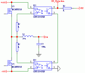

in class D amplifiers DC failure sensing is very easy to implement. All you have to watch is switching action of output stage. If you don't have change in polarity for some miliseconds (to count in for some heavy clipping), then you can safely trigger DC protection.

But that only works when the output is clipping, if for some reason you have like 40V DC at the output, for example due to DC at the input and having removed the DC blocking cap, then 10A DC will flow in the case of 4Ohm speakers which will probably fry the woofers. On the other hand, it is an interesting method to detect clipping.

picture shows what I had in mind. By using slow optocouplers with 15us turn off time, both optocouplers are conducting while amplifier switches. When one Mosfet is on for more than 15us (due to the failure or clipping), one optocoupler turns off and logic signal DC_Protection goes high. But you are right about coupling caps. If you remove them, think about the consequences. I think they are originally designed in for a reason.

Hi Jaka,
Looks nice, this would also trigger on clipping, which maybe a desired or undesired side effect. Do you plan to build this?
