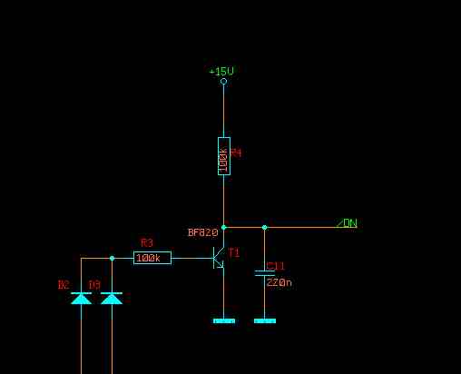

Originally posted by Giorgio;
probably this has been already covered but I can't find the post , it's about turning off the ucd400.
a)I have pemanently the on connected to ground so I use only the main switch and when I turn off , after 20-30 second I hear a quite disturbing noise from the woofers is this normal ?
b)Is it aviodable using a switch on the on pin?
c)and in this case leaving the main switch pemanently on do I have any kind of voltage on the drivers and can I turn off the preamp and all the sources without problem?
d) Jan Peter when will be available your power supply?
The best is to use an AC-detection and to switch the amp off when there is no AC anymore. You could use the schematic in the attachment.
On the two anodes you connect the AC of your transformer, any NPN transistor will be ok with an Hfe of >100.
Happy with the sonic performance on your horn systems?
Jan-Peter
