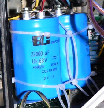

Interesting about the difference in BCC caps...
Can anyone tell me what type these BCC are?
I've bought them locally, but don't know the type, they are pretty large cans for 22.000uF
This is the print:
BC Components
22.000uF
Ur 63V
40/085/56
IEC 384-4
2222 154 18223 <<< I suppose it's 154 series? Right?

The 2 I have were new I believe, my dealer ordered them. He had older models (same type he said) but were much larger, maybe an older batch... (they looked like the Rifa's, like half litre beercans)
154 should sound good but my transformer is too small for the moment (old one I recovered somewhere...)
