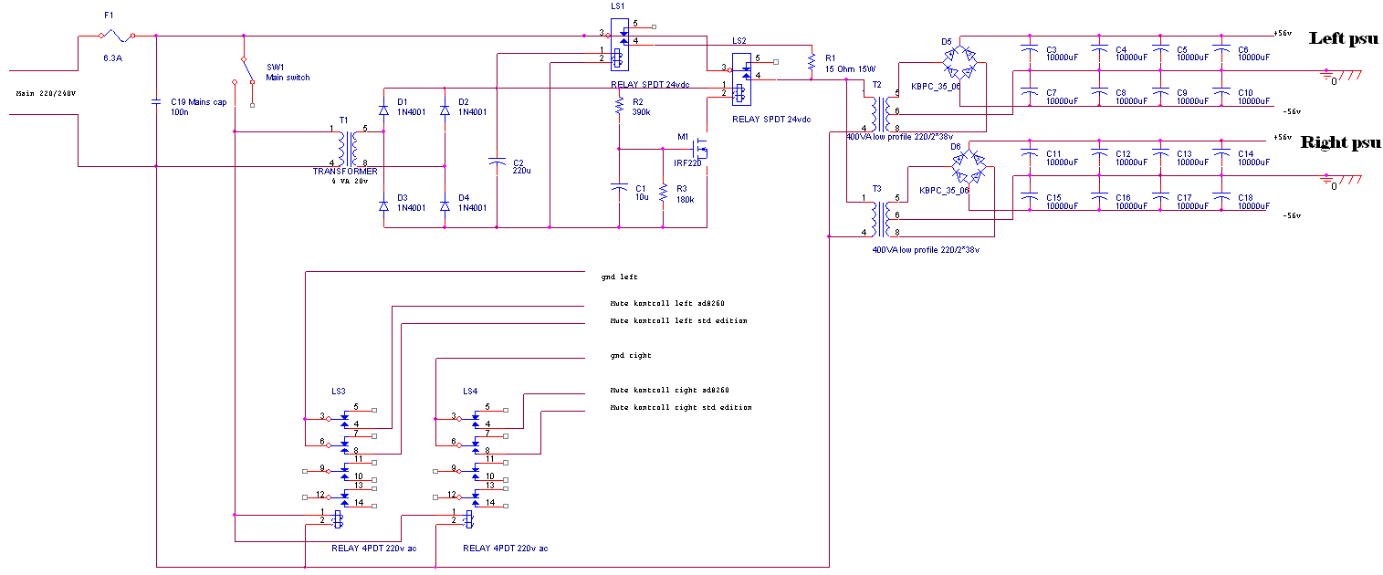

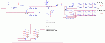

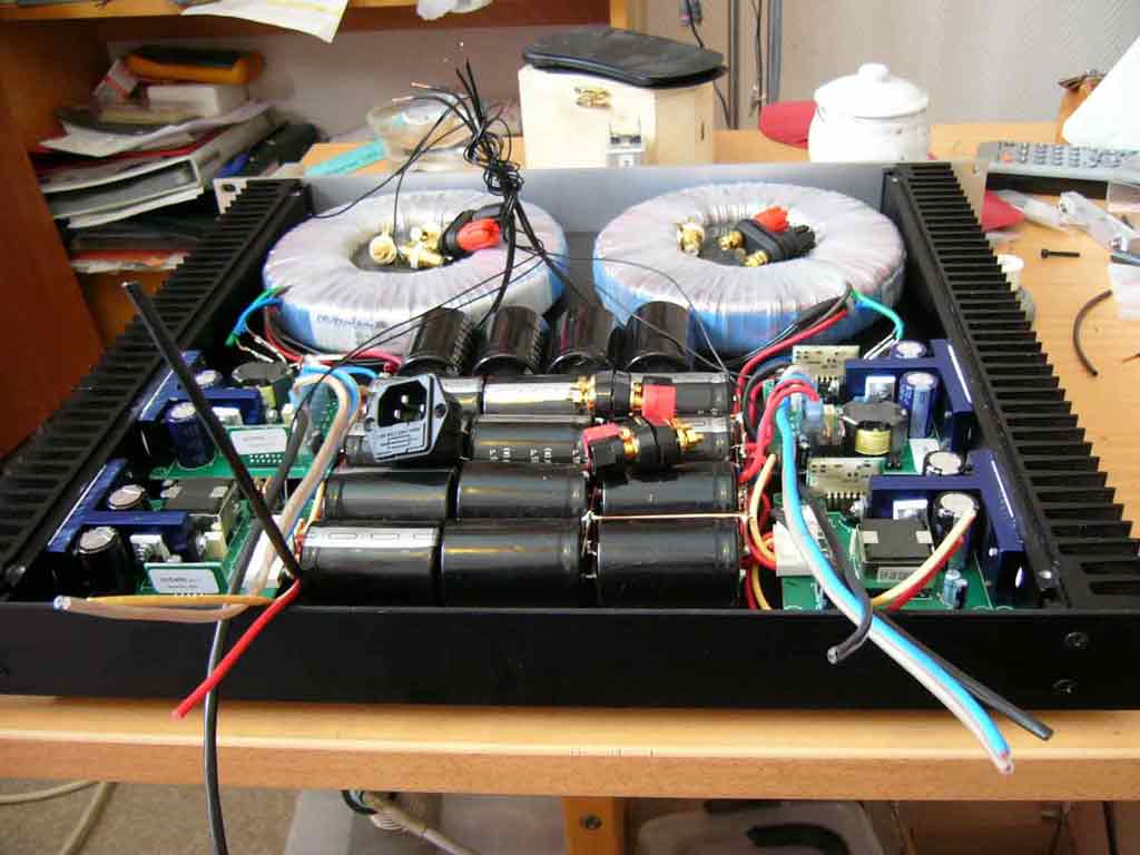

4 UCD 400 is powered by this psu with slowstart and mute.
2 Transformers 400VA, 160 000uF all in 1U cab

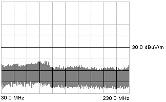

when testing the UCD 400 power amp. with a FM Tuner on I hear interference with certain stations. While the tuner(Sony with 2 antenna inputs, quite new) is on a cable antenna system, so there is a strong signal, another tuner(older 1 with air cap.tuner) has no problem at all. Seems the modern 1 has more trouble with EMI from the amp. than the old one. BTW the amp. is build in an Allu. case so there should be enough shielding. I mean, where does the EMI come from to disturb the tuners reception?
well before the output filter there is a pwm carrier signal at (i believe) ~450khz. Despite hypex being very careful in creating a pcb that radiates as little emi as possible, some tuners are pretty sensitive to this stuff.

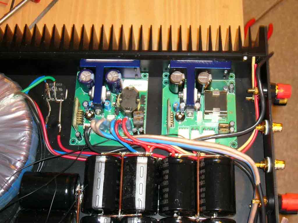

Seems like a mixture of old and new modules. Any problem?
Its the old normal ucd 400 rev 1 driver board, and ad8260 rev 2. No ploblem at all. Only one comment to the supplyed signal wires, the soldering for the mute wire i had to redo as 3 where no good.
Psu is as posted in post #742
