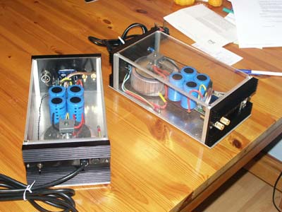

Hi All,
The challenge (and the fun) is the building of something that gives you the best possible sound without breaking the bank.
In my humble opinion, this makes a DIY project a personal(ised) thing and you can use whatever you feel comfy with.
I went and built everything, including the chassis from scratch, and it took a lot of metalworking, tapping and routing sheets of perspex with different routing bits to get where I imagined it needed to be. Judge for yourself if this would pass muster in your home, but again, it depends how far you want to go....

No matter how far you do in the DIY route, it's good to make a start.
OK, I eventually built my amp out of hypex stuff all-the-way, but I did put together my own simple PS to test the modules first.
Having done that, I've learnt how bridge rectifiers work, how to make "flat" DC out of pulsing DC, and refreshed a lot of basic electrics/electronics on the way.
And beyond that, from a commercial point of view (not calculating time spent building the stuff) I now have a great sounding rig at just a fraction of the cost just buying something off the shelf.
And yes, maybe for my next project I'd go a bit further, who knows - I know one thing, and that is by checking this forum I have learnt a lot, stuff I couldn't have learnt by simply starting to put the parts together. I do believe my next steps will be to learn to solder properly, and start modifying audio stuff to make it better - for my that's DIY also.
I have no need to invent my own Class D or anything - I'm already happy to have insight in audio electronics now, who knows where I'll go from here...

I finished my first DIY amp last weekend using UCD 180s. It's a four channel for and active system. You can have a look here.
I stuffed it into a sideway mid tower PC chassis.
