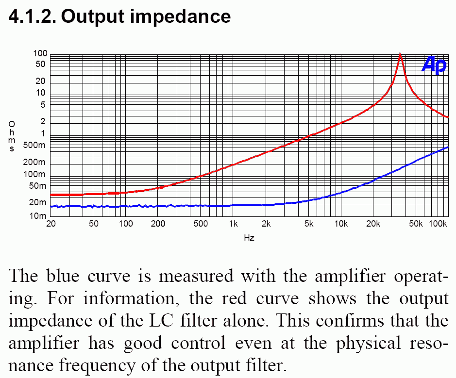

CIAudio has repeatedly stated that he sent it out with the current limiting wrongly set--it was not a Hypex issue.
I'm not the kind of guy that would think "Hey, one guy's amp is acting up, all the modules must be sh*t" - 'cause I have the modules, and they're doing exactly what they should.
I wonder... current limiting, changing that would require lots of mods on the module....
The Audiocircle articles mention that the current limiting was influenced by temperature.
Could it be that there was some kind of thermistor used as soft-start and it just kept limiting current?
It could explain the "bad comments" in the stereophile article, all that was commented on was bass (high energy) content that didn't sound right. I'm sure it wouldn't sound right when clipping, lol! 😀
If that was the issue, then no apparent flaws were found in the modules at all 😱 😀

Thanks for the link to Audiocircle where CIAudio takes the blame.
After reading about the UcD technology I was expecting great results and was therefore very disappointed by the first set of measurements. The second set however shows that UcD is the best class-D design out there.
